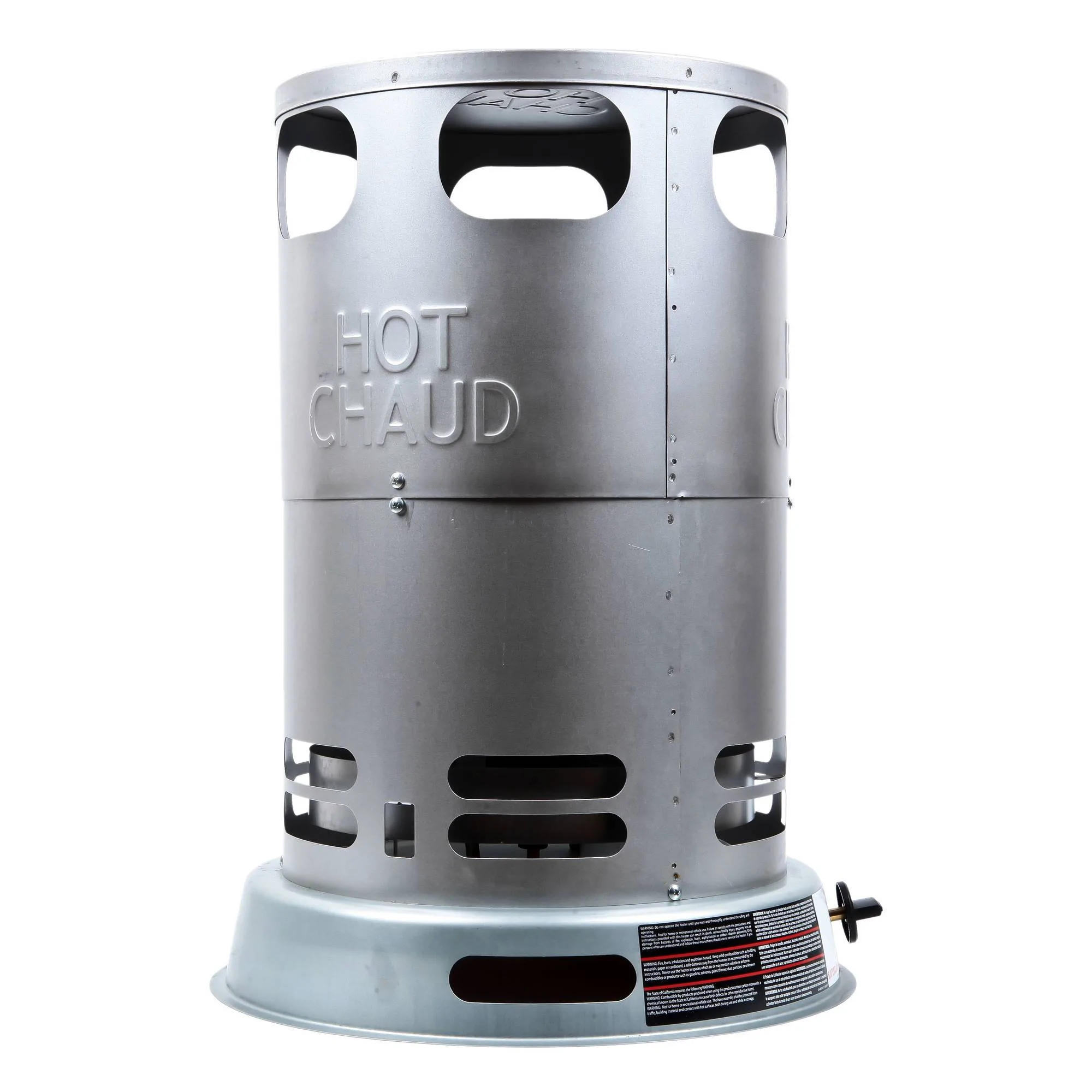

I have one similar to the one below. We use to use it all winter long for heating up the garages on the houses we were painting every winter back east. Just crack a window or door and fire it up and it'll warm up the garage in a few minutes. Now the lower ground area will still be cold (heat rises) but it's manageable to work in there. **Again make sure you vent the fumes and have a door or window open.
https://www.northerntool.com/shop/tools/product_200930934_200930934
I don't think I am gonna allow Hot Chad into my garage!

but what if i want the fumes hmmmm?
ive looked into them but until my garage has less oil on the floors its prob best to not have something like that in the garage haha
