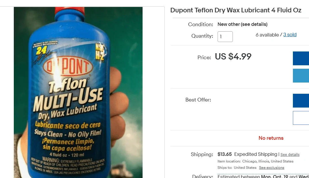

Hi gentlemen new to your form I have a 2019 ranger SXT FX4 mine had the same chirp it drove me crazy I used Teflon spray to quiet mine down it's colorless and it doesn't attract dirt and bust.
Dupont Teflon Multi-use Dry wax Lubricant

Thanks for the tip. It was sure hard to find this product, I had to go to ebay. None of my local shops carry it.

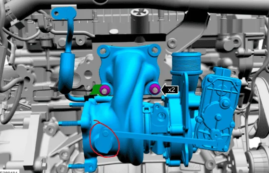

I know this is an old thread, but I had the same issue on my 2020 Ranger that I was able to fix (for now) with some Teflon lube. The place to lube is the linkage under the Turbo heat shield (circled in red).

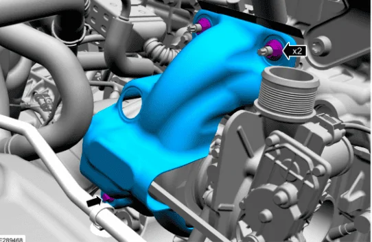

As many have noted, it's not possible to reach without a spray. Alternatively, you can remove the heat shield if you really want to get in there. It's held on by 3 bolts.
I'm guessing the lube will burn off pretty quickly though given the high heat though. My initial go at it was with regular WD40, but that went up in smoke within minutes...
