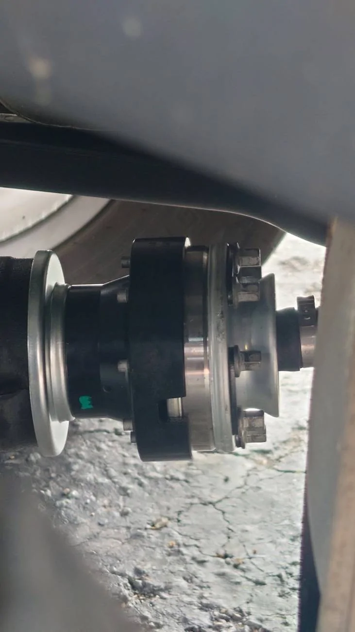

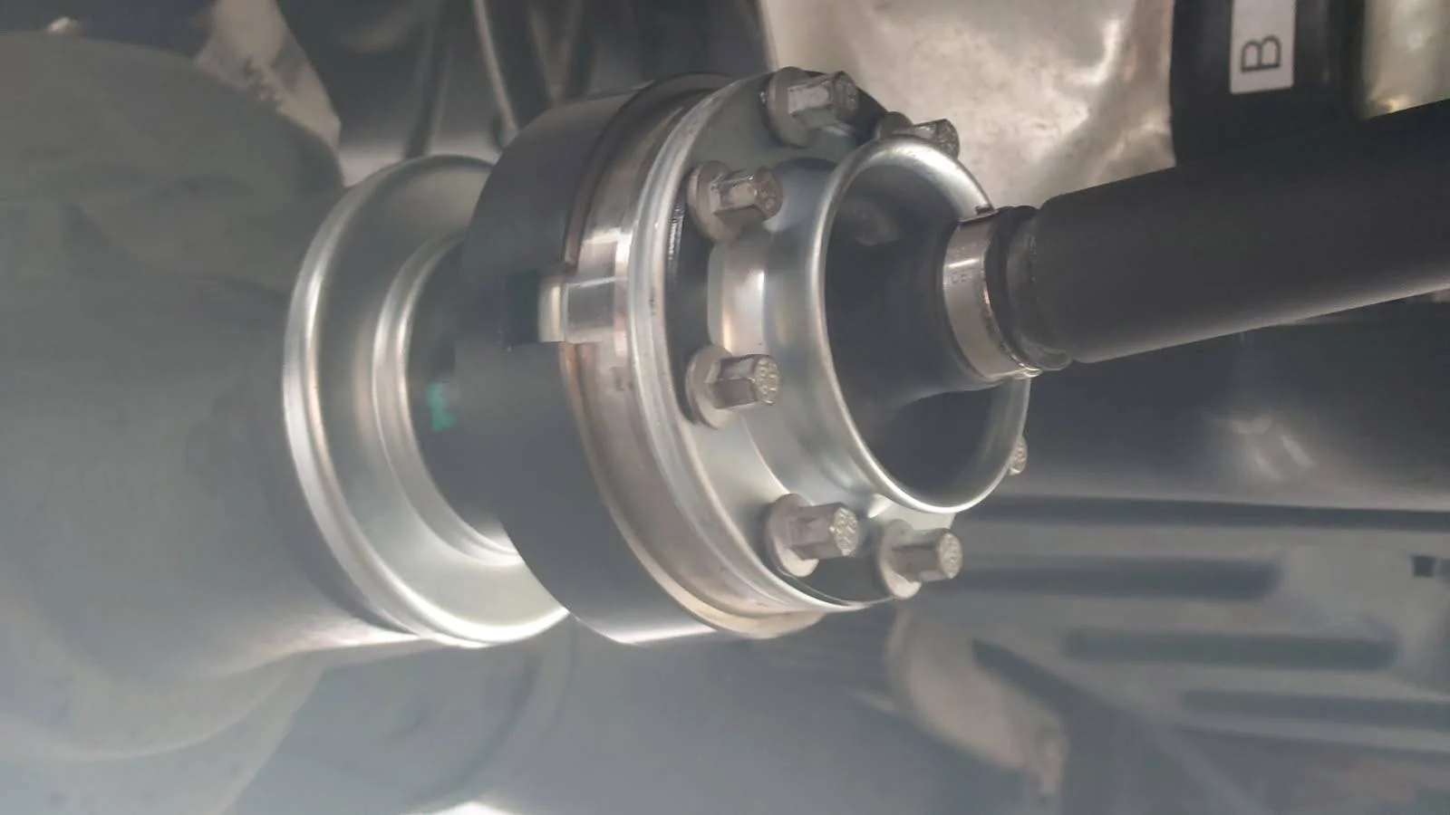

Well an update for ya all...
Dropped my '20 XLT off for my annual oil change, at only 14k miles and asked that changing the oil is all it needs. I take care of the rest. Unless something major is needed.
I said oh by the way... it has a wiggle when starting out of a stop. The SA asked does it do it now and can we replicate it? We drove around the building and sure enough, the wiggles.
He said I will look into it as the 5 year warranty expires in November. An hour or so later after the drivetrain guy looked at it, he said yep there is a problem, and a TSB about the driveshaft/flanges. So there are now new & different drive shafts to replace them. They'll get parts and fix the problem. SA said should be a lot smoother with the new setup. Pretty happy, was just about to get a Tom Woods Driveshaft. Looks like I am getting more than that.
1pt21gw
1pt21gw
Nov 25, 2020
635
2,072
West Coast
'20 IS XLT SC / '22 OW BBB 2Dr
Ye' Ole Traveler
And the results.
adding this is TCB 23-2251.
