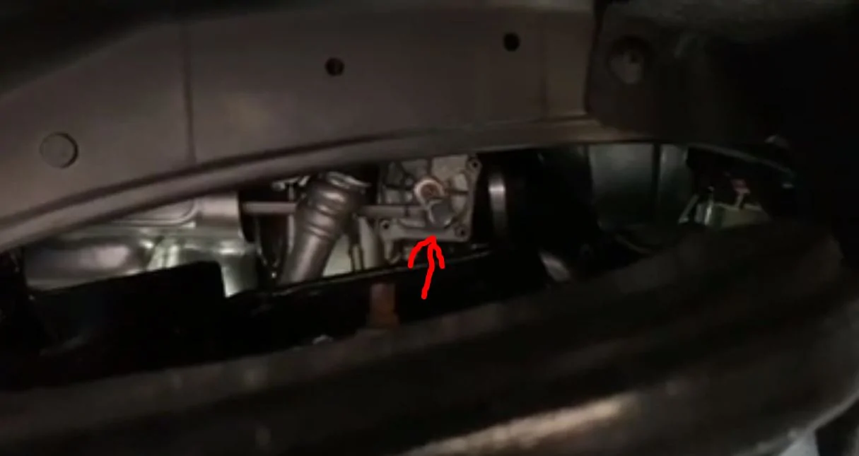

I noticed a chirp sound coming from my ranger. I took a video of the part that is making the noise and I have two questions.
Is this chirp sound normal - means all new rangers have this?
What exactly is making the noise? I see the lever moving back and forth when I hear the sound, but I'm not sure what that is. Here is a picture, and the link to the video.

I took mine to the dealer and they didn't do anything about it. They said they checked and there is no recall or TSB, so live with it, even though other trucks do not make this sound when the waste-gate control actuator moves. At this point I will just live with it and see if it causes any issues. We have 36k or 3 years so I'm not going to worry about right now. That said, before my warranty gets close to running out, I'll try again.
Truck runs great so I cannot see that it's impacting engine performance. Just hate that my new truck sounds like belt slipping or birds under my hood LOL

I first noticed it after I remote started my truck to warm it up and I was standing outside talking on my phone. I notice what I thought at the time was a belt slip. I then realized it was every time I started it cold and at the same time, I think about 1 - 2 minutes after starting. It isn't as easy to hear from inside the truck, so if you don't have remote start, you may not notice it. Look under the passenger front wheel well and watch waste-gate actuator move and see if you also hear the chirp. Mine is loud and easy to confirm. See video in first post of this thread.
I have not heard of any other turbo charged Ford truck doing this, so it may be a Ranger only thing.

Yep, mine does it also. It's only while it's warming up, prior to the fan shifting down from "airplane about to take off" mode. It bothered me at first but I have gotten used to it.

The question is - should Ford replace this part because it should not be making that sound, or not? Time will tell....
