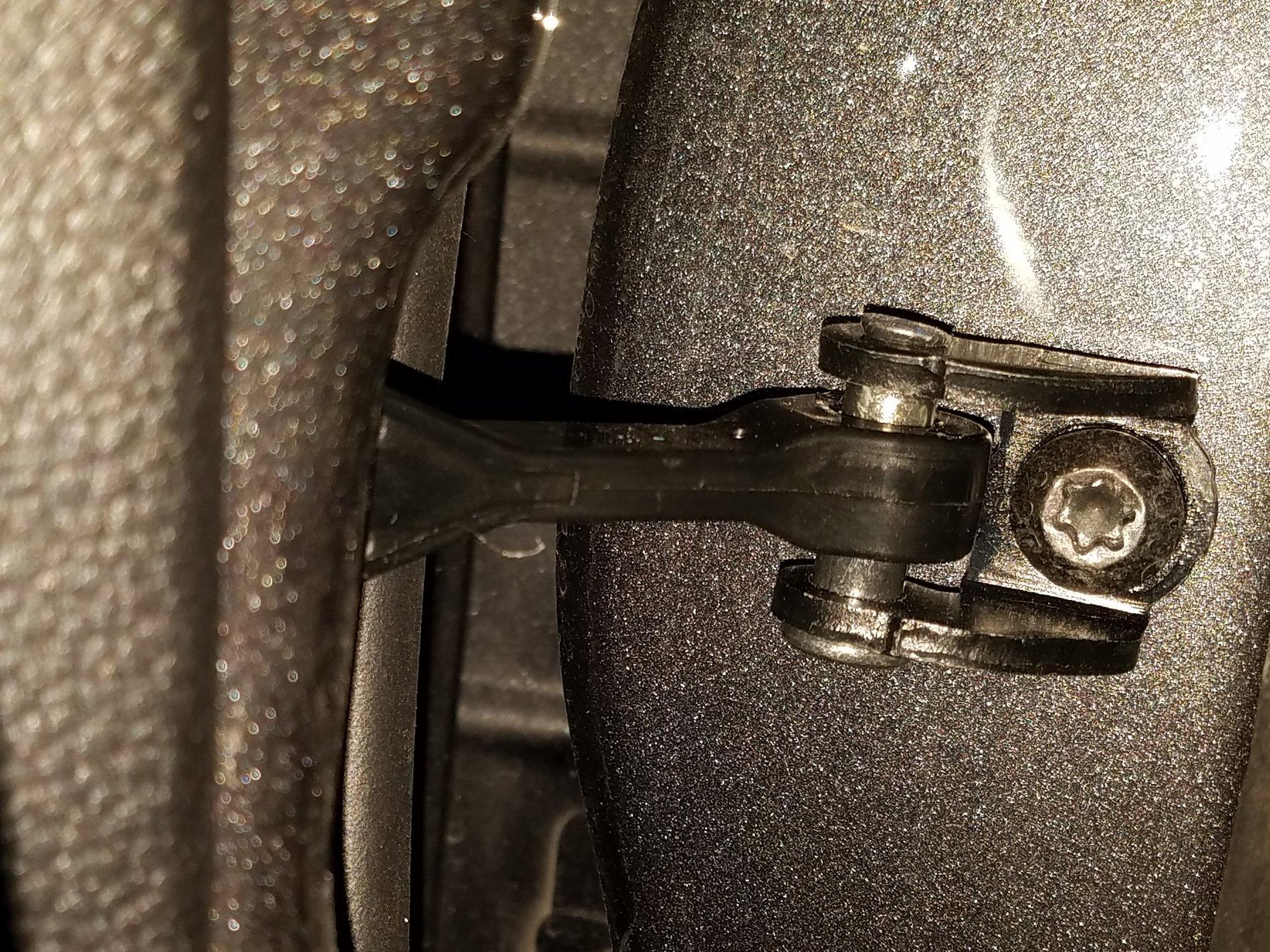

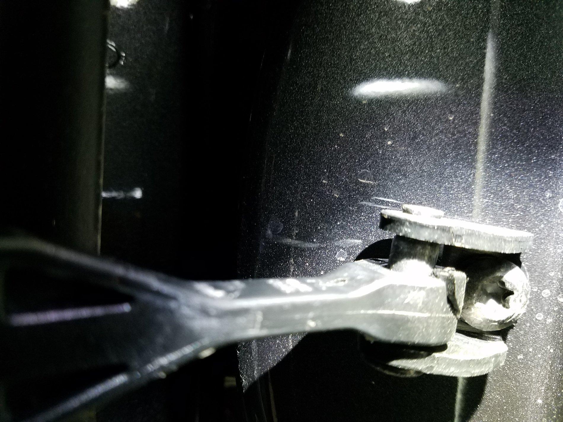

New door check... doesn't look like its any different
