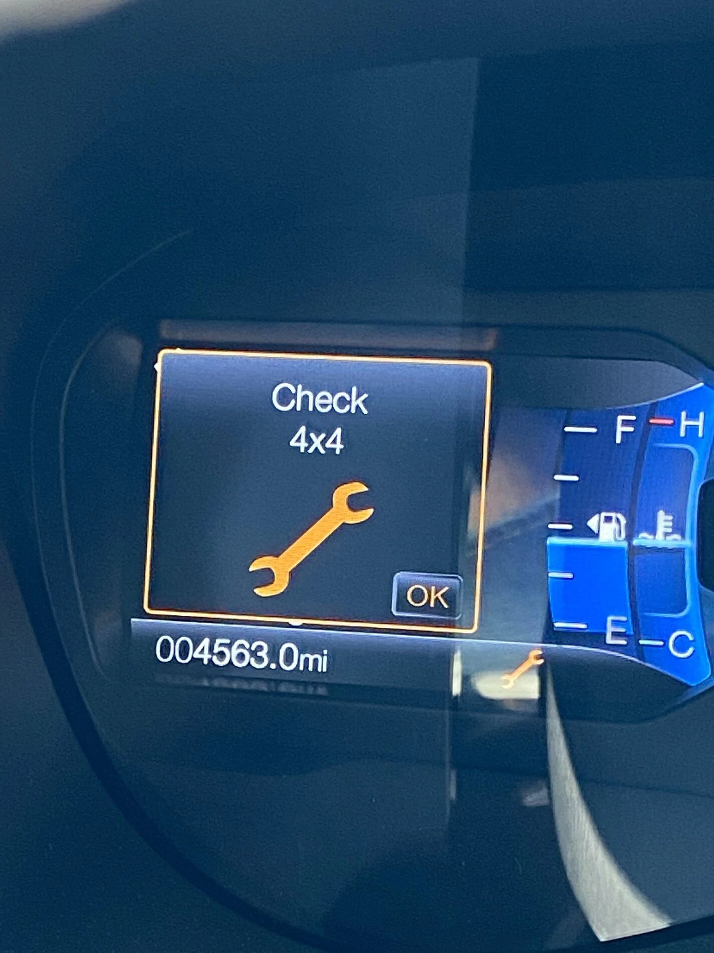

This has happened twice in as many days, only once and if I pull over and shut truck off and restart all’s good! Truck has 4700 miles on it and only been in 4wd twice back in winter! Anyone else have this pop up?

Any update on what you did or what a dealer found with this warning? I had my 2019 do the same thing today.

My 2021 just did this. I turned the engine off, restarted it, and the light went off. If it does it again this Rangder will be down the road. 7794 miles on it,

The electrics are so involved in these trucks it's probably a fault code that was triggered by a fluke. Once cleared it won't come back. The dealer can tell by the code if it's an indication of a hardware problem.

My 19 did this today. Happened on a long hill shifting from 10th to 9th. Turned off and back on and it cleared.

Have you tried to put in 4WD? and if so what happens?

It might not be disengaging from 4H fully Try unlocking the hubs the old school way:
  • Put it 4H, drive straight for ~60ft = 8-10 revolutions of the wheels (this can be done on dry pavement if the wheels are kept straight).
  • Stop, shift to Neutral and back into 2H
  • Back up ~60 ft. Hubs should now be fully unlocked.
There may be some other problem with a sensor in the transfer case
