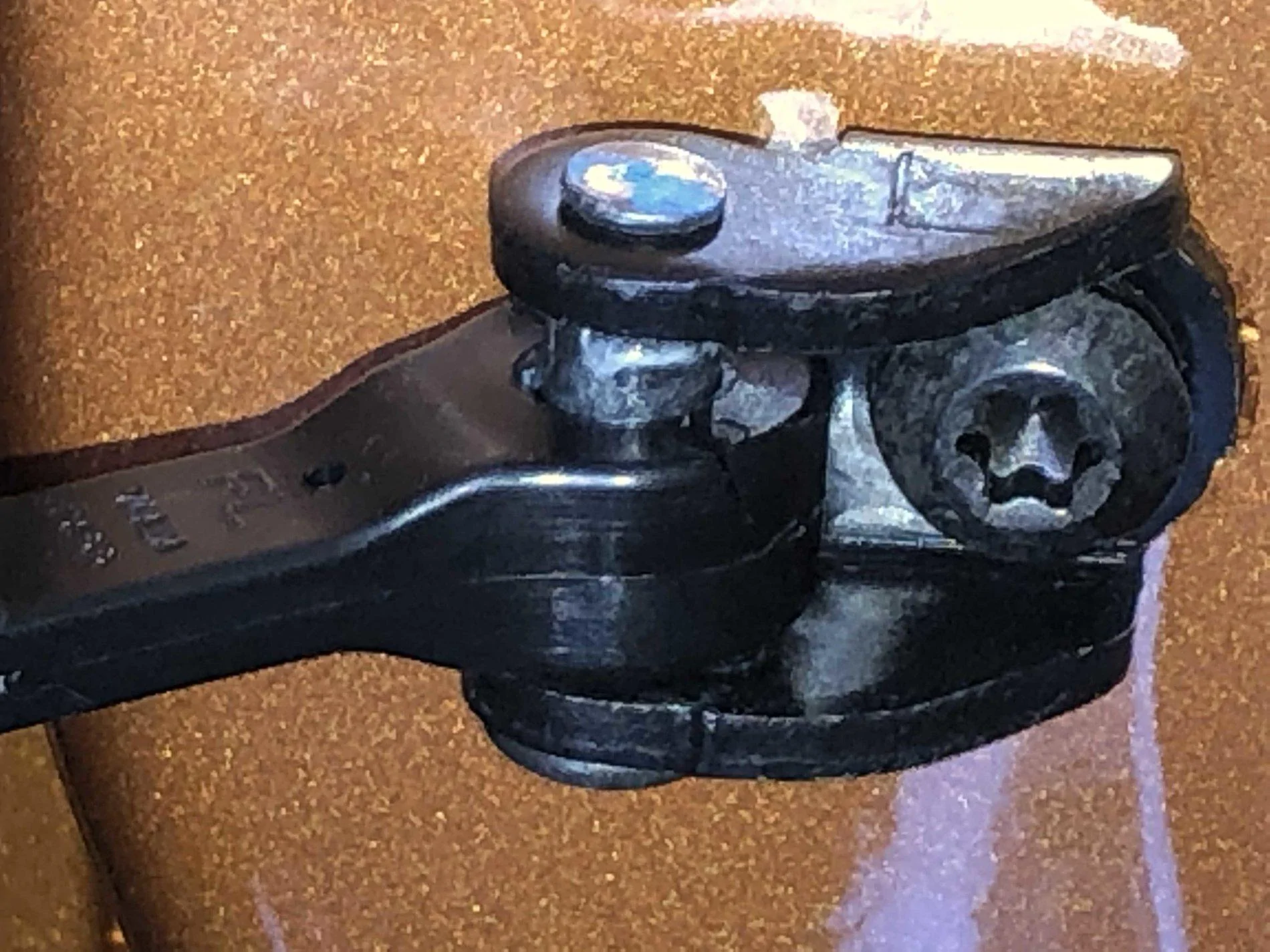

Looks like my driver's door check is already checking itself out. There's a very definite crack in the plastic that Ford is going to have to replace. Why the hell would they use plastic on this part? I'm not one who lets my door go flying open or anything like that either. I know some people with F150s have replaced theirs with an aftermarket unit that gives an additional "stop" along the path of opening the door.

Thanks man, I'll definitely check mine in the a.m. Keep us posted on what Ford says. I agree, didn't like these when I noticed Ford went this route. Don't get me wrong, I'm a Ford man through and through for years, but sometimes I just scratch my head and ask.... Why??

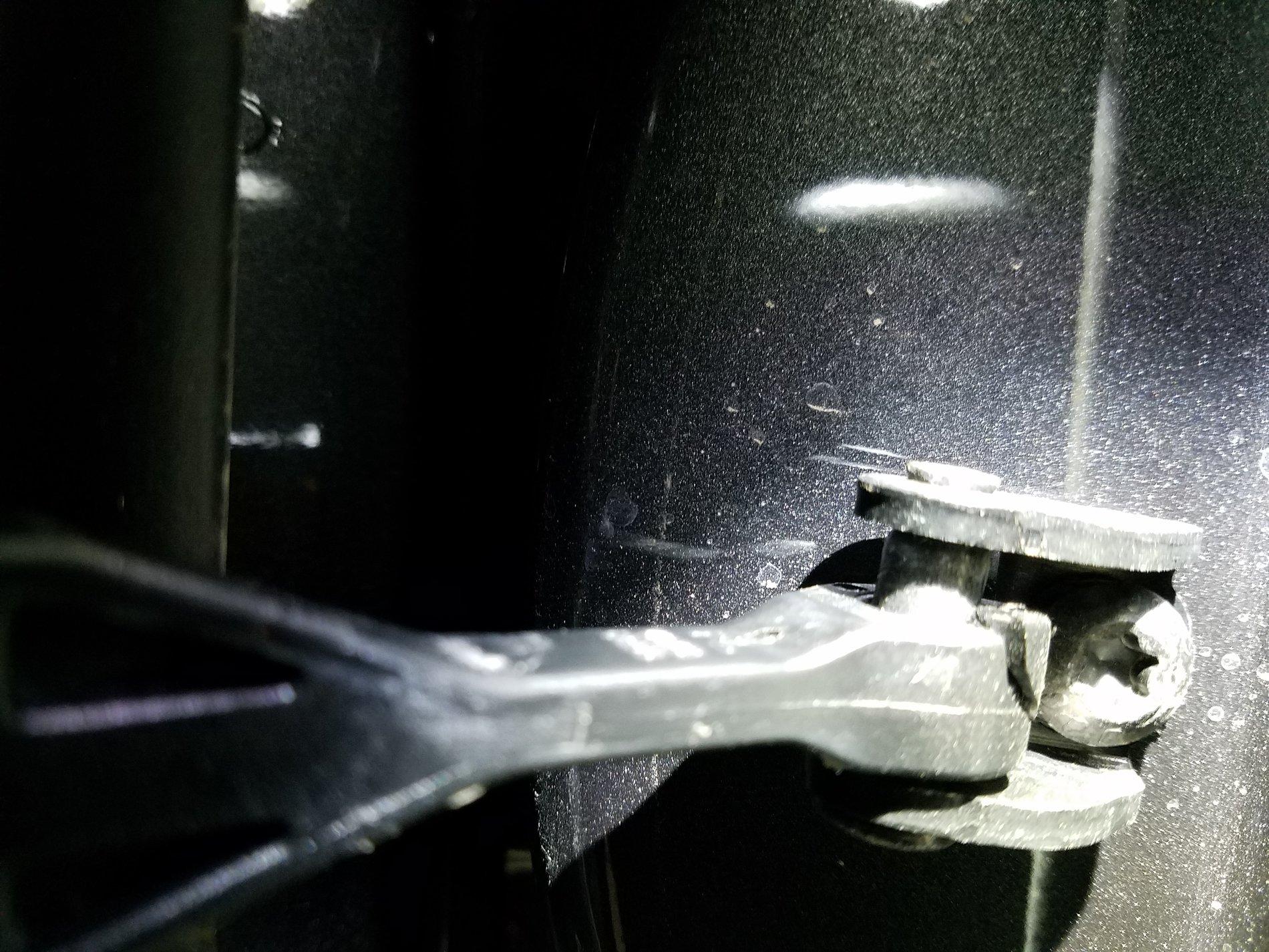

Thanks for posting this. I just checked all of mine and the drivers door is doing the same as yours and the others are good for now. Like you I never swing my door open fast,heck I only have 1,100 miles on it so maybe it was like this from delivery. Really a piss poor design using plastic!:thumbsdown:

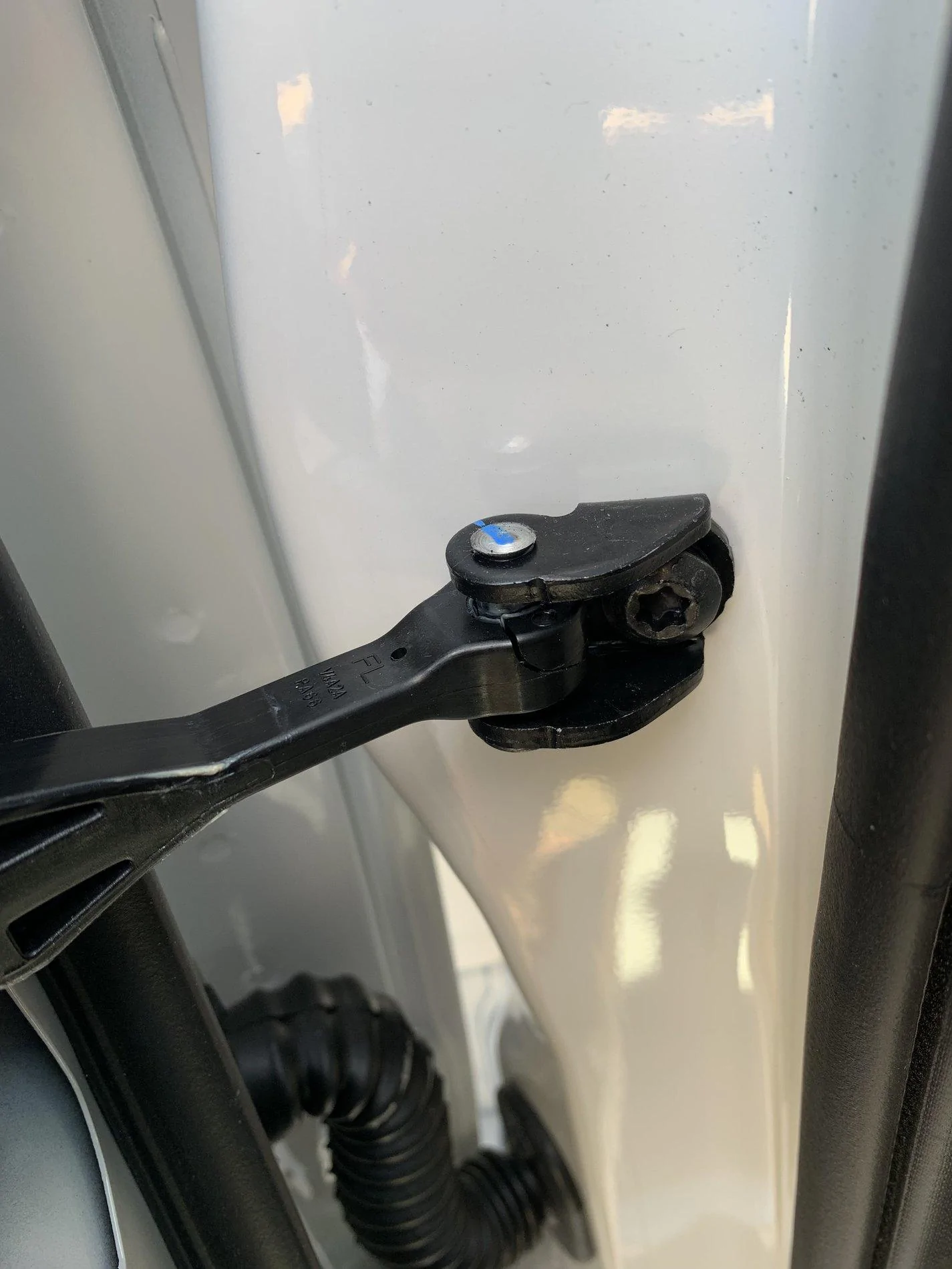

Just picked up my truck yesterday and noticed the driver door opened too far so after reading this I checked and sure enough it is broken. It was a dealer loaner car and has a little over 2K miles
