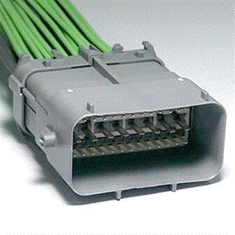

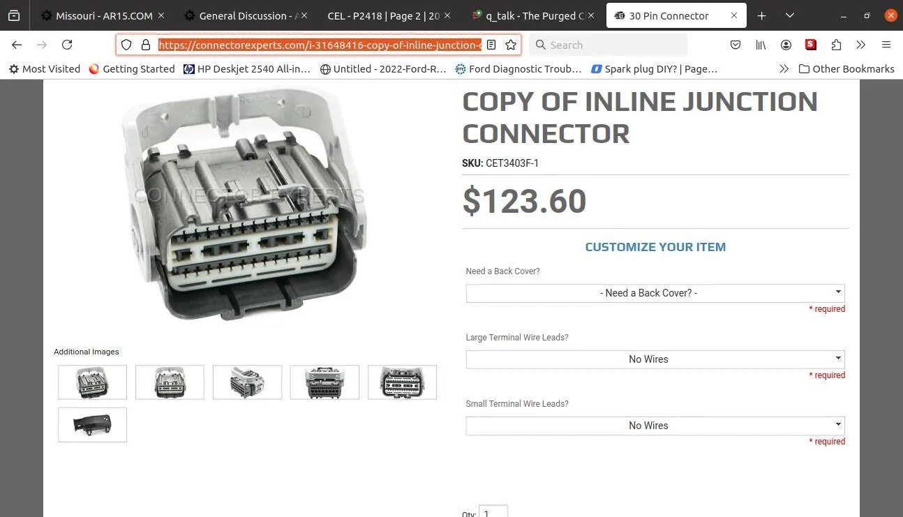

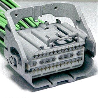

Thanks for the tag Steve. Yes, this is the exact connector. From what I can tell, I drove over a log *just* wrong and it flipped up and separated the plug. My symptoms were the engine dying and all codes related to fuel rail pressure, fuel level sending unit, etc. because the fuel tank harness was downstream. Codes cleared and the engine started back up after the harness was reconnected and I haven't had a persistent CEL since. In my case the clip holding the harness together broke and while it seems like you can simply replace the plastic body of the harness connector I haven't been able to find that part. Ford wants $800 for a new downstream harness so zip-ties it is! I also added the RCI fuel tank skid to try and protect this in the future.This area is really vulnerable when off roading as none of the skid plates protect it. Maybe someone has or can come up with an idea for some type of protection. I know @Lateknightucd had a similar issue with his connector getting broken. Not sure if he had the same specific codes as you but he did have issues.
If it becomes an issue, you can buy the connectors separately from the harness.Thanks for the tag Steve. Yes, this is the exact connector. From what I can tell, I drove over a log *just* wrong and it flipped up and separated the plug. My symptoms were the engine dying and all codes related to fuel rail pressure, fuel level sending unit, etc. because the fuel tank harness was downstream. Codes cleared and the engine started back up after the harness was reconnected and I haven't had a persistent CEL since. In my case the clip holding the harness together broke and while it seems like you can simply replace the plastic body of the harness connector I haven't been able to find that part. Ford wants $800 for a new downstream harness so zip-ties it is! I also added the RCI fuel tank skid to try and protect this in the future.
