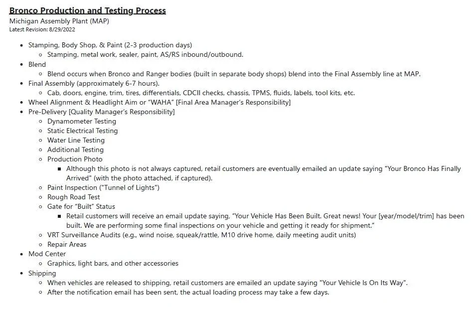

There are 2 important dates
Blend and Build
Blend = The date it was on the assembly line - being blended together with parts
Build = The date it finished the line
The Blend Date is on the - Window Sticker
So, to be clear - My Blend Date - Shows 8/16/22
However - all Ford docs in - Oasis (Fords System) show 8/17/22 as the Build Date
So, I am using 8/16/22 as my reference date due to the fact that it is unknown if the transmission was installed on 8/16 or 8/17.
Example for Bronco - Blend Date Location
Now Fords System shows - Build Date, this can be the same day or shortly after, as with mine - it's the next day - so possibly a 3rd shift finished truck
For a reference when I was curious about the - Ford Manuals, I tried the 72-Hour subscription, when you enter the VIN# through that site. You can see some detailed info; this is linked to Fords Oasis system - This is where I see 8/17/22 as my official build date.
As well as some other info
8/17/22 - Build Date
8/20/22 - Release Date (I think this is when it moved to the Rail Yard)
8/23/22 - Warranty Start Date (Being this was -Retail Order) - I think this was the date it left the Rail Yard.
I can confirm that my truck was dropped at the dealer 8/30/22 and was ready for delivery (I can pick it up) all loan paperwork etc is signed on 9/7/22.
From the Bronco Forum - Interesting Info

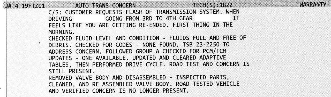

Finally did some digging and found that my blend date is 7/22/22 but build date is sometime in August 2022. The window sticker unfortunately was not kept in a safe place and adhesives from other truck PDI items ruined the sheet, so all I can confirm is August something 2022 was the final build date.
With regards to the transmission repair, I've had it in a few times for this work, but didn't get a detailed printout every time. Attached is my initial diagnosis (with MPH deleted, nobody needs to know how fast I go on a 2-lane road) and it was back one more time for the transmission overhaul. IIRC they replaced gaskets, bolts, retainers, and seals but I don't know if the CDF was replaced during that time. I'll check with the dealership when they are open to see what I can find.
Is there something that can be done to prolong the life of the CDF drum moving forward? Can't seem to find a transmission temp gauge on the dash, and only knew it was overheating when it shifted hard and threw fluid out the vent at the top of the unit. That and not being able to find the right gear were the dead giveaways.
Guess I'll have to wait for my truck to be serviced, the dealers are all backed up and loaners are rare so it's a waiting game for now.
If your blend date is in July, seems like you have a transmission from before the revised CDF drum assembly started being used in the ranger (8/16/22 and later). This sucks but at least this isn't an instance of the redesigned CDF drum doing exactly what it was redesigned to not do. (yet? hopefully never? wishful thinking? probably)
As far as preventing the CDF drum from slipping, theories have been passed around here but there is no real definitive answer (seems pretty random). Seems to me like when the 10r80 CDF bushing starts migrating the transmission is locked in a death spiral to complete failure, and will need to be rebuild or replaced.
Looks like just a valve body clean up only on this repair. If you went back after this they may have replaced the valve body. That’s what happened with my truck. I ended up having issues after that and they replaced the transmission. Mine is a 03/22 build.
