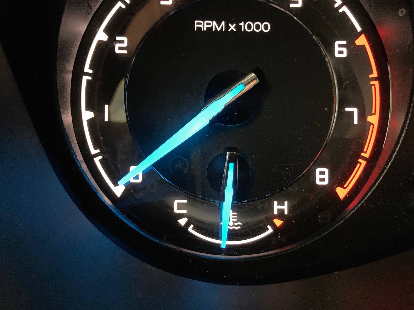

My dash gauge never fluctuates, it feels like as soon as the coolant is 100F or greater it swings to the center, and anywhere between say 100F to 230F it’s in the same spot. Can anyone confirm this or is my gauge broken?
Here’s what it looks like when it’s only been driven for 5 miles or 50 up a hill with a trailer. Zero difference

Mine looks the same. Always.

I run a Scangauge ii and monitor engine and trans temps, when the truck was pretty new I decided to pass some big rigs going up hill while towing, the power was great but I first realized the cooling system could use some work. I hit I think 240F and was shocked to see the needle moved barely past middle. Made me wonder what the heck is the 3/4 travel temp on the gauge.
I was only at that temp a few seconds really because the trans was slow to shift, was holding RPM unnecessarily and cooled fast after but was a surprise.
Going up to Brian Head, UT Towing I took the hard route and this short steep climb peaked trans temps somewhere in the 250F range and no light, I assume +260F is the trans overheating warning.
I have been wanting to upgrade the radiator since it seems the trans uses it partially for cooling too. I just have little faith in dealing with the dealership and them blaming it for an engine or trans issue. A member here works at the dealer I go to and recently said it shouldn't be an issue. I may do it for next summer.
48k miles and so far all good. At least it seems the failure is progressive and wont leave me stranded in the middle of nowhere.
