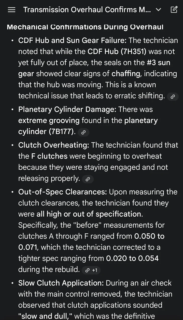

I scanned this service ticket in and this is overview AI provided.
I guess that confirms it was not in my head.

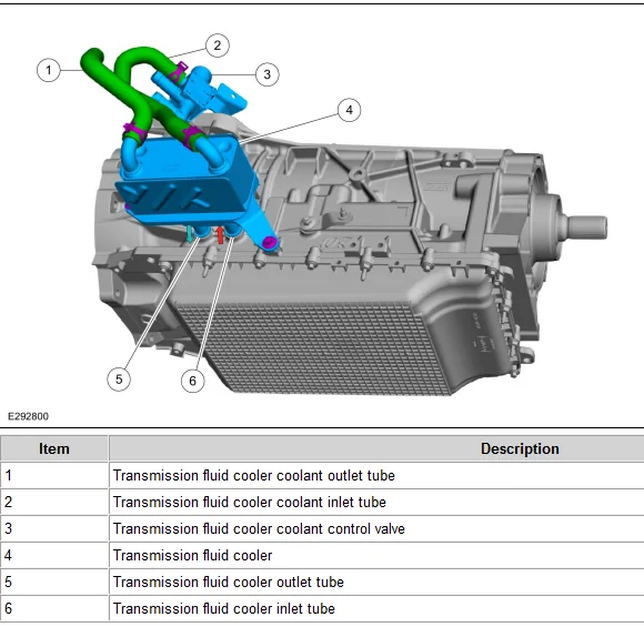

Off the top of my head. IMHO, the CDF sleeve moved due to excessive heat from the issues below. It is a skidmark, not the initial accident. If temperatures are lower, the migration issue goes away. It is why I am following GM's lead on their 10R80 cousin, and will be attempting to lower the fluid temps to 150F-160F.
Essentially the same transmission but no CDF sleeve issues. Ask yourself why.

I think the only real issue thast is of some concern is the space behind the grill. I Have not looked into that area yet, and the unknown is a bit worrying., I've pruchased 20" fo PTFE AN8 hose and enough fittings (with a few to spare in case I encouter a tight radius. PTFE won't make sharp turns without kinking. I've hose got pair guides to keep them parallel the entire route, just need to insure they are away from everything and have just enough flex at key points. most lilely only back at the transmission where it will see some slight torque movement.
Theoretically it is simple, practically, it's a little more difficult to insure a robust sound installation.
Got side tracked this week when my 2005 Ranger sprang a gas leak at the tank. Parts are on order and should be here by the 19th. Gotta fix that one first, then its oil change time for 3 cars (including the 2020 Ranger)... then it is transmission cooling mod time. Hopefully, beginning in a couple of weeks. The it is Levernois upgrade time... I picked it up due to the tranmssion remapping in the tune. I'm tired of the lugging... it heats up the transmission too much.
Since the 2005 Ranger is already in the work garage with the lift I may go ahead and change the oil in it in the next day or so. The crawl under and scratch some knuckles getting the fill hose replaced. I'm too lazy to ull the bed again, but if the fill hose isn't damaged I'll be doing hat anyway. Come to thinkof it I may just break out my camera and feed it up brtween the bed and fuel tank top, snap a few pictures to see if I can find a ruptured hose somewhere.. That should tell the story and save some time.
Once I start the work on the trans cooler project I'll open a thread with details on the effort.

So, what is the cooler install plan? Are you planning to directly cool the transmission fluid through an aux cooler after the it exits the transmission fluid heat exchanger (TFHE) before going back to the transmission, or are you planning to run the coolant that goes to the TFHE through an aux cooler before it goes to the TFHE? My though would be that it's likely safer to add additional cooling to the coolant before it gets to the TFHE.
