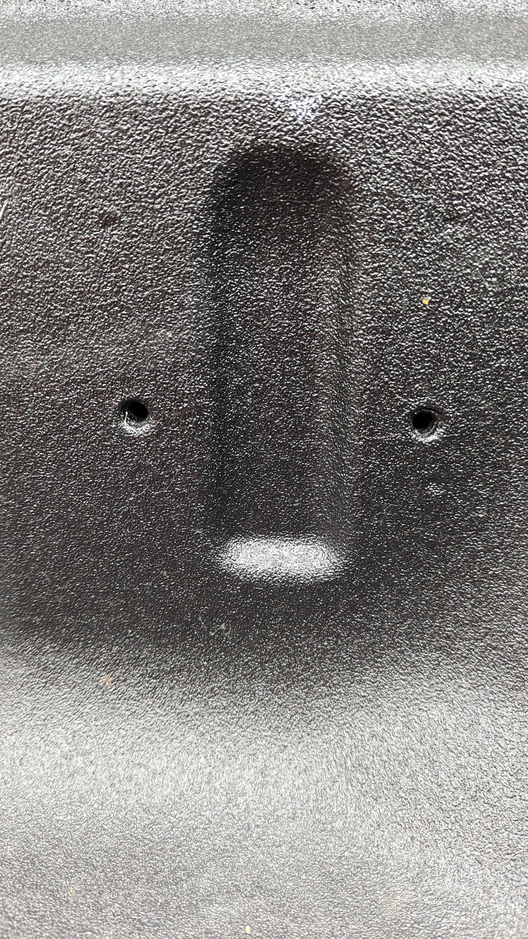

2019 SuperCab (6 ft bed). About 20" behind tailgate is this indent with bolt holes. Are these M8? Would they be sturdy enough for an anchor?

8 mm - 1.25 - Bolt size for the tie-downs in the bed. You will need a tap to clear the threads.

The sides of the bed are M8. The frame sides of the bed next to the tailgate are M6 like circled in red in the picture. (not my truck, borrowed from here).
