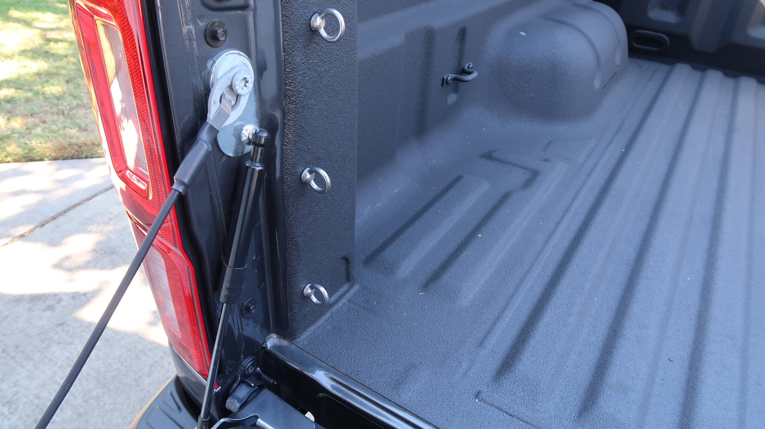

If not mentioned already, M8 eyebolts screw right into all the open screw holes and provide a bevy of tie down options. I spent just a few $ on Amazon for a couple 5 packs, got a couple left over. My only complaint is that there's no way, like any eyebolt, to have it fasten down in a particular direction. Doesn't really matter though.
Yup...
Edit:
I don't leave the rings in all the time. I kept them under the rear seat and screw one or more in as needed.
