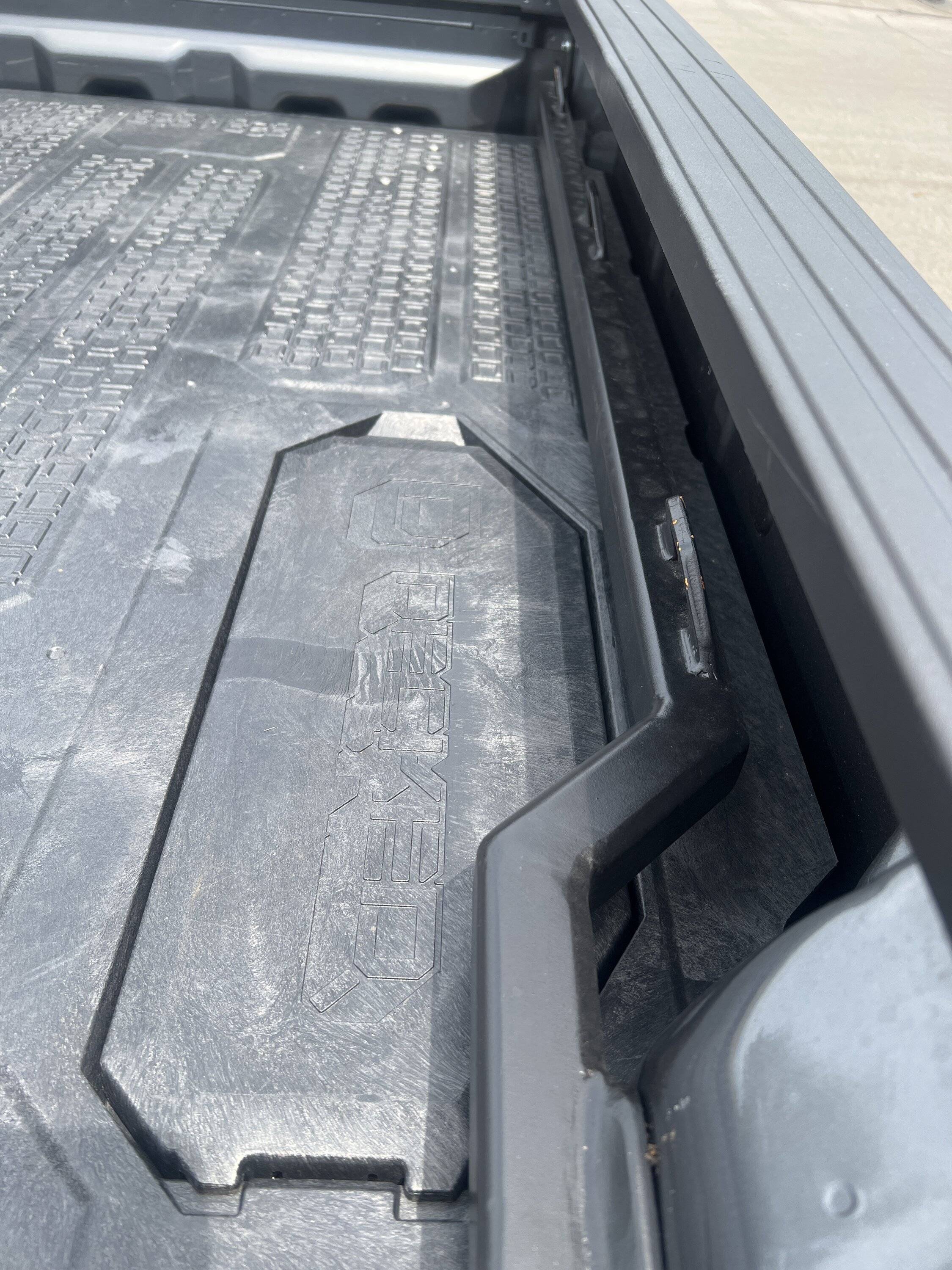

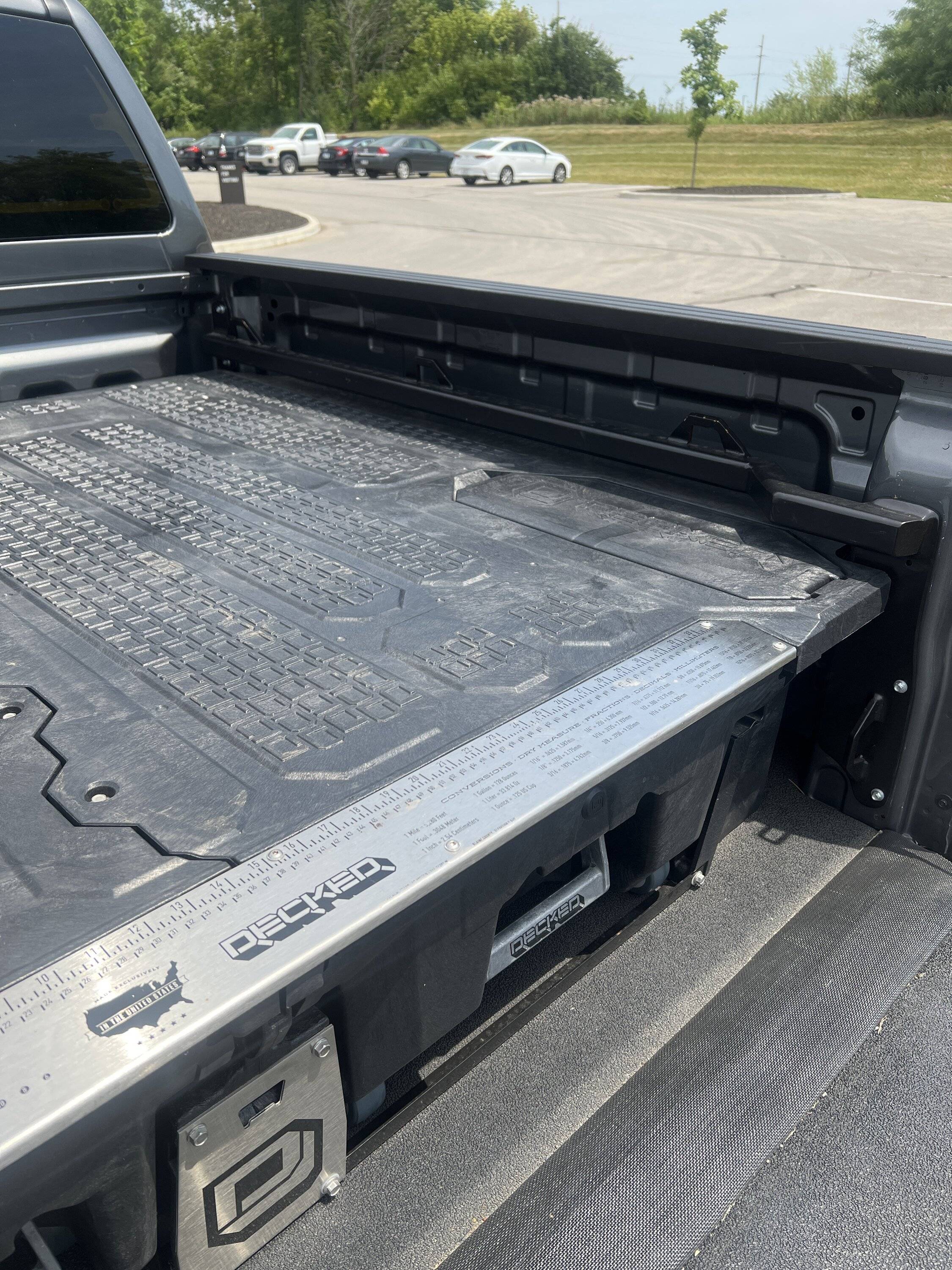

I went the DIY method for tie down rail, after installing the decked toolbox, anchored in factory threaded holes. Way overkill but very handy. Decked has accessory rails but they seemed to narrow for my needs.

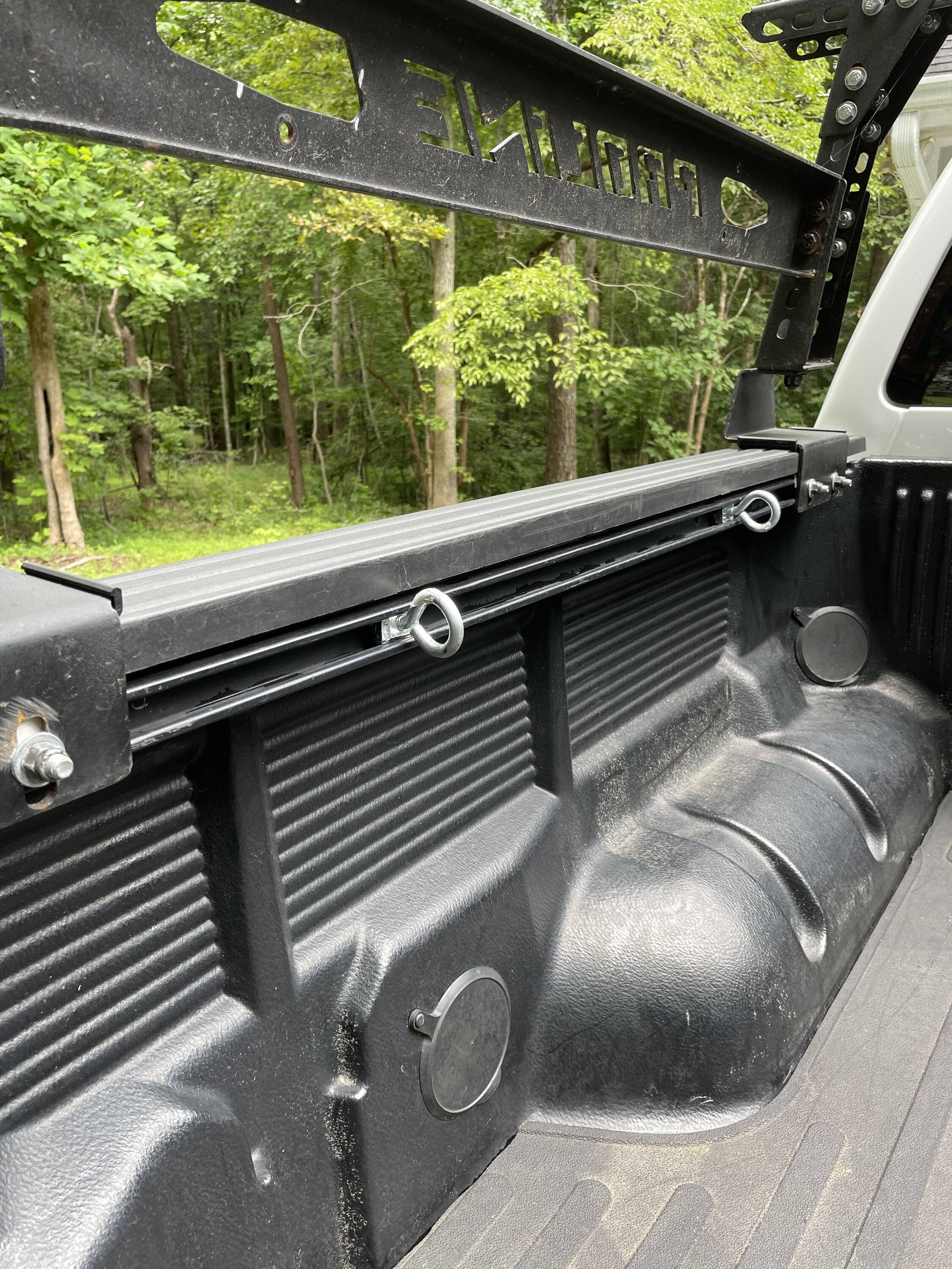

I have a ProLine bed rack on mine and it came with the tracks.

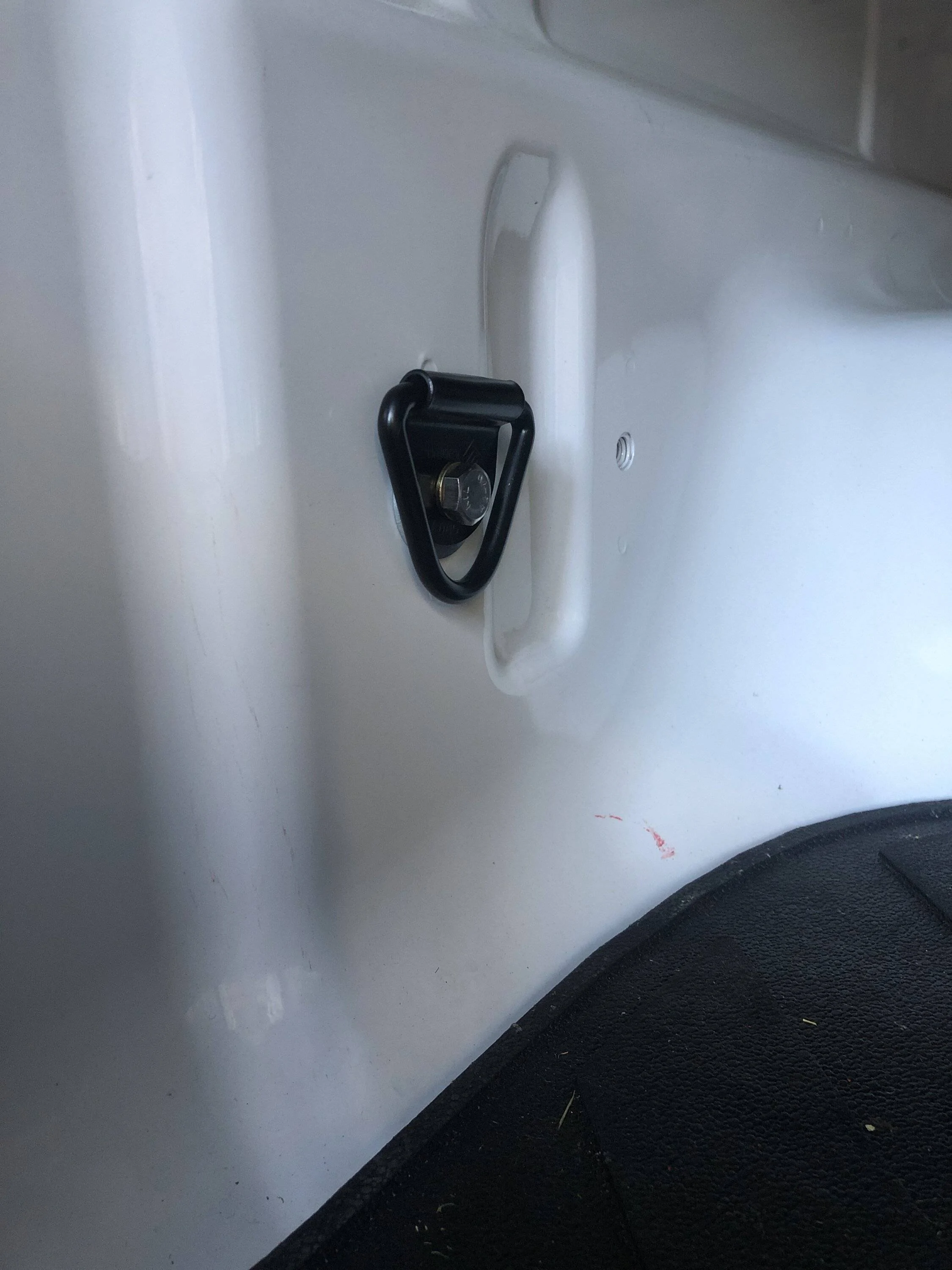

So I just received my authentic ghetto tie down rings for my 2022 XLT. I bought 4 of them to populate the 4 threaded holes I have in the bed now from the missing center tie down. I am still playing with fender washer to hopefully stand the ring off the body slightly (no minimize rattle noise) and also reinforce the mount on the outside to help the mount handle the shear forces when really cranking on a ratchet. The whole kit and caboodle should come in under $20 when I am done.

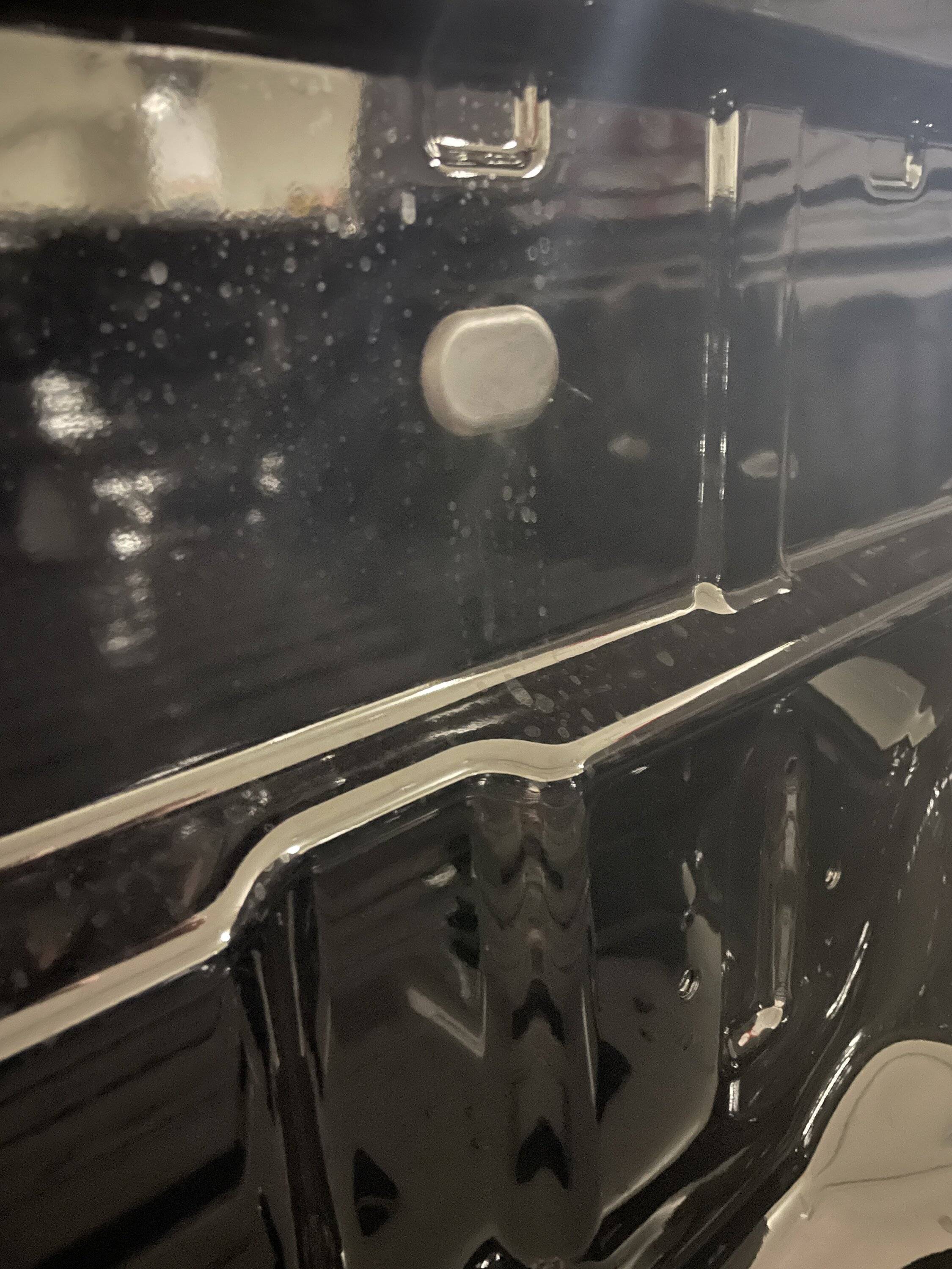

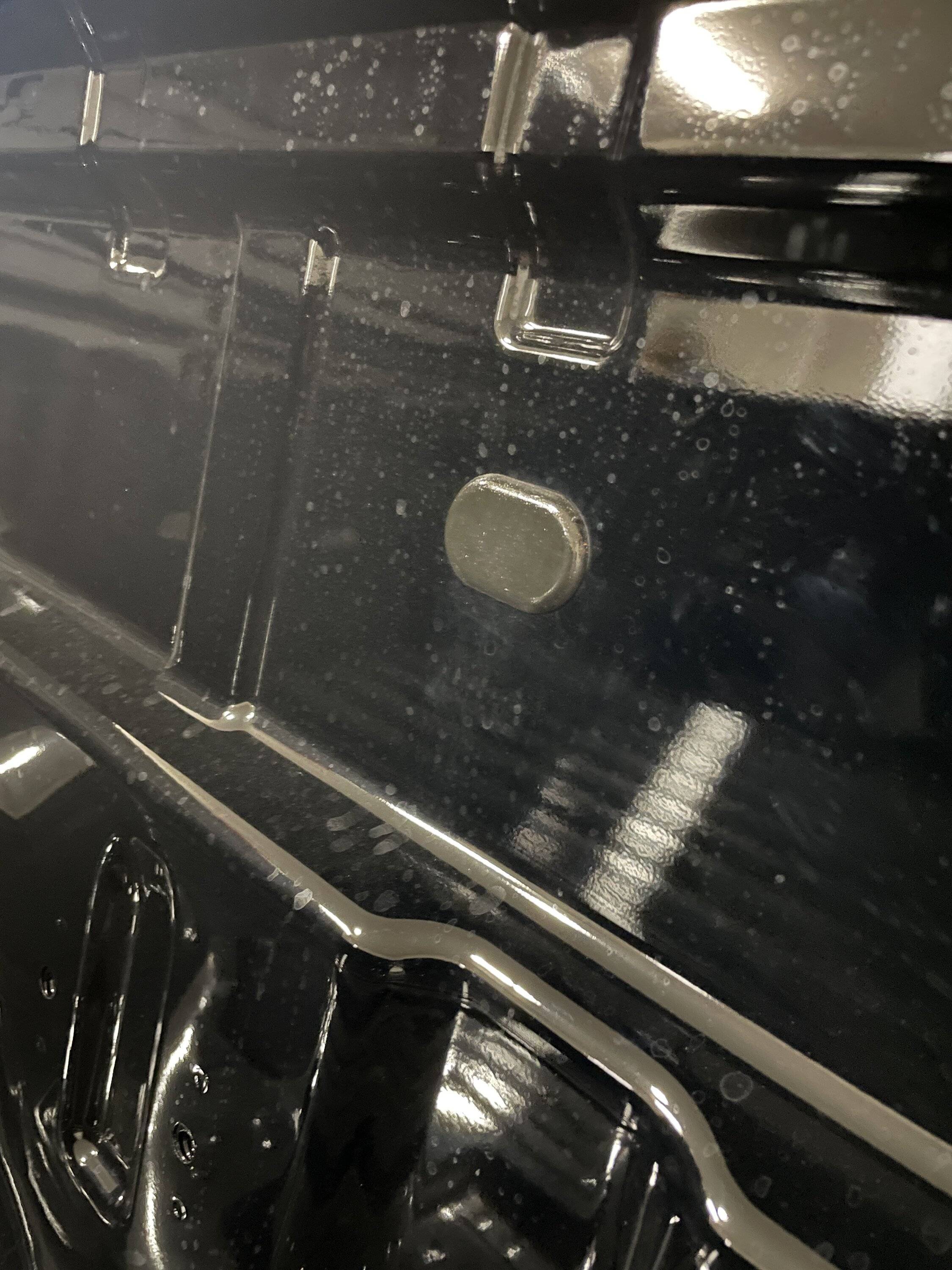

Good to know. Any idea what the holes are for that these 4 rubber Inserts plug?

I thought the same things, but the lights are installed outside of these holes, by making new holes.
