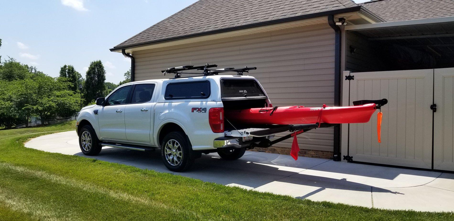

My kayak is 12 feet, so itsn't much shorter. I have the CrewCab (so a short bed) with a hard tonneau cover - the LongArm works perfectly for me. The LongArm has slots for a tie-down strap.

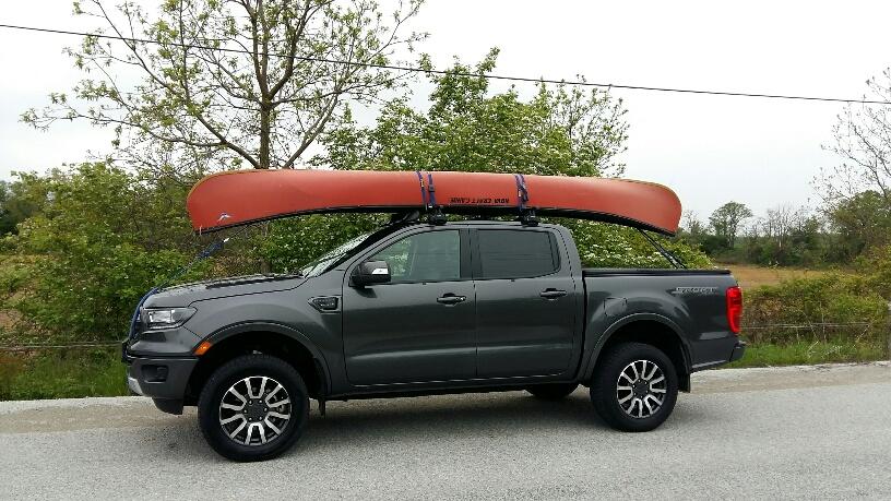

Below in a cut and paste from another thread, as far as tie downs, I have bow/stern and two cross straps with thule canoe adapter on cross bars. It can adapt to the river beater in the pic. or my 17.5 kevlar tripping canoe.

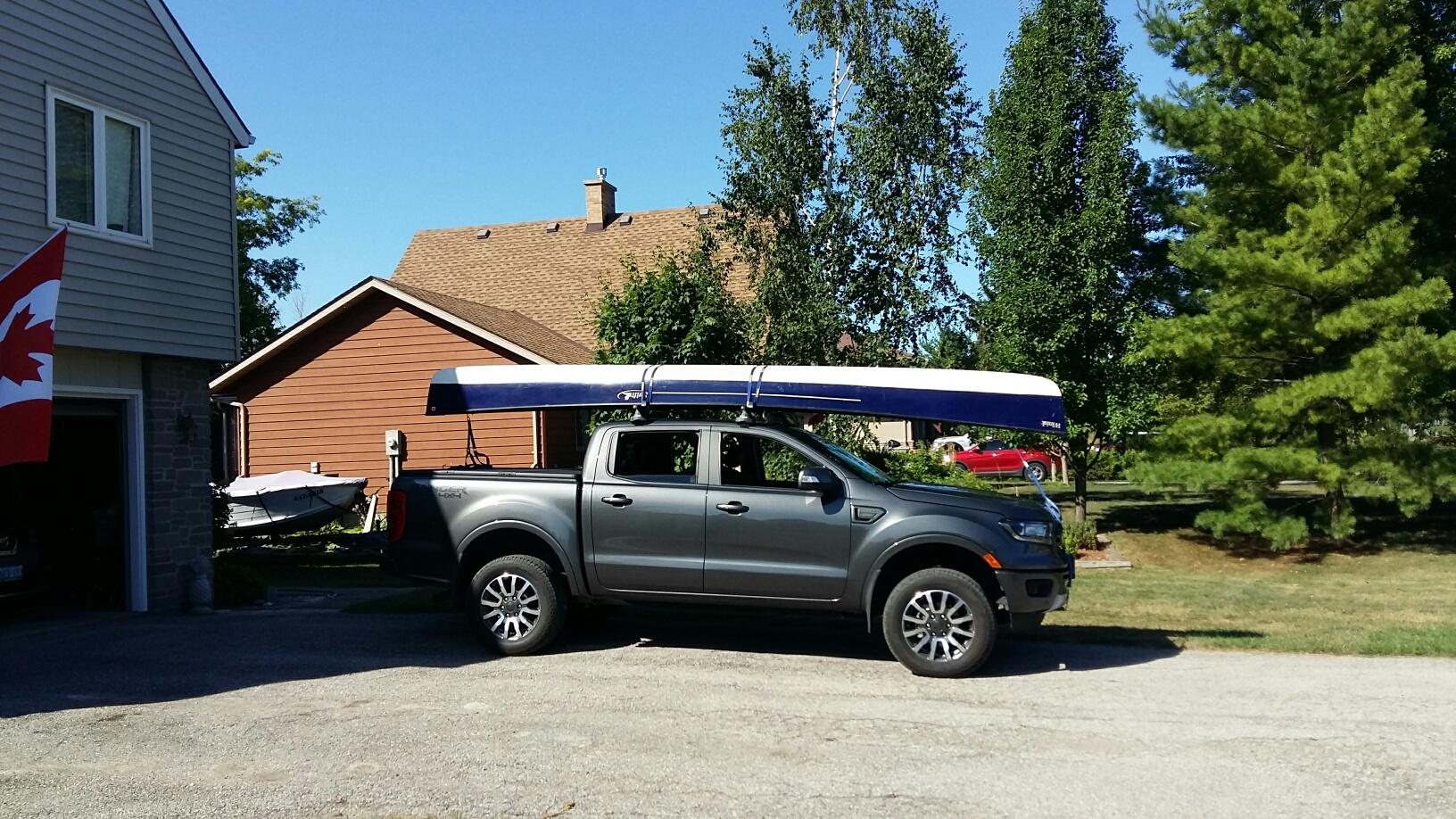

Heres mine, I had the Thule bars and an old 480 foot pack for a few trucks, since the Ranger is new to North America but not the rest of the world I was able to get a fit kit from Europe to match these older feet to my truck instead of having to get a whole new set up. Euro fit kit 1665 works on our Ranger, both Thule and Yakima make setups to fit if you are going new.

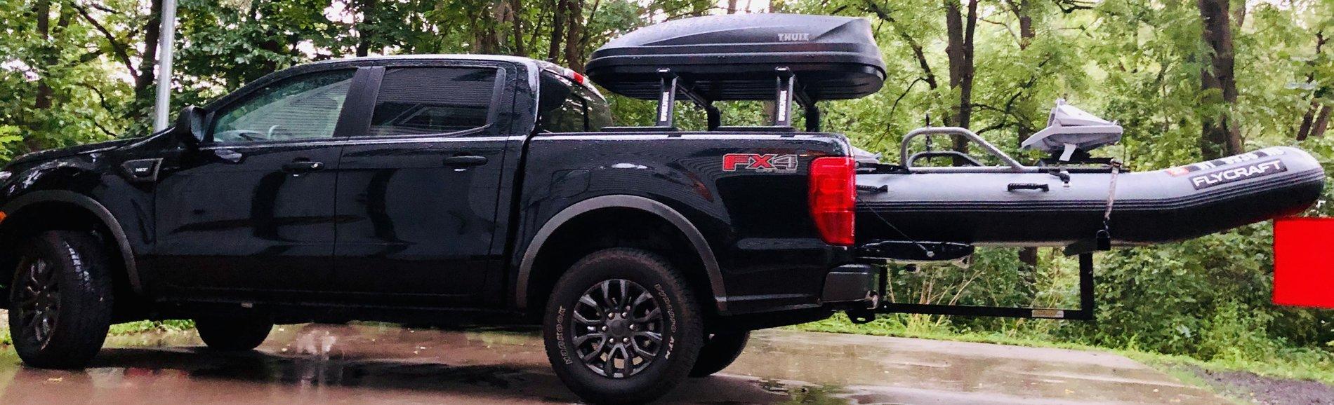

This won’t meet the OP’s requirements, but I’m also struggling to find a solution for transporting my boat. I got the Yakima Outpost in hopes of the bow of my 12.5’ inflatable angling up and over the roof and the stern extending past the tailgate. Turned out the hull wasn’t angled enough to clear the shark fin antenna and was resting on it when strapped to the load bars; no bueno. I tried reverse installing the front support and still, no bueno. I had previously purchased the Erickson Big Bed Extender Jr. for more support while carrying the boat in the bed of the truck. I chopped the extender down to be level with the outpost racks and still didn’t like/trust that system with the boat on the 3 supports. I’ve switched gears and am
now back to carrying the boat in the bed of the truck with (a shorter version of) the bed extender and a red flag hanging off of it. I stole my wife’s Thule cargo box and attached it to the Yakima system to carry all of the boat accessories. In hindsight, I should’ve either gone with the Yakima Overhaul system plus a roof support or just bought a full sized truck from the get-go (joking, i LOVE my Ranger!!).
I think a system like this is what I'm likely to go with long term. I like your solution for storage. I originally wanted the canoe up top to use the bed for storage but with this solution you are still getting the storage you need.
