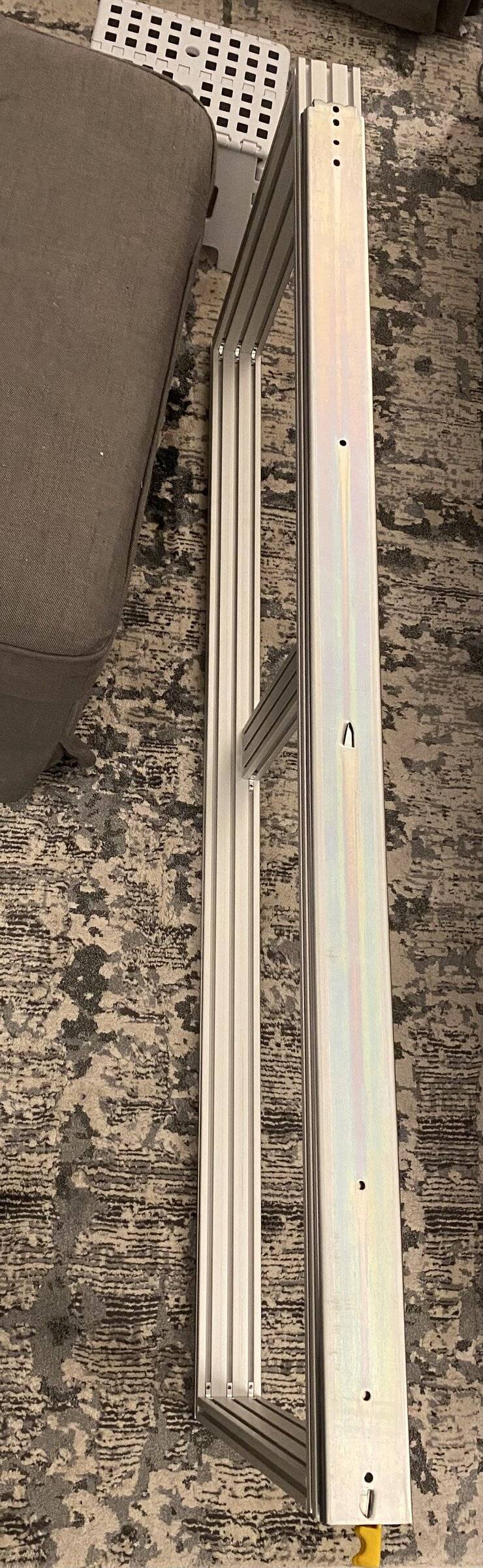

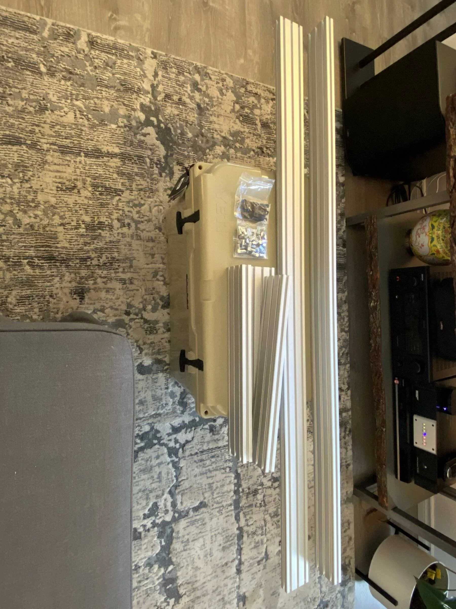

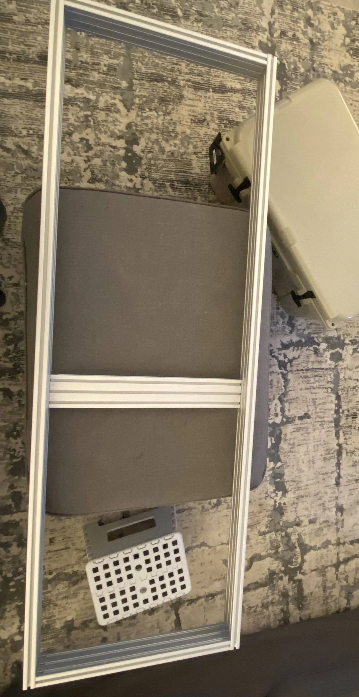

The beginning of a bed slide. This will be removable. Have some other neat touches to add to this one. Extruded aluminum is on order. Should be here in a couple weeks.
Getting the extruded aluminum that I need, for a reasonable price, has been a challenge. Had an order that got delayed and delayed. Found a different source a few provinces away. Hope to get this material soon so I can get this project going.

BillieBars ordered. Extruded aluminum should ship this week. Most of the bike carrier parts have arrived. Almost time for fabricobbling to ensue.

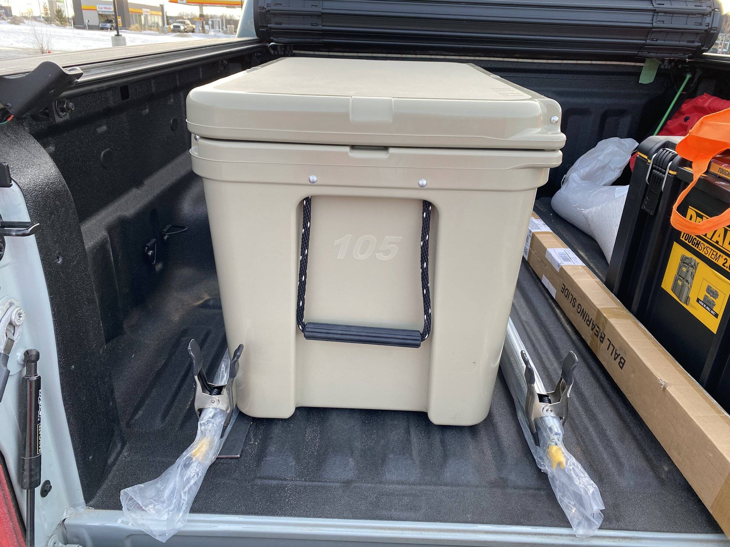

Bolted one of the slides in place. The height is perfect. I planned for the slide to overhang the track in the rear. Didn’t have enough short bolts to get this mocked up tonight. Have a busy few days at work. This will have to wait for the weekend.

Your extra bed tie downs, where’d you get those?
They have all the hardware and just screw into the bed holes?
