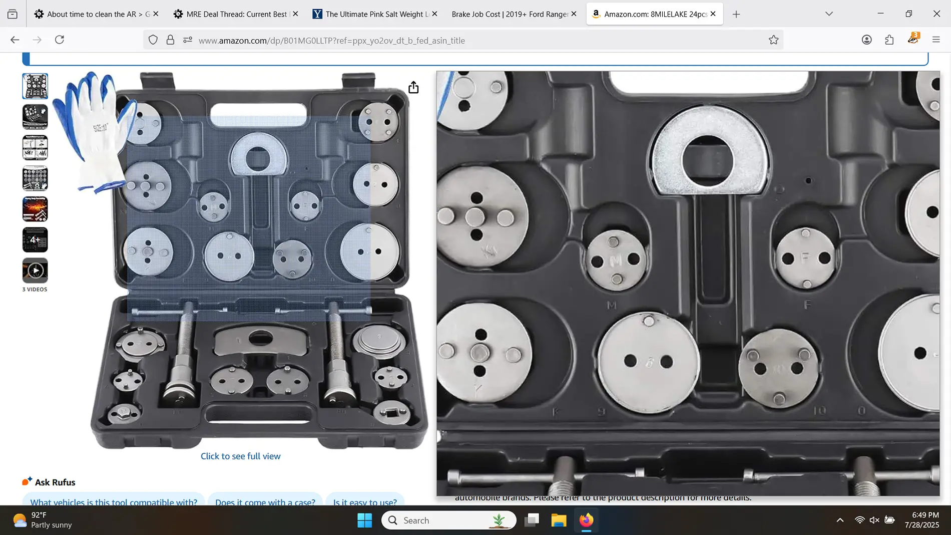

Just remember the rear calipers are 'screw in' type and are easiest to do if you buy a version of the special tool to do them. Fronts can be done with your favorite C-Clamp or a specialty tool.
