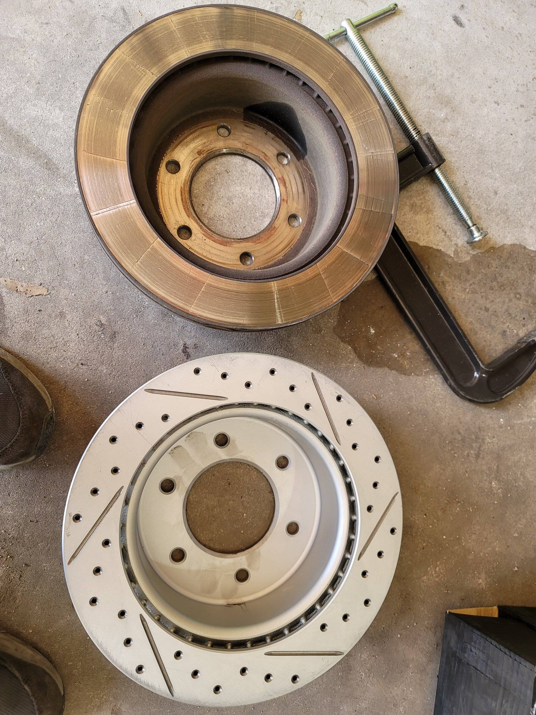

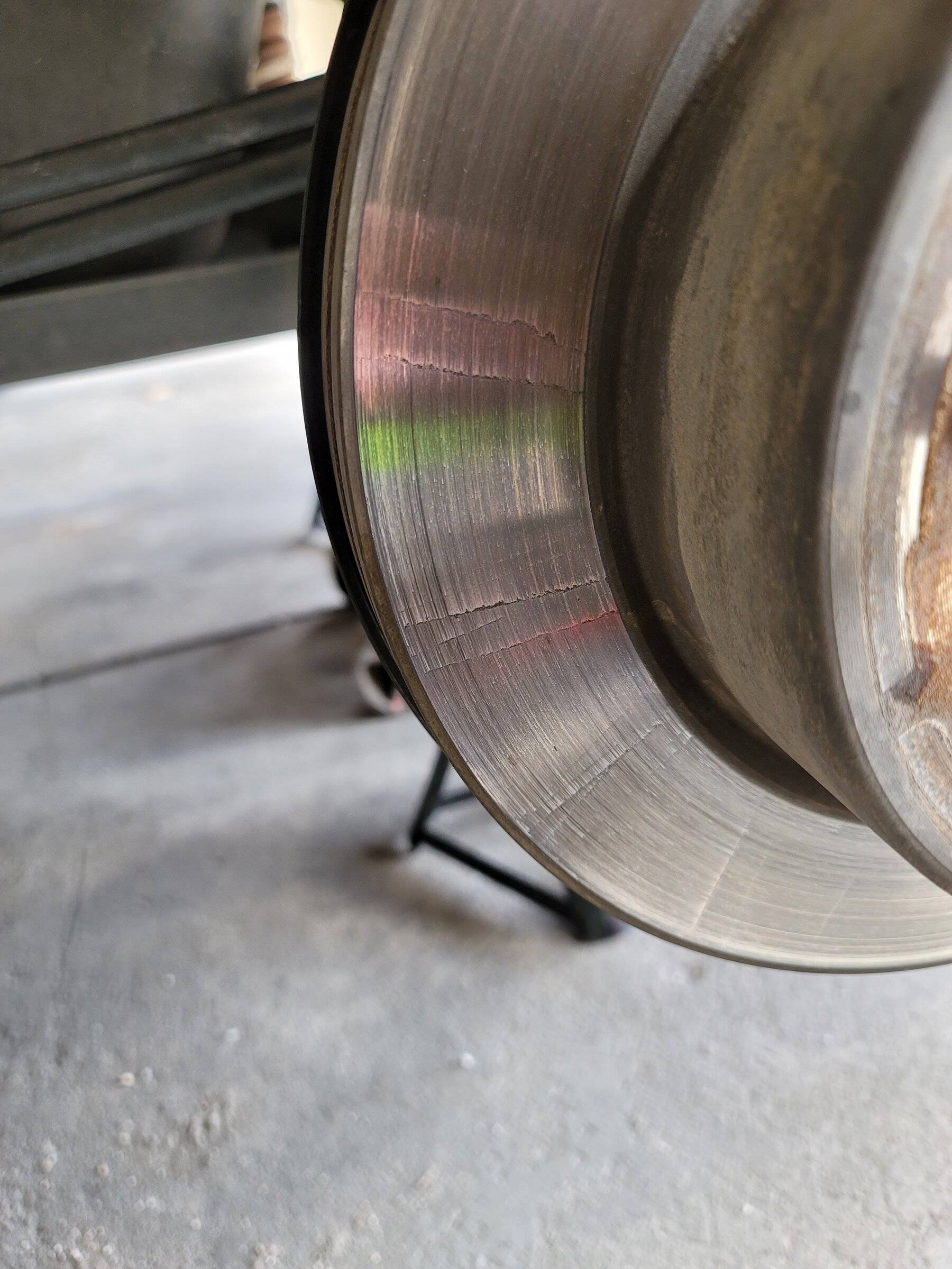

I was dealing with some braking issues with my 2020 Ranger, I thought for sure it was the front rotors due to the intensity of the surging since I was convinced I felt it in the wheel as well.
I had done some extensive off roading over the summer with one trail in particular that posed heavy braking challenges on the way back down. Since I had a friend there as well, I was often stopping and waiting for him to navigate an obstacle before I could continue so I was confident I had cooked some pad material on the rotors.
I replaced the front rotors and quickly discovered that the problem was coming from the rear, so I replaced them as well and the problem went away entirely. Including some pictures to show the difference in old vs new.
I went with the drilled and slotted rotors to test this summer when I plan to do a lot of trail driving again, I know there are downsides to them as well but I am interested to see if allowing gas and air to escape will prevent the previous marking I had on the rears.
Anyway, just wanted to share my experience in case you do a visual inspection and find a situation similar to mine! Or if the front rotor work still hasn't fixed your issue.

How many miles are on the drilled and slotted rotors? I’m very interested in seeing if that fixes the problem in the long run.
Yep, I'll need part numbers and where you got them from. After I did a traditional brake bleed on my truck it got somewhat better, but I had already put 5K miles on the messed up rotors because I can't take my truck to the dealer for a week every 2 months...
So far I have about 1500 miles on them, no issues at all and haven't been getting any excessive brake dust either. I have only daily driven it with them on though, so nothing too taxing for them but I also have not had any reason to suspect they wouldn't hold up to some abuse. A light to moderate trail will be in the near future for them though. This is the kit I purchased:
R1 Concepts Rear Brakes and Rotors Kit |Rear Brake Pads| Brake Rotors and Pads| Ceramic Brake Pads and Rotors |Hardware Kit |fits 2019-2021 Ford Ranger https://a.co/88Ce5c5
Purchased on Amazon (my link goes to them and the part number for the kit is 1PC.54156.42)and shipping was faster than they quoted. Also got the front kit and no issues with those either and the fitment and quality of the kits were great.
Had the exact same thing on the rear brakes of my 2019 with about 22k miles on them. Pulsing when braking and the same lines on the rotors you see here. Replaced with raybestos rotors and powerstop pads and all good so far. Do you leave your parking brake on when you park? I did and was wondering if that was contributing.
