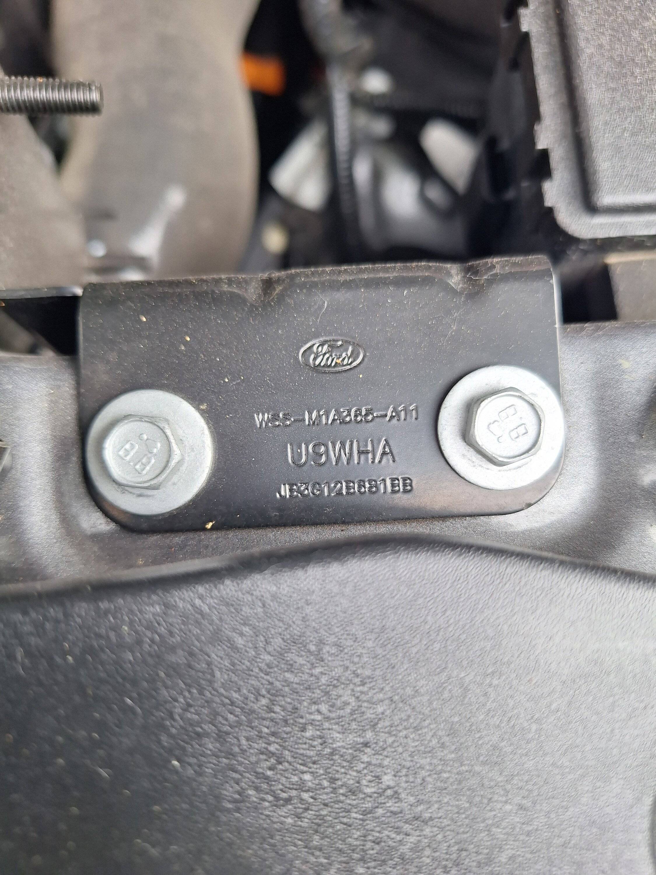

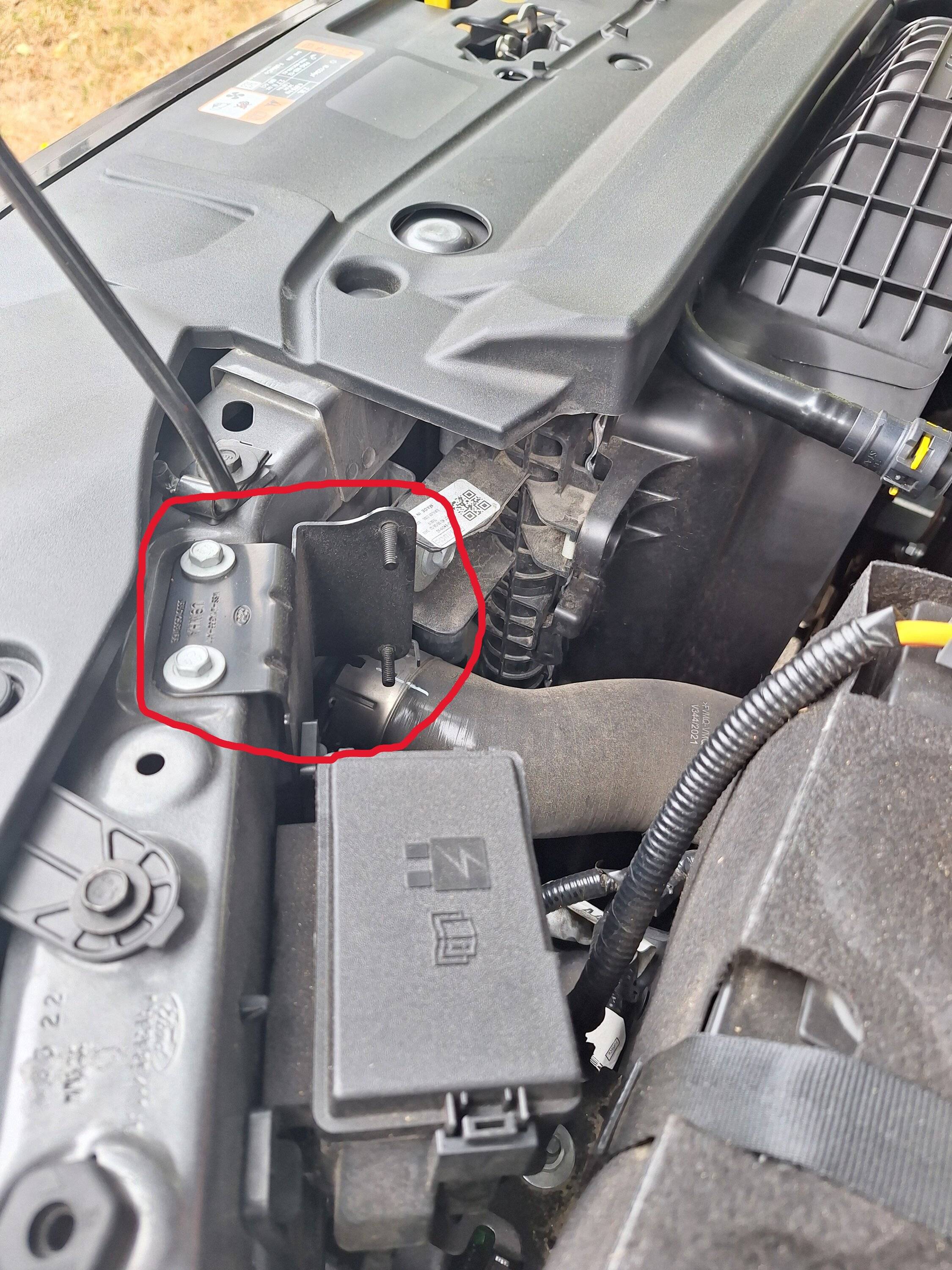

I'm a new owner of a gently used 2022 Ford Ranger Lariat Tremor and loving it. Was checking out the engine bay and noticed a bracket with some studs on it (circled in red) next to the aux switch fuse box.
Anyone know what the bracket is for? An Oil Catch Can or something else?
I tried searching for the numbers on top of the bracket but could find anything meaningful other than:
WSS-M1A365-A11 is a steel alloy spec
U9WHA google search results say its door hinge bracket, but it's definitely not that
JB3G12B.... ?????? looks like a ford part number of sorts

It looks like a handy bracket for stuff. I doubt you could order it by itself.

It's where I mounted my oil catch can instead of teetering above the engine fan

Its been discussed on here and I think it was determined to be a Tremor specific mount point for the Ford catch can, but cannot confirm that I remember correctly.

Ok, curiosity got to me on this bracket:
Here is the Part Number - JB3G-12B681-BB
It is for the ROW Ranger markets with Diesel Engines as it is a - Glow Plug Relay Mounting Bracket, so for the US Version Ranger - it serves no purpose for OEM mounting however aftermarket Winch options use that bracket for mounting.

I used it to mount my winch controller

huh, just checked, and my 2022 XLT Tremor does have that bracket installed as well. Hmm, well I am sure i will figure out a mod for it in the future LOL.
