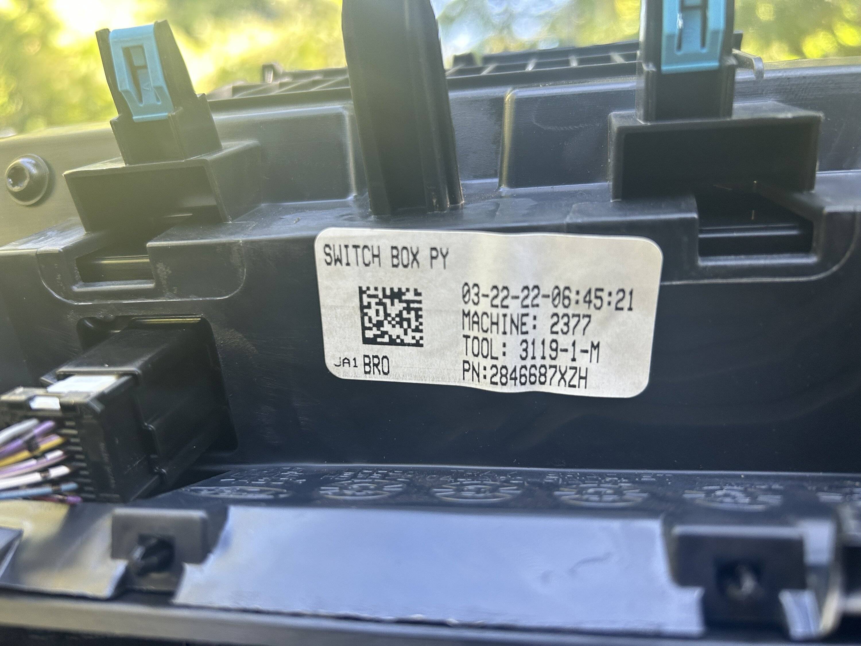

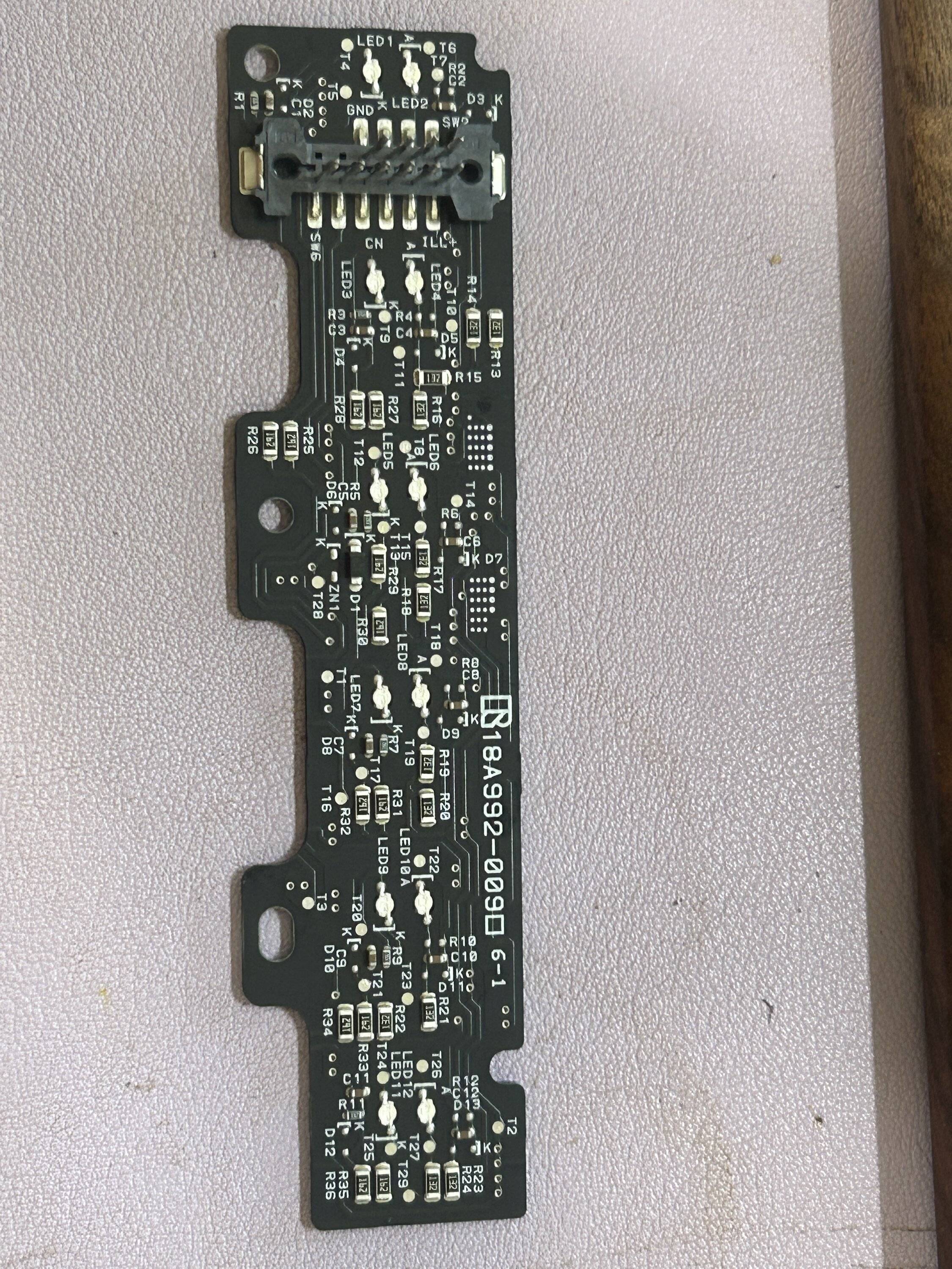

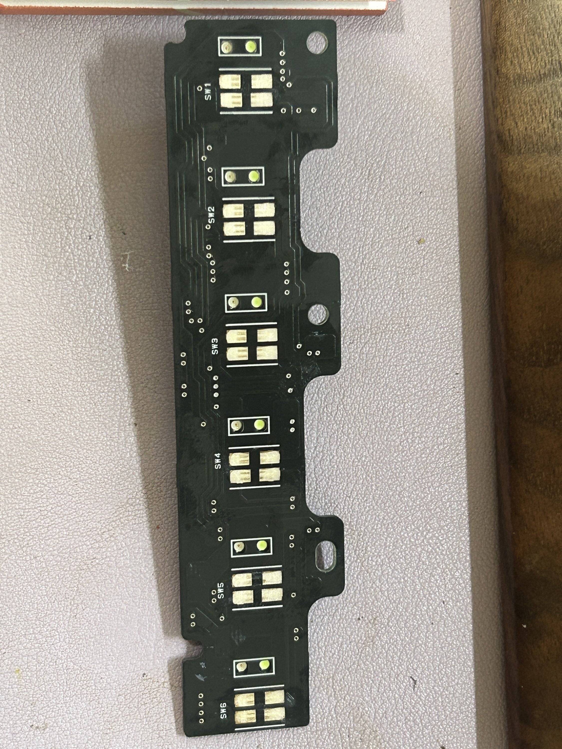

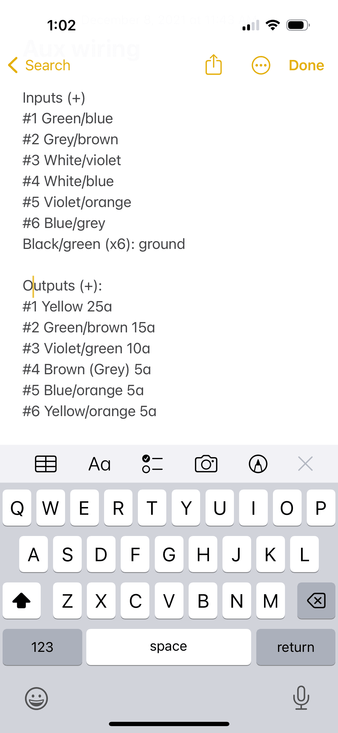

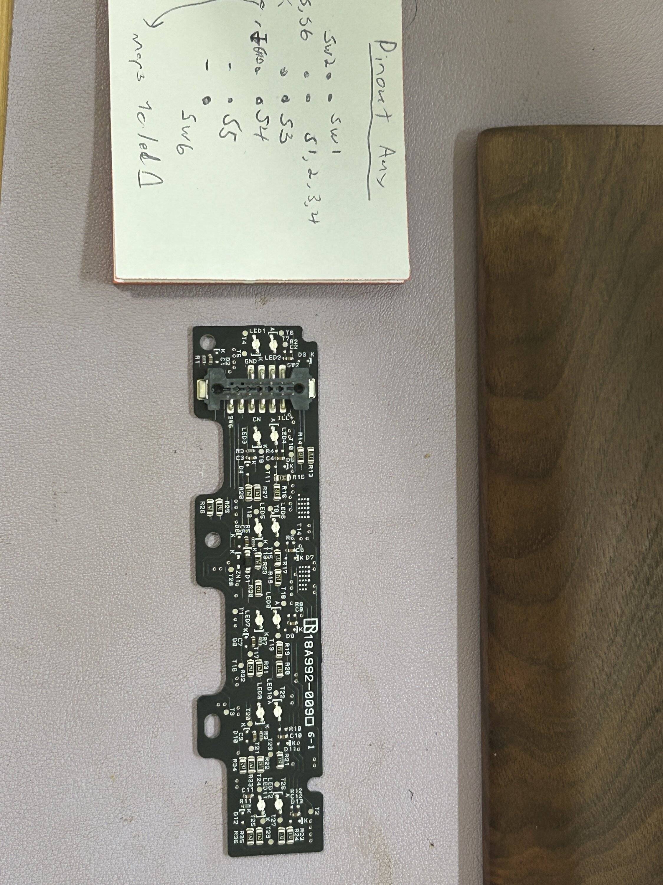

I’m working to replace the factory upfitter switches with some custom ones. I took apart the module and managed to map out most of the pins from the wiring harness. Does anyone have a guess on what the three I can’t figure out are for?
Each switch has a dedicated PIN, then there’s a common ground.
One pin is labeled K that seems to map to a couple of the LEDs but not all
Two of the pins map to partial switches as the sticky note indicates.

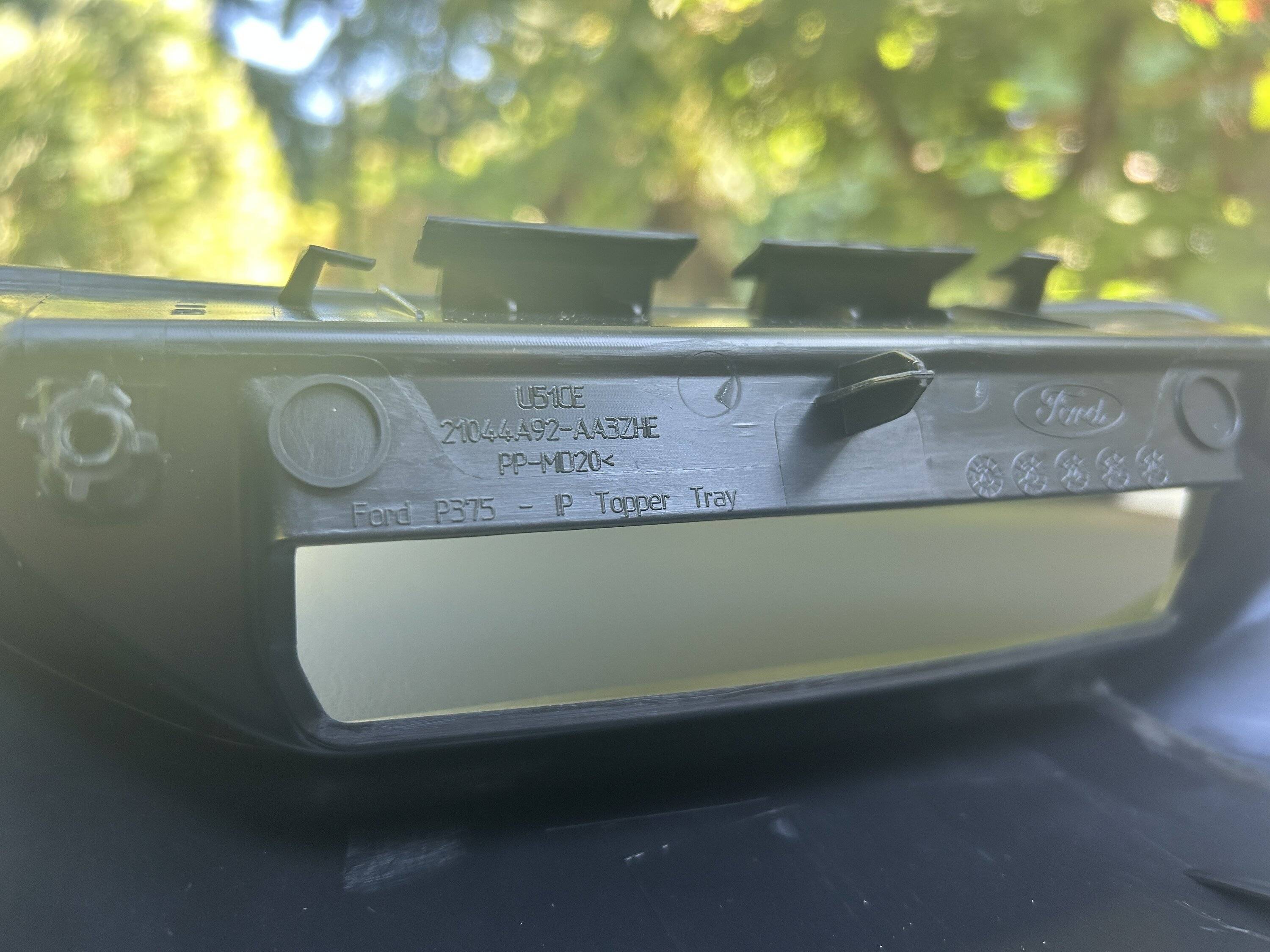

I’ve found switches that will fit I think but am a little nervous as ford is telling me that the topper tray can’t be ordered on its own if I mess it up
