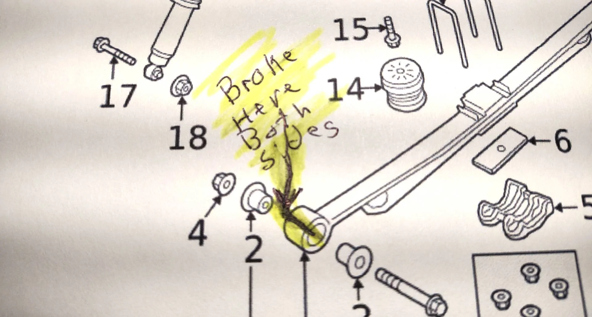

Both Leaf Springs Broke

Love to see a successful upgrade! My front bushing looked same as yours when I removed it--completely junked. I wonder if in our situations the bushing failed first then the forged eyelet? Or vice versa. Either way, agreed that is not acceptable.
I replaced the bolt and nut on the forward eye on the side that failed just in case it was compromised somehow, but like you observed all of the hardware looked to be in really good shape.
