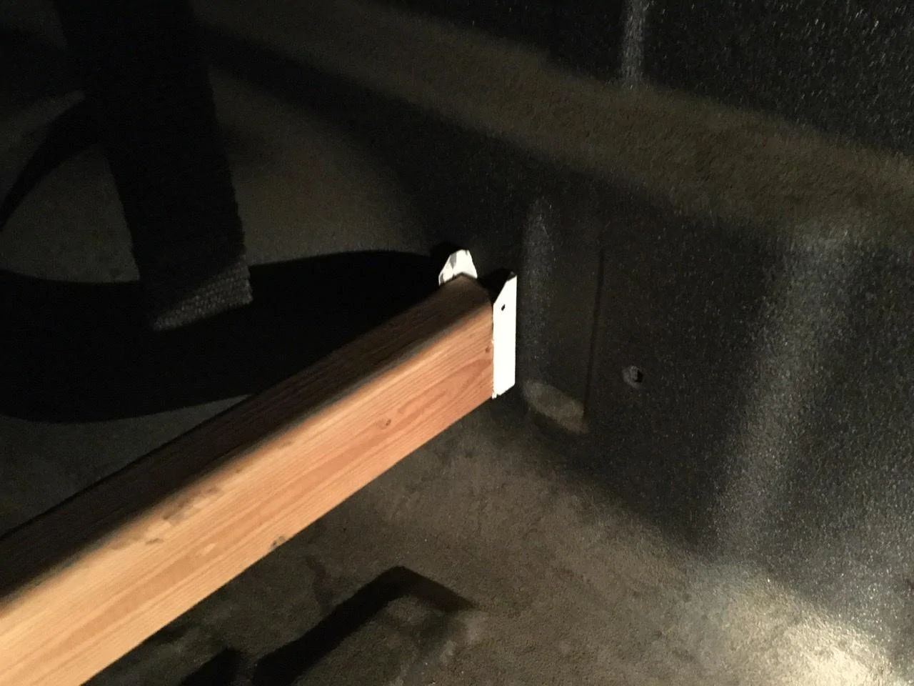

I've been following this for a while, here is what I decided to make. I'm hoping to find a color match and paint it Saber.

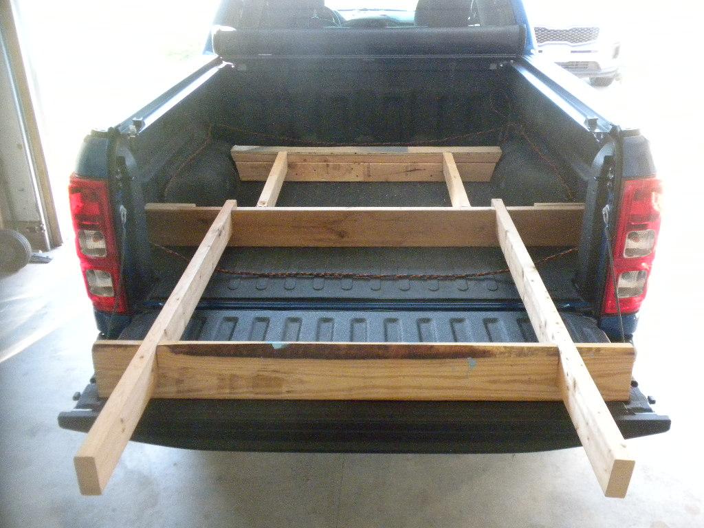

Finished my sheet goods rack extension from my board across the back. More scrap lumber from another project. Used the notch together system this time.
Nice, easy to remove the extension when not carrying sheets but still don't want things sliding around.

Heres my sheet good hauling setup. Notched out the boards so that they "lock" into each other. The front "header" board has some clasp latches that latch onto the long board to keep things from sliding fore and aft. The length is a full 8 feet to fully support sheet goods. And 2x8s are perfect height for clearing the wheel humps so the sheet cant lay flat. Could probably easily build something short within the whole bed for a cooler or "compartments" for other things. I built it this way so it is extremely rigid when installed, but since there is no screws holding things together, I can easily disassemble it into the individual boards and store it in minimal space.

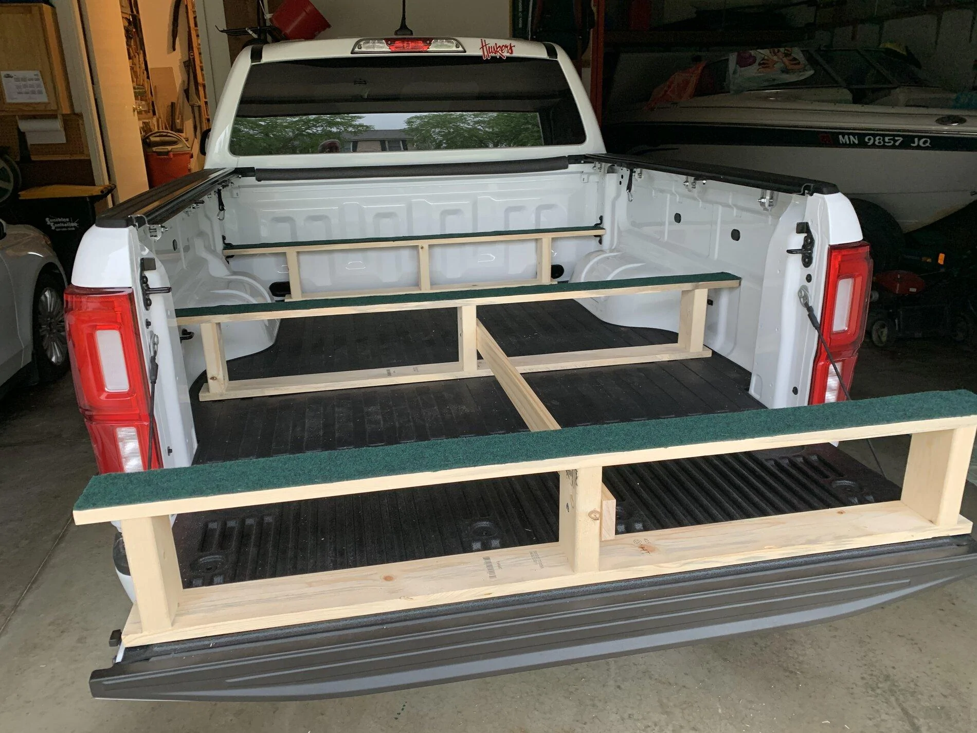

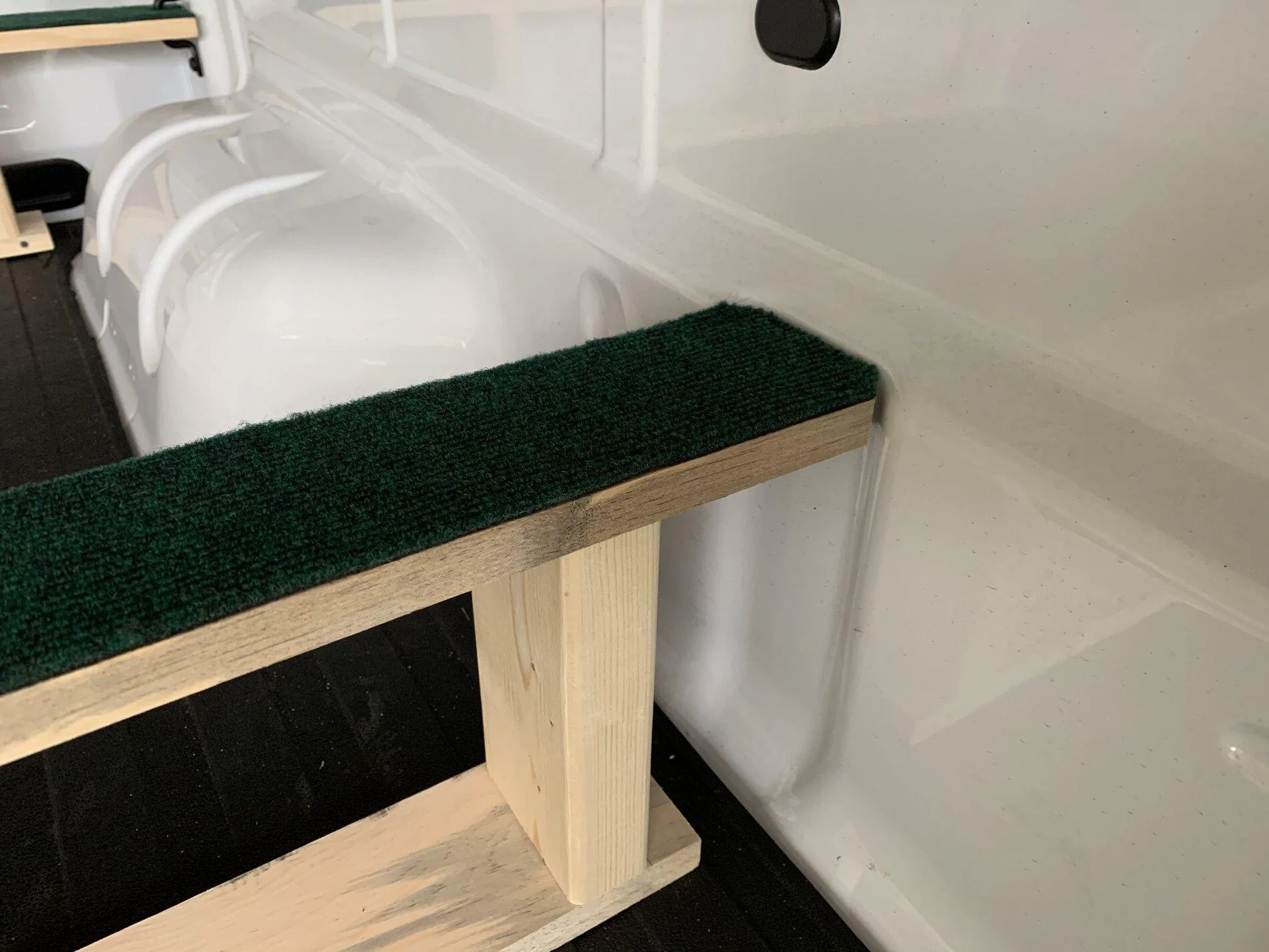

Anybody got any ideas for a lightweight version? Doesn’t need to be as strong as a 2x12.
This what I built for hauling 4x8 sheets. I wanted to still be able to haul dimensional lumber underneath. The second crosspiece could also be used for your divider.
