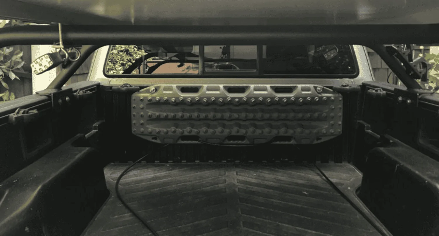

I want to mount them as shown below, just not sure how to go about doing it. Scared to drill blindly ?

I will when I get around to buying a set. I'm going to install nutserts and use the bolts with the plastic knob heads to attach.
Ah these nutserts are cool. I'm new to DIY. So I guess these are the steps I would take:
  1. Get a 3/8 drill bit (or smaller?) and drill holes for 3/8 nutserts
  2. Get a nutsert tool and install the nutserts
  3. Install 3/8 set screws
  4. Add star knobs

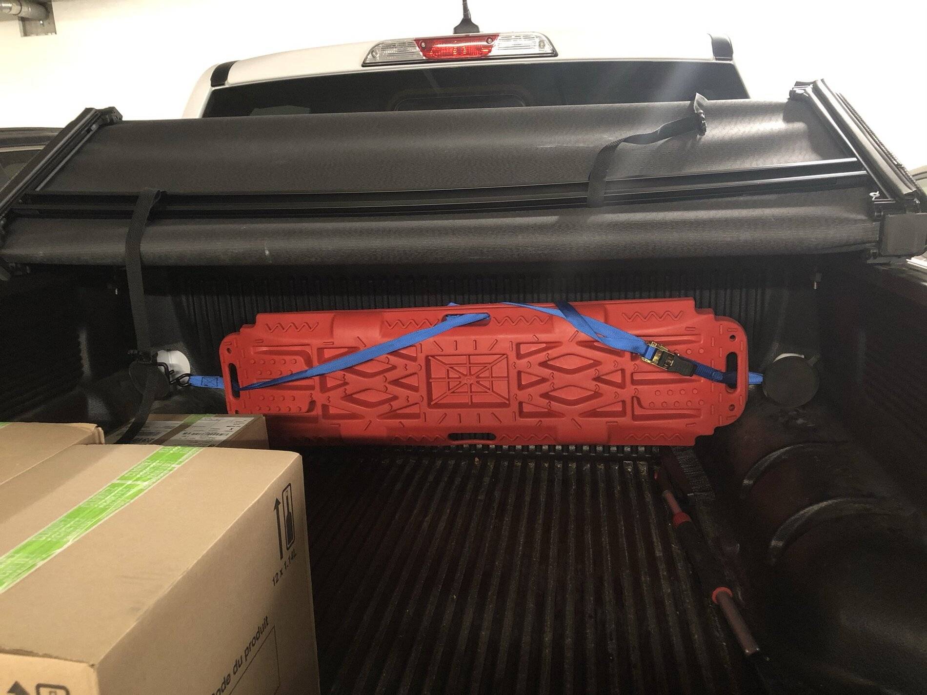

Temporary solution:

Get some bed racks designed to mount to the already present factory holes. Check out Builtright but there are others.
Yea those are pretty nice, only issue is that I would have to remove the drop-in bed liner.
