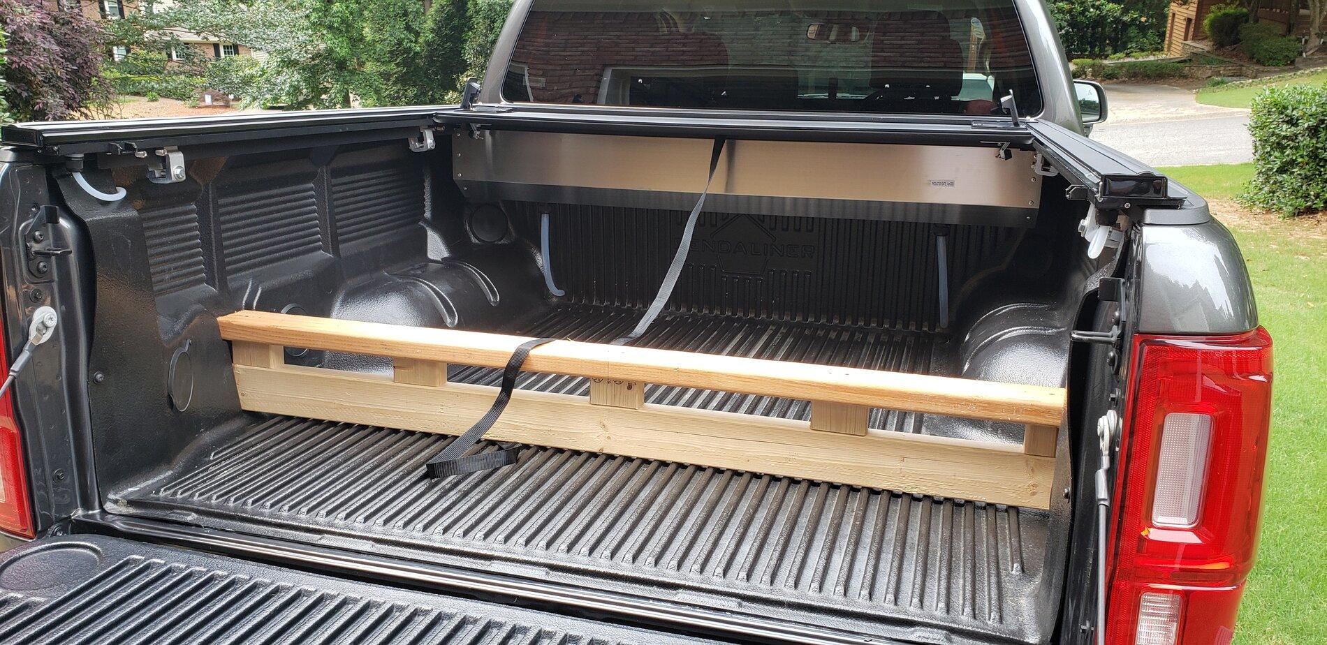

Has anyone cut a board for the slots near the rear of the bed? Something like a 2x8 to go across the bed? I had one years ago in a Dodge Dakota and it was really helpful. The Ranger slots look too wide and too shallow.

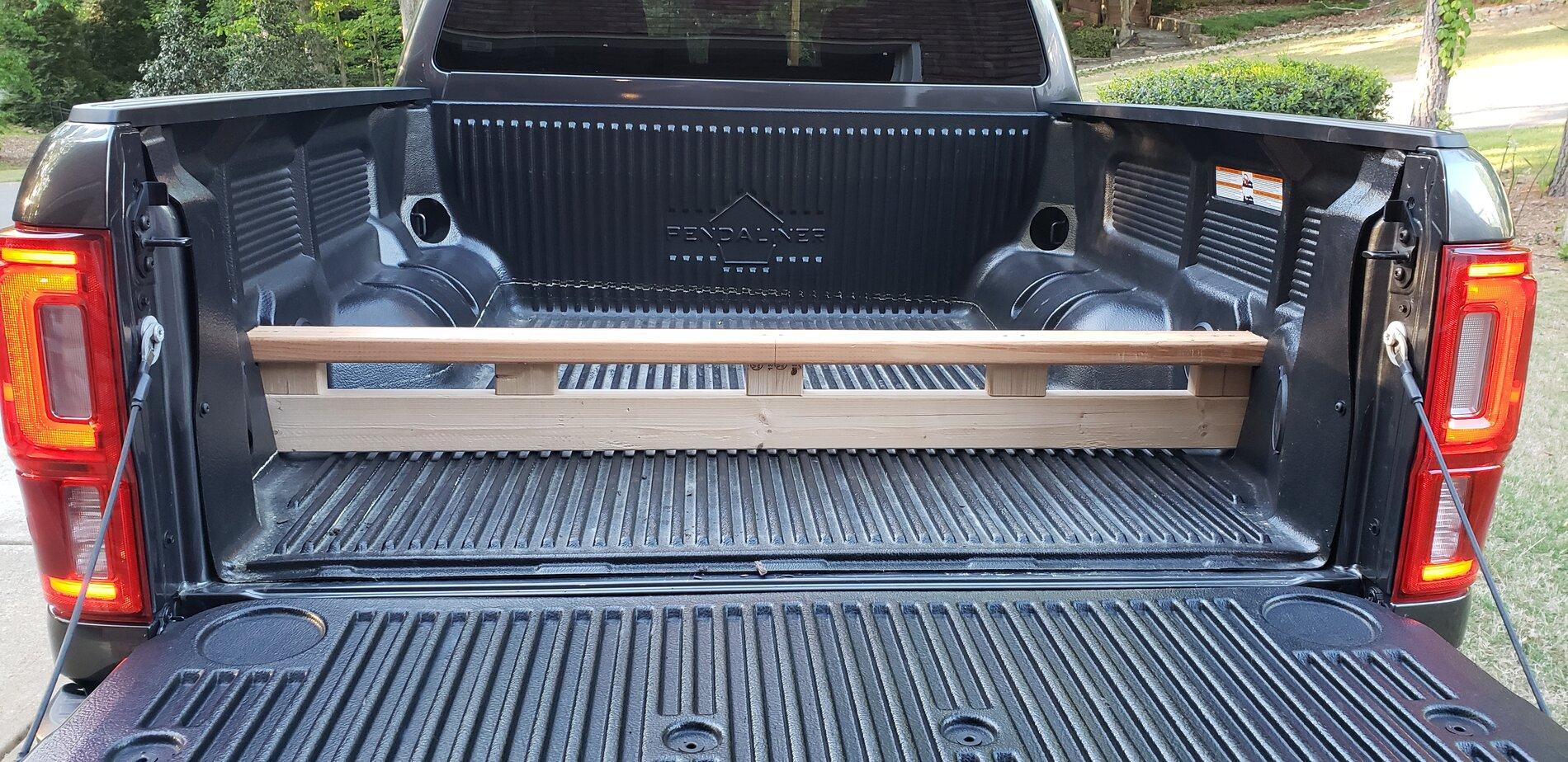

Yes, you need the thickness of two boards to fit the width of the slots. No the slots are not too shallow the boards fit firmly. The 2nd board isn't as wide so you cannot see it in this view.

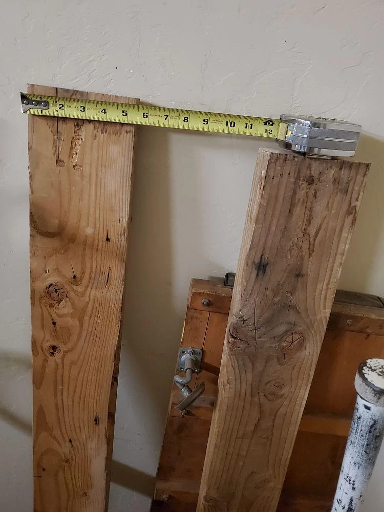

So, is that the thickness of two, 1.5" boards, 3" total?

More or less, one is a standard 2x8 the other a 2x6. Standard 2X's measure somewhat less than a full 2 inches.

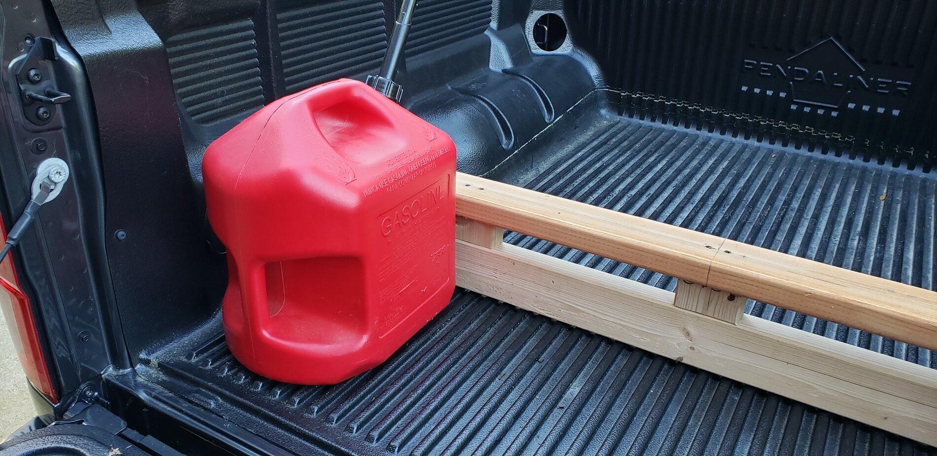

I guess one could cut the second pieces so they only fit on ends of the first board. Say 4". To fill gap but not add weight of second board.

That's what I did when I made my lumber rack

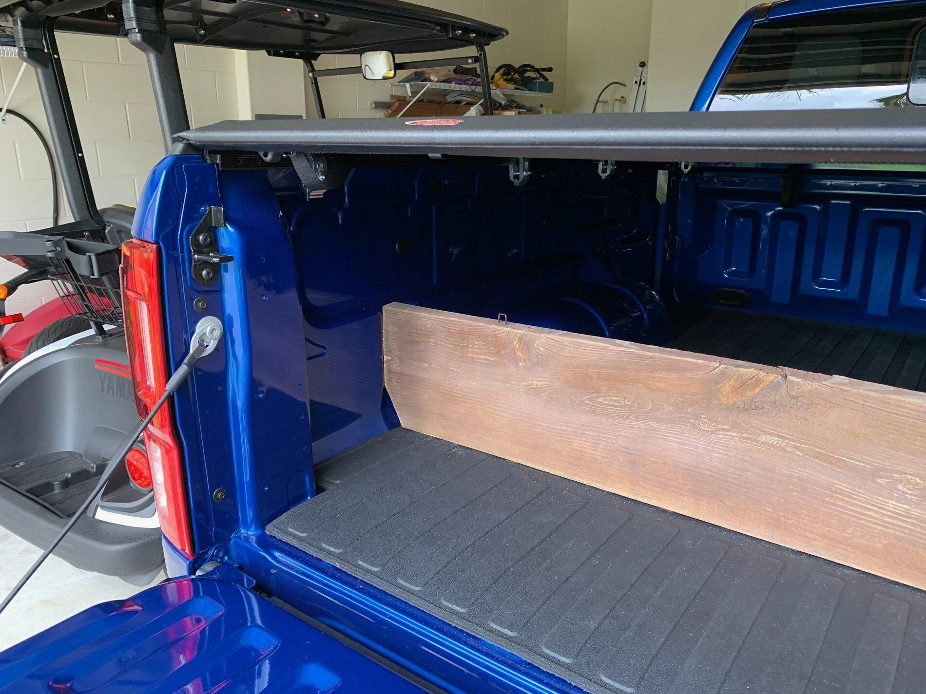

I just used one board, works fine. I've also got a spray in bed liner, the extra thickness might be more important for an unlined bed?

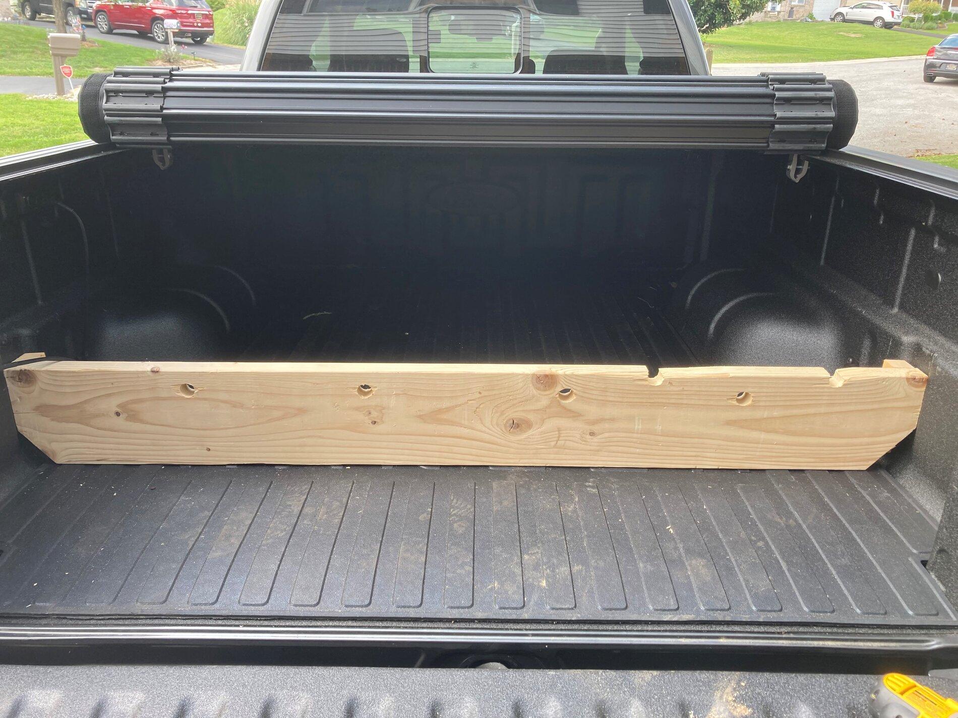

Thank you. That's exactly what I want to do....with a couple notches for fishing poles. Just to hold a chair and tackle box back there instead of the backseat.

62.25" was a touch too tight with the spray-in factory liner. I shaved a little more off and added some 1x on the ends to snug it up in the slot.
