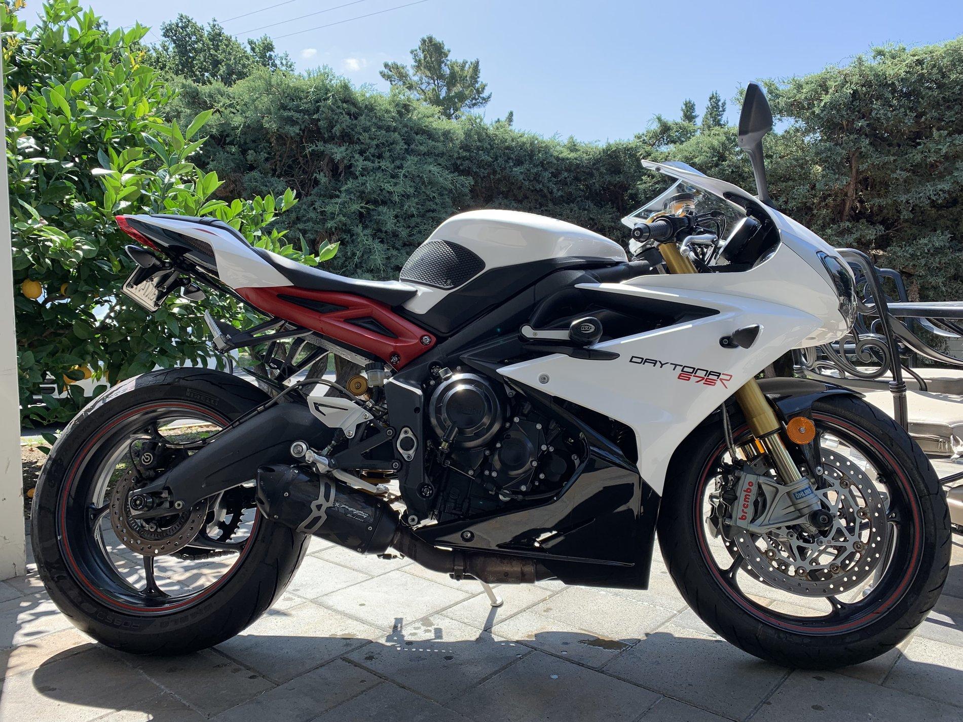

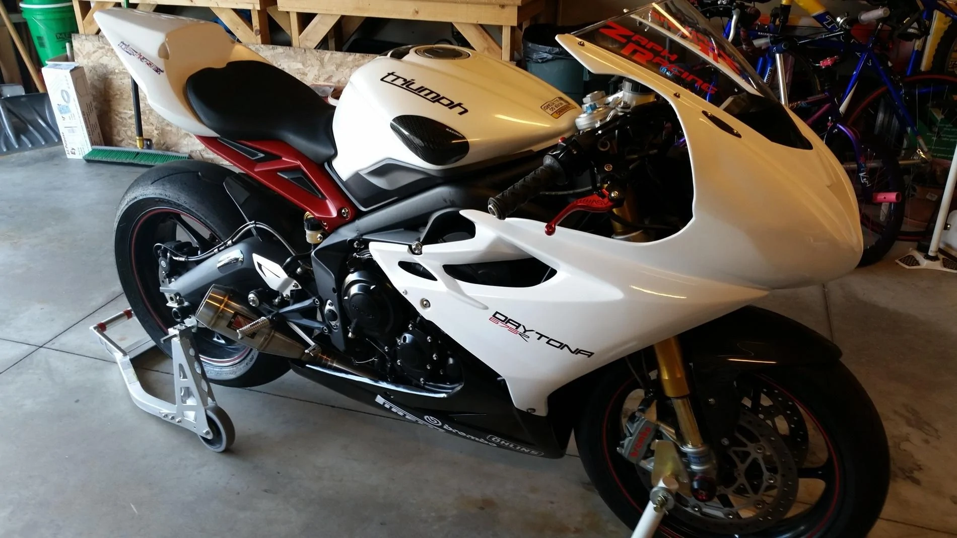

I've had a few. One of my favorites. 160+ on the front straight of Road America.

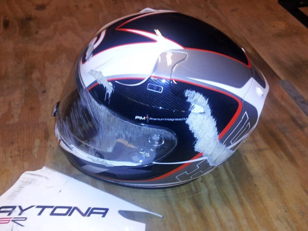

This piece next to my helmet is all I have left, hahah,
Oh man, Glad you were OK after that one. I had a pretty sketchy situation on mine, came few feet from hitting a curb at 135, sold it a few weeks after. I cannot resist the temptation to go fast.. so probably a safe bet.

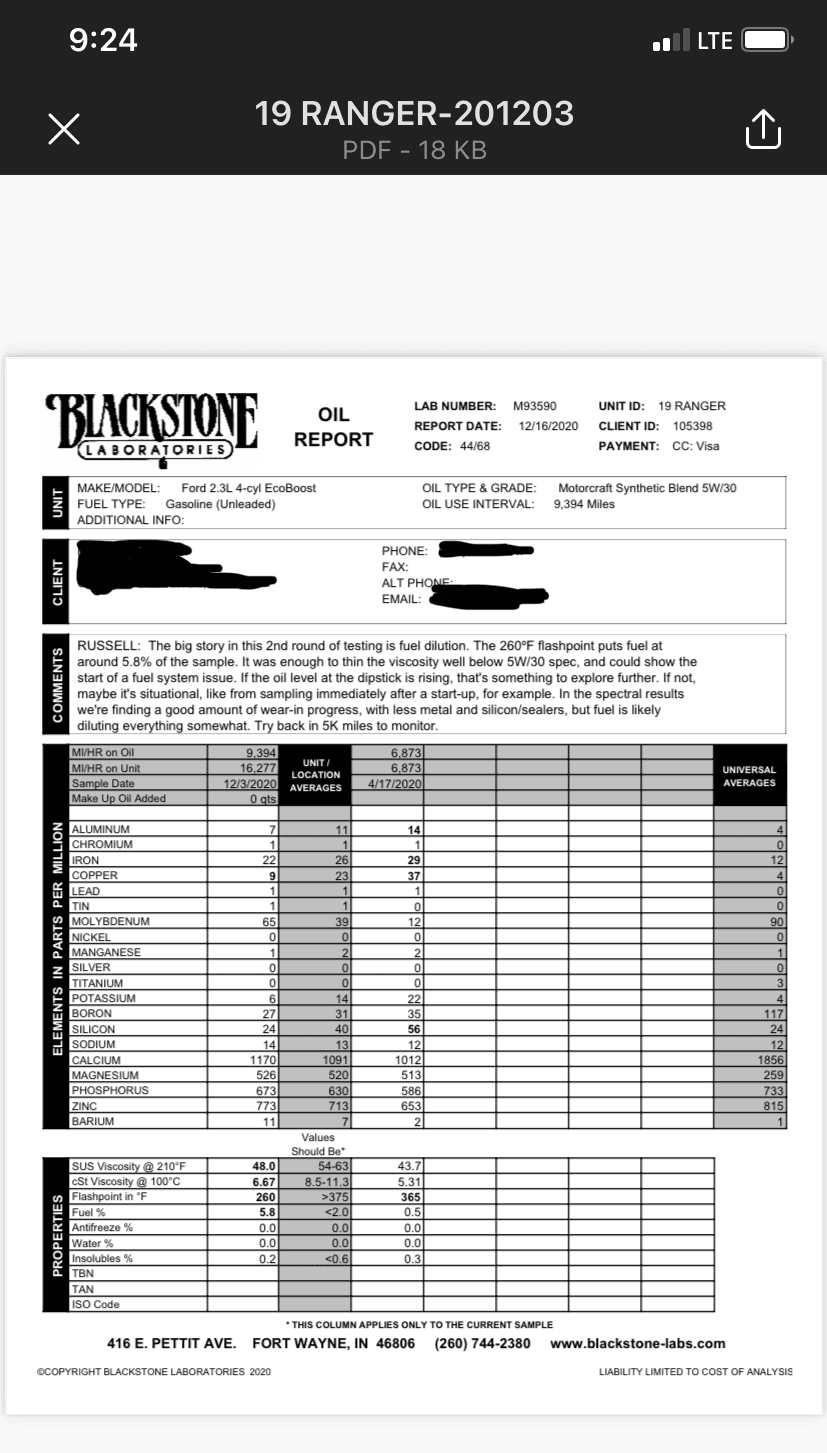

Ran to 5% on the OLM at just over 9000 miles. I had almost 6% fuel in my oil this time which they seem concerned about. I’m not sure if I care yet...

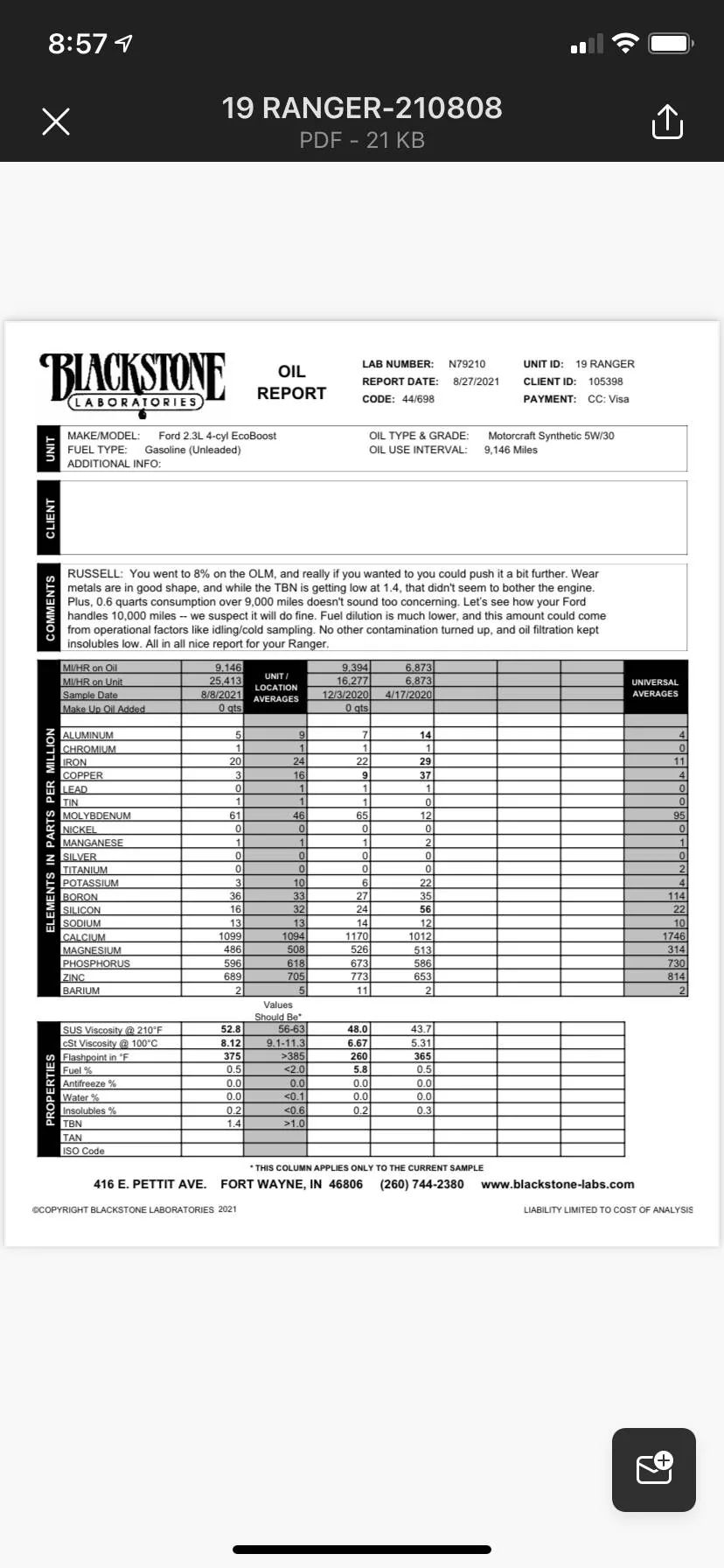

Ran the OLM to 8% on motorcraft full synthetic. TBN is still good and could have done the full 10k easy.
And this is with the FP tune K&N air filter, silicon is coming in LOWER than their universal averages for the 2.3T
And my fuel in oil is gone!

Good report! When was the last time your K&N was cleaned? Wondering if your silicon is lower due to a dirtier K&N that is letting less fine particulate through now in comparison to your first oil analysis where a clean K&N let more particulates leading for a 56 silicon level...

it was brand new for this OCI. I clean the filter, and rotate tires, around every oil change.

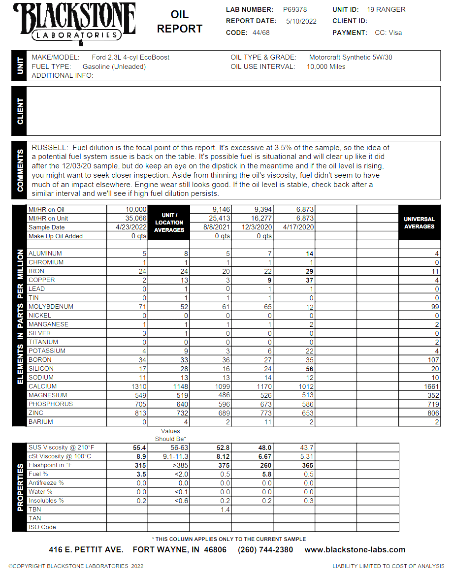

Ran to 3% on the OLM this time. It is very consistent getting fuel in oil over the cold winter months or very little fuel dilution in my 8-month OCI that spans warm months.

Thanks for sharing. With me being in Warmer climates it seems about to 10% on the OLM looks to be a good target to shoot for. I am going to change at 3K for my very first change.

Agree with the colder months and having more fuel dilution...
I got my first Blackstone report today. From October '21 to May '22, I put 2402 miles on the truck since it was new, I drive short distances to work/around town, I also couldn't get to normal operating temps (in the colder months), and most of the total miles were in the cooler/colder months of Alabama, so that's why I'm thinking my Fuel numbers were 4.3%? I was also running an Unleashed tune for about 4-5 of those months, that is no longer installed.
Blackstone noted that if it worsens, I may have a fuel issue? Pump/injector, but I thought all those issues were fixed before the 2021's were out? I think it's a normal TDI issue honestly?
Blackstone wants me to check back after 2500 additional miles, which I estimate should be September or October of this year. I have a feeling the Fuel % will be lower, since it gets to over 100 degrees in the Summer/Fall here!
They said everything else was normal for a new engine.
