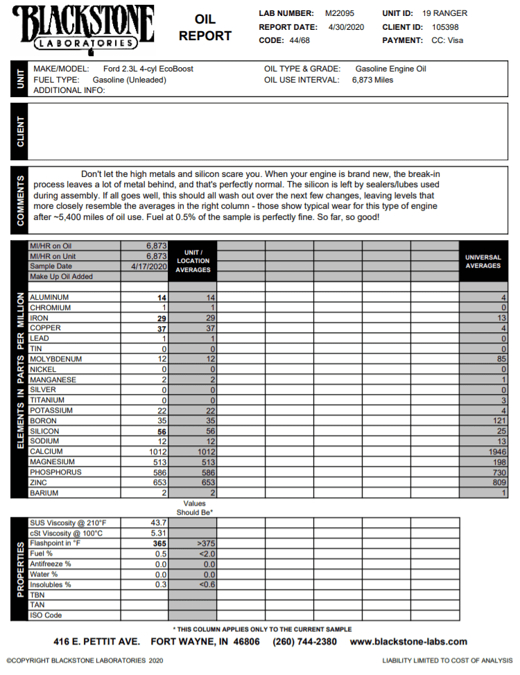

I had the dealer pull a sample for my first oil change to get a UOA. SO hopefully this oil actually came from my truck, hah!
No fuel in the oil like others have been afraid of. I didn't notice any smell the last time I checked it either. Usual break in wear it looks like. I had 30% life remaining on the OLM, tried to balance changing the factory fill early vs. recommended break in which does not require an early oil change.

Doesn't seem bad at all.

Awesome! Thanks for sharing.
