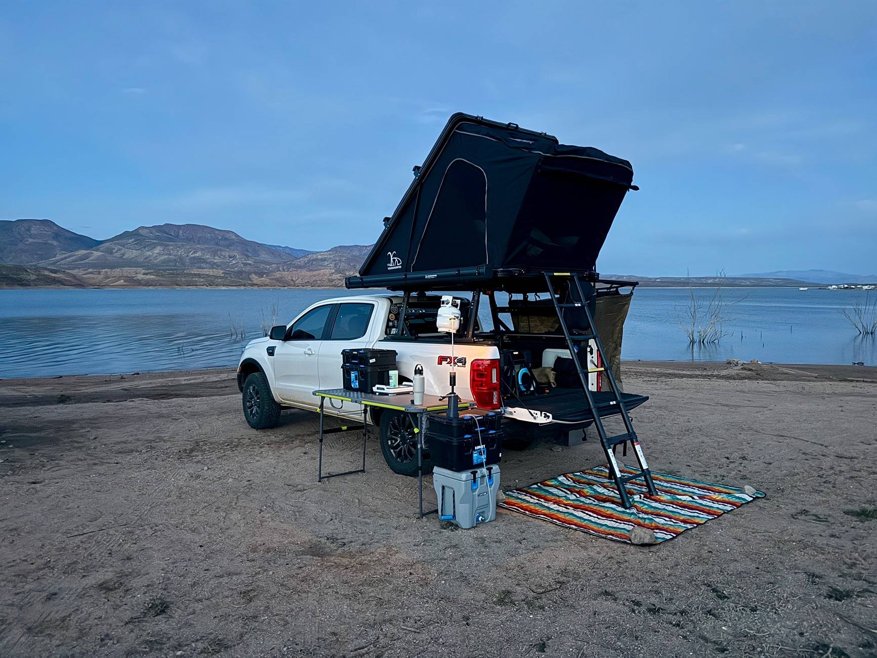

Have a front set of 5100s that I haven’t installed just yet and trying to decide if I should just stick with 5100 in the rear or go with Eibach non-reservoir shocks in the back.
Use case daily driver loaded with a rack and rooftop tent. Camp/wheel about twice a month. Nothing wild mostly lots of dirt roads with a few small obstacles.
Still have the stock FX4 and at almost 80k miles loaded for a weekend the rear end is very unsettled. We’re talking 3-4 bounces going over a freeway expansion joint.
I’ve heard the Eibach is a bit more compliant than the Bilstein in rear valving and that the Bilstein is better for towing/hauling than just about anything else in the entry level price range.
Anyone running the 5100 front/eibach rear setup and have any input?
Pic for attention.
