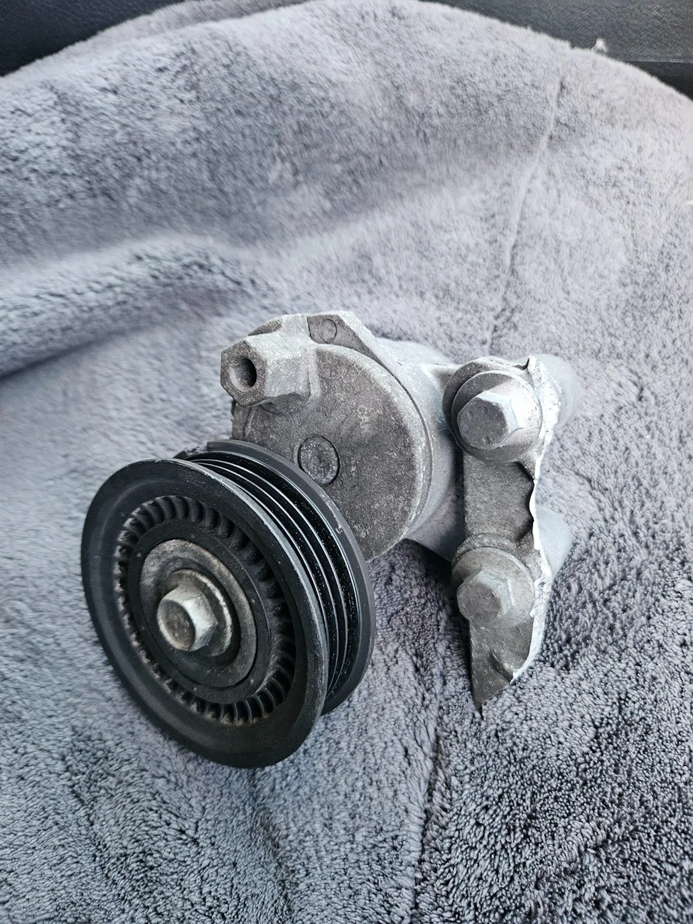

Belt Tensioner SNAPPED OFF

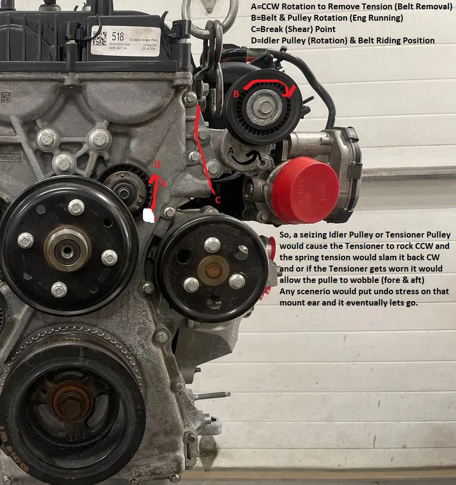

The BIG QUESTION remains - Is this a chain reaction event? Bad Tensioner / Bad Idler Pulley producing undo stress on the mount or is it strictly a total design / manufacturing flaw- either way this should not happen and needs to have a separate mounting bracket that is a simple replacement vs complete cover which is not a simple task, requiring special tooling to do it.
Or is it a combination of BOTH flaws that cause it to shear off.

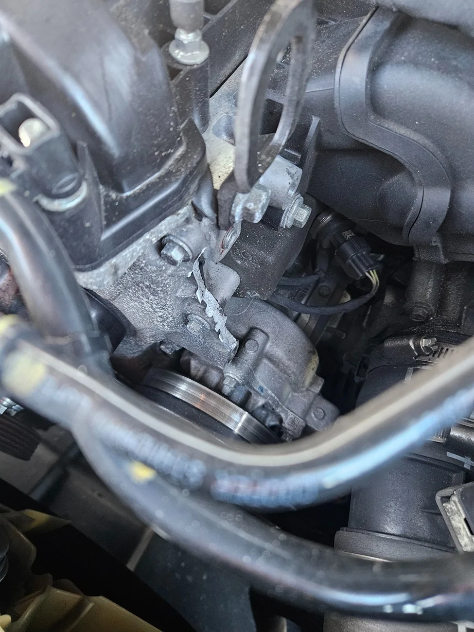

What peaked my interest was seeing other Ranger postings of their bracket snapped and they were literally identical breaks, which supports the fact that there must be a batch of bad castings. Only Ford will know how many castings came from this manufacturer and you know they are never going to admit how many and that it is something that they should be responsible for.

I honestly do not think it is bad castings. I think it is much more likely to be a weak casting design.
And I think either the pulley bearing is seizing or the tensioner spring is binding / breaking, resulting in sudden intense load being placed on the the casting.
Has anyone checked the bearing for roughness / wear, or spring tensioner to see if it still flexes?
The casting wouldn't be breaking unless there is undo catastrophic stress being applied somewhere.
I had the belt tensioner spring seize on my 2005 Ranger at 135K miles and it shredded / threw the belt. Replaced it and the belt and was on my way.
I had forgotten about this issue, but it is back on my list of things to check when changing the oil. We honestly should not have to perform preventative maintenance on these type of parts.
One last question... Are the failures limited to trucks in northern snow areas of the country where salt is used on the roads?

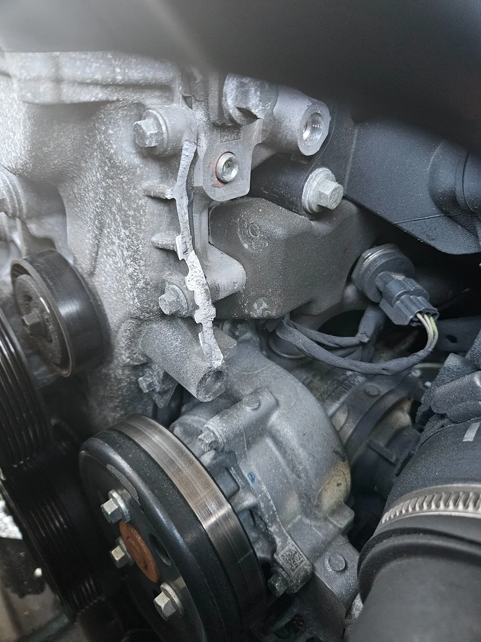

I have a 2021 Ford Ranger Lariat Tremor with 120k miles and just had the exact/identical belt tensioner bracket snap off as well. If you look at my pictures you can definitely tell it broke in the exact same place. This has to be a timing chain plate cover defect in the casting. I also put in a ticket to the Ford Customer Experience Specialist for Ford to take a closer look at these issues. FYI... The cost to fix this Ford manufacturer casting defect is $4k.

It could be due to bad design and still be a bad casting. If you look at the photos I took and photos of other's in this thread that had the same issue, you would see the break is identical. you could literally take the belt tensioner bracket that broke off and put in against where it broke on the other Ranger and it would fix perfectly. Both belts on my Ranger had zero shredding or tears. The serpentine belt was twisted from where it wrapped around the fan, but other than that it was fine. I got lucky that the broken off tensioner did not sling off and destroy more within the engine compartment. If it was not for the front skid plate it would have probably fell onto the highway.
