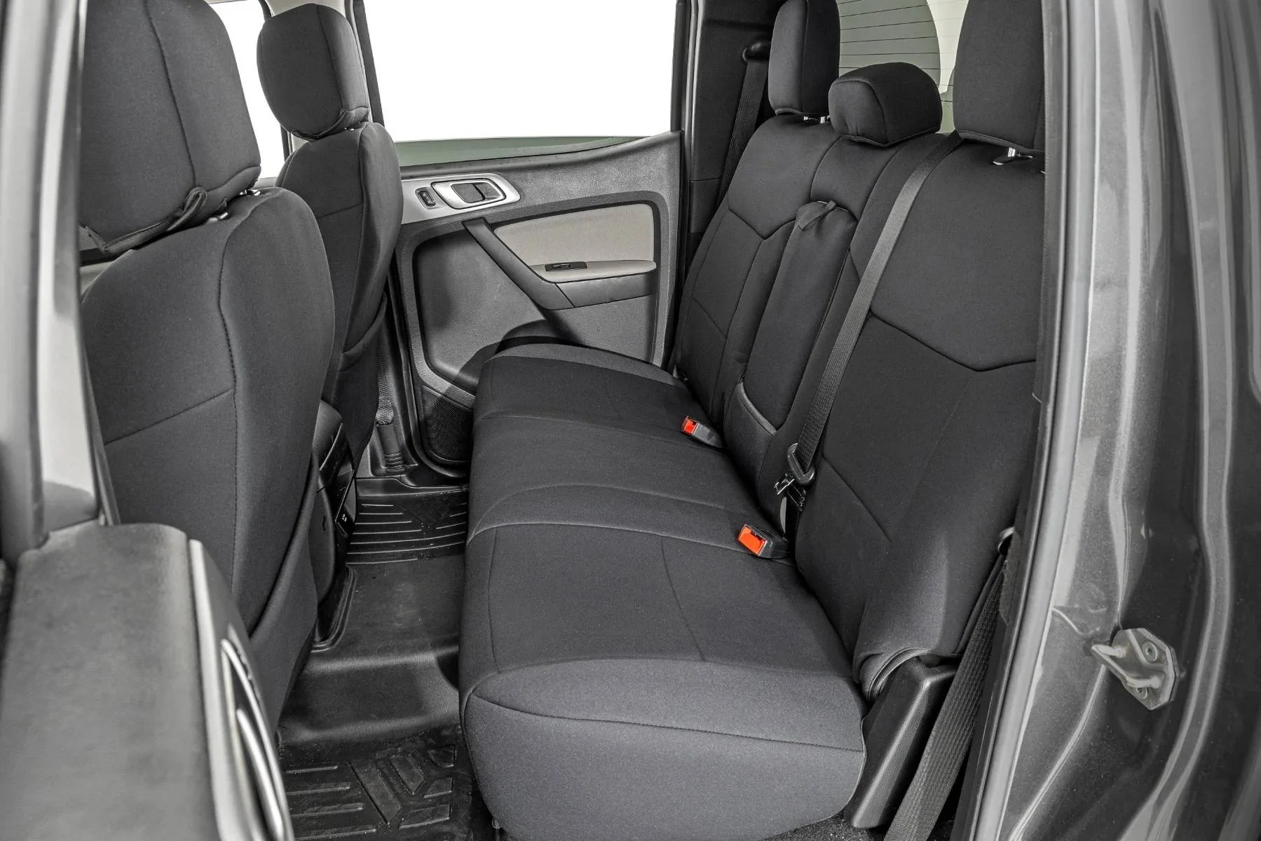

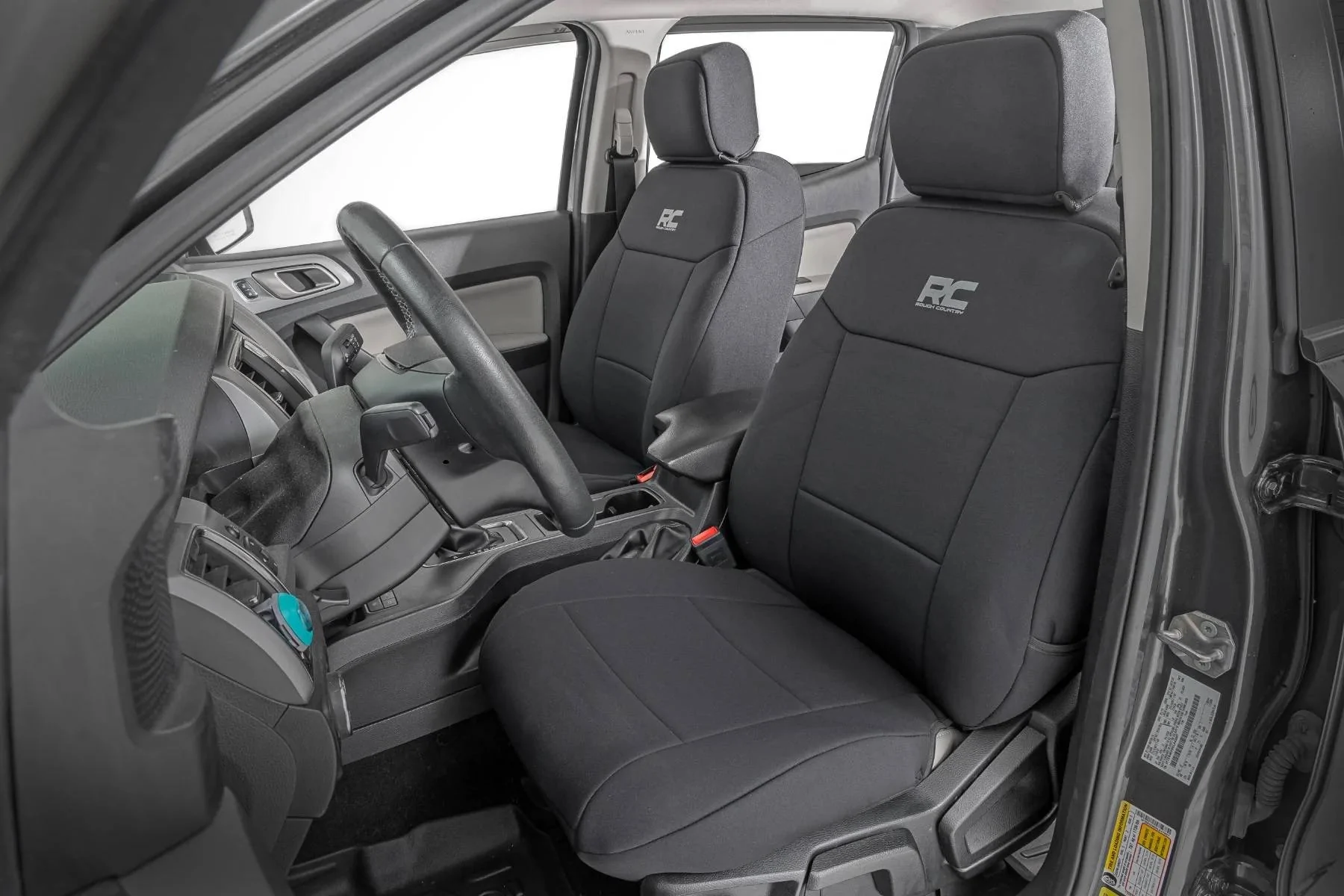

Been giving the seats some more thought and might go a different direction than leather. Since this truck was intended for more off-road use, mainly desert roads and trails, I might just go with more "working man" seat covers, like these from Rough Country that appear to have excellent reviews. At least that's the thought for today.
Honestly I've been bleeding cash on this thing long enough. Just the windshield, Rhino Lining and now a drive shaft have pretty much depleted the rest of the budget for the thing. Time to slow the roll.

Those don't look bad...if they Indeed will fit that well.

Nice !
