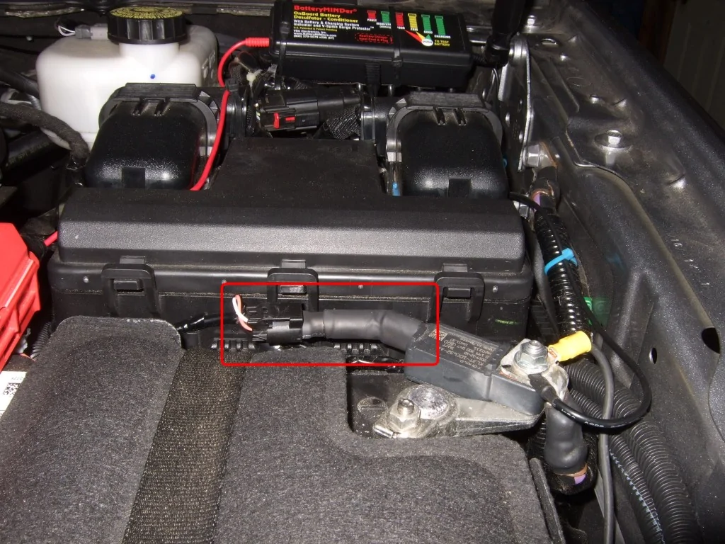

Do you have a picture of which plug it is?
TJC
Aug 28, 2020
47
4,196
10,789
It is the BMS sensor plug on the negative battery terminal. It plugs in much closer to the neg battery terminal than what is pictured in the red square. I just made a simple dummy extension to keep the contacts clean when it is not plugged in... and the one in the picture is NOT plugged in to anything. It is heatshrink over a piece of hose.
