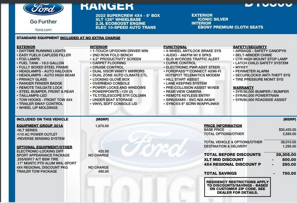

I didn't want to start a whole new thread, but I'm wondering where my ASS is...
Haven't received truck, just put deposit down, I don't see the $50 credit they give since they stopped being included, but I don't see the feature listed on the sticker either...
Will I have ASS? I'm a big fan of ASS and I cant find my ASS right now and am just a little confused.
I'm pretty sure the ASS delete is optional and only by request. If you didn't ask for it, you are still getting it (and potentially waiting for related components).
Apparently my truck was built on March 17th and has been waiting around ever since. Its been shipped but hasnt arrived at the dealer yet and it seems to have the ASS. So, I hope it doesnt hurt the truck too much that it just sat there for a couple months.
I know your pain. Mine was built early August 2021 and I got it 10/28/21. Sat at MAP waiting for the instrument cluster. And then Ford forgot about it until I harassed them on Twitter once I saw people here getting trucks ordered after mine was parked in the lot of shame. The only issue I had from it sitting was film all over the inside from the plastics off-gassing (windshield was particularly hard to clean) and the battery took several weeks to get itself sorted after sitting that long without a proper charge.

The sticker for my '19 lists "auto start stop tech" under "functional".
Interesting. Seems they removed all trace of it, except when it isn't included. I'd say this change happened around the end of March or so.
