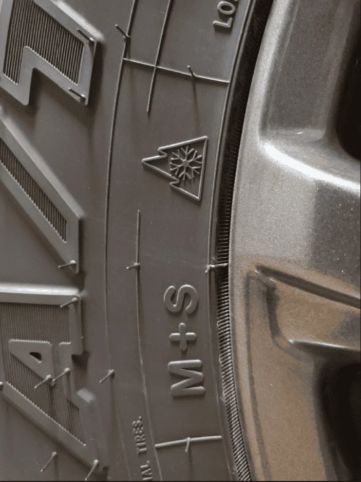

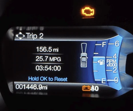

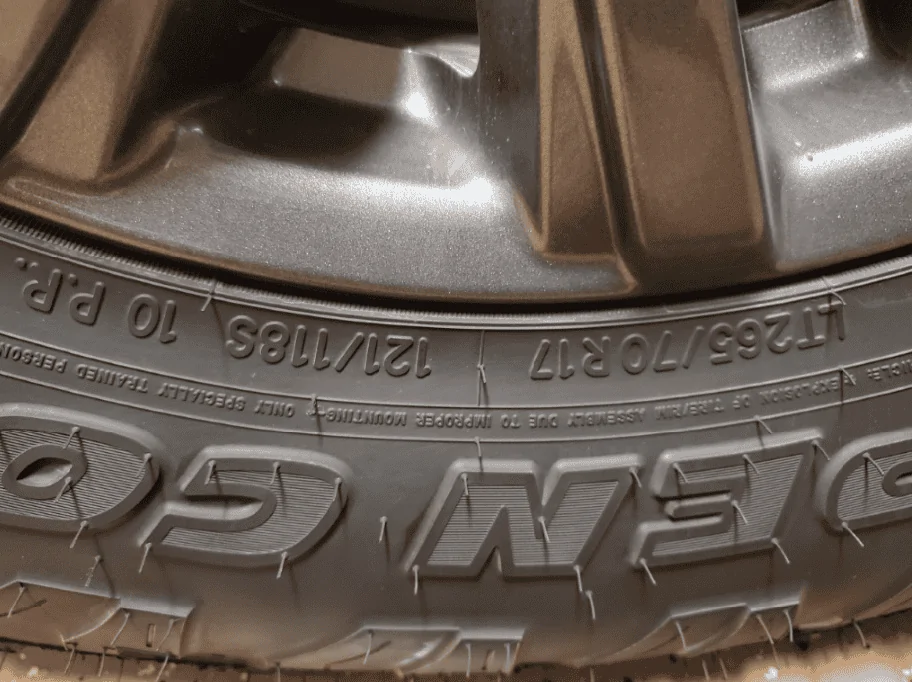

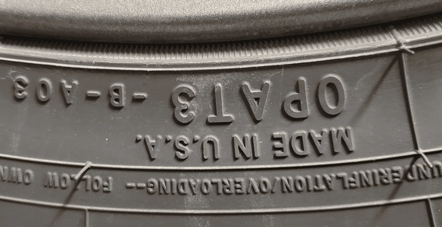

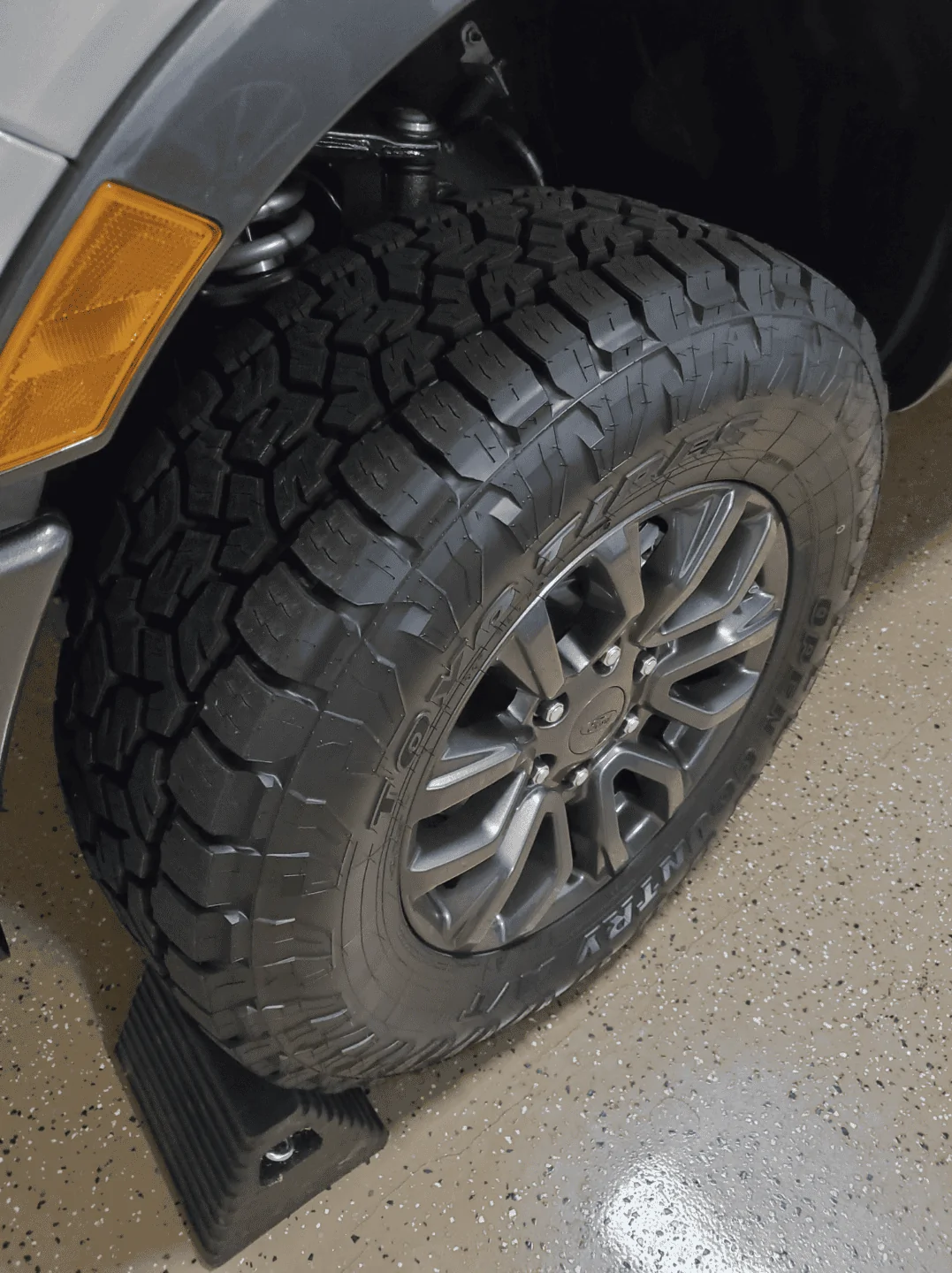

After our stock tires wore out on our '94 Jeep ZJ , we ran various LT tires until 2018. Never had a flat. Heavier, and slightly more clunky on bumps which likely reduced the life of rubber suspension bushings. I installed poly bushings on everything which further reduced cushioning.
Prior to delivery (7/2020) of our 2020 Ranger, we had our dealer install the FP/Fox Leveling kit and these tires.
Toyo Open Country A/T III LT265/70R17E 121S 10PR
MADE IN USA :flag:
https://www.toyotires.com/product/open-country-at3
Our truck is normally not loaded (never heavily) and never pulling a trailer. Mileage is just over 8K as we have not taken long trips and our Ranger is not our daily driver.
Toyo Tire has Load & Inflation Tables for determining correct pressure.
https://www.toyotires.com/tires-101/tire-load-and-inflation-tables
We normally run 37 PSI except off-road where we air down as far as 18 PSI, depending on conditions.
We purchased these tires for mild off-road performance, traction, durability, and dependability. We also have a matching spare tire/wheel. Being M+S and 3-peaks rated, extra traction is a bonus.
Very little road noise.
Our mileage is good, but not always easy to gauge when we're doing more off-roading. Seldom check anymore. Best was a road trip on country two-lane roads driving 55-65 MPH.
These tires are heavier and stiffer than stock Hankooks. Firmer over dips and bumps. Bad road seams and holes are a bit more "clunky" and a bit more bouncy when unloaded.
No regrets, they're great for our use.
