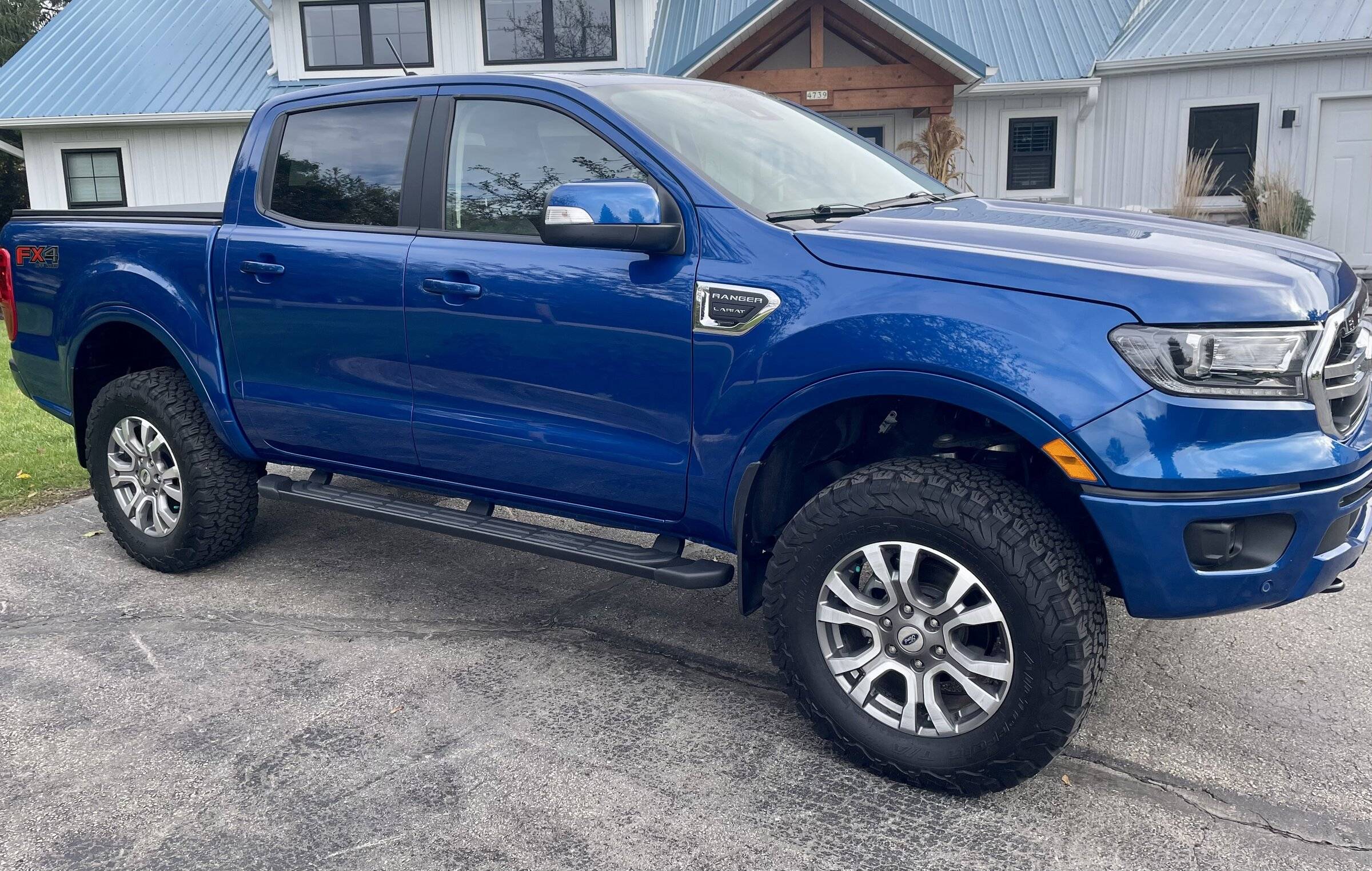

Tires, Wheels and spacers are currently for sale on the marketplace section: 3" Fox Level and 1.5" wheel spacers Nitto 275/65/18.

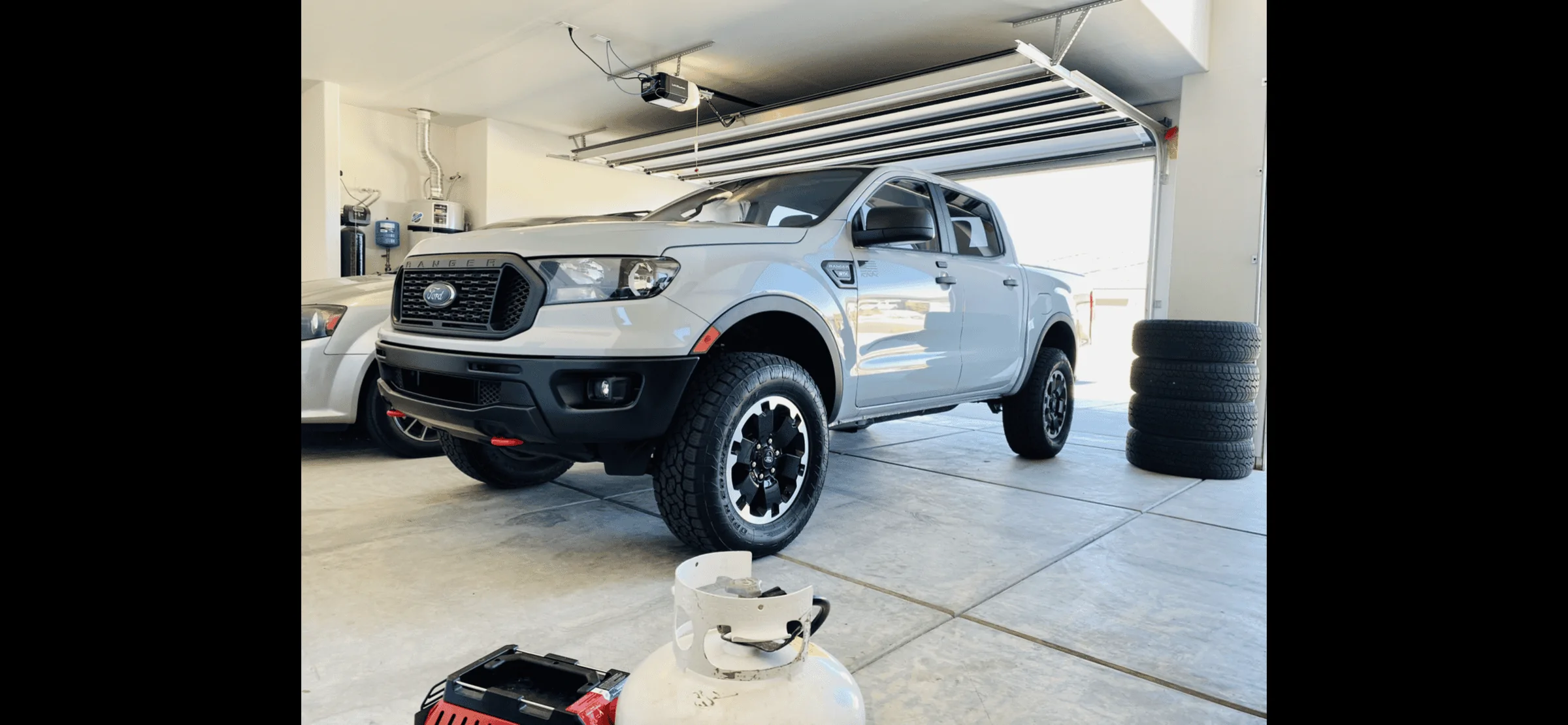

Here is my Truck with the STX package. 18” wheels. I’m running 275/65R18 with fox 2.0 coil overs (brought it up only 1”ish). I’m running bora 1” spacers. I had to remove my crash bars and the front air dam things in front of the wheels. I just unbolted the crash bars so I can reinstall if needed. You do have to do a partial disassembly with the front bumper to get them to slide out otherwise it’s just 2 bolts on each side.
