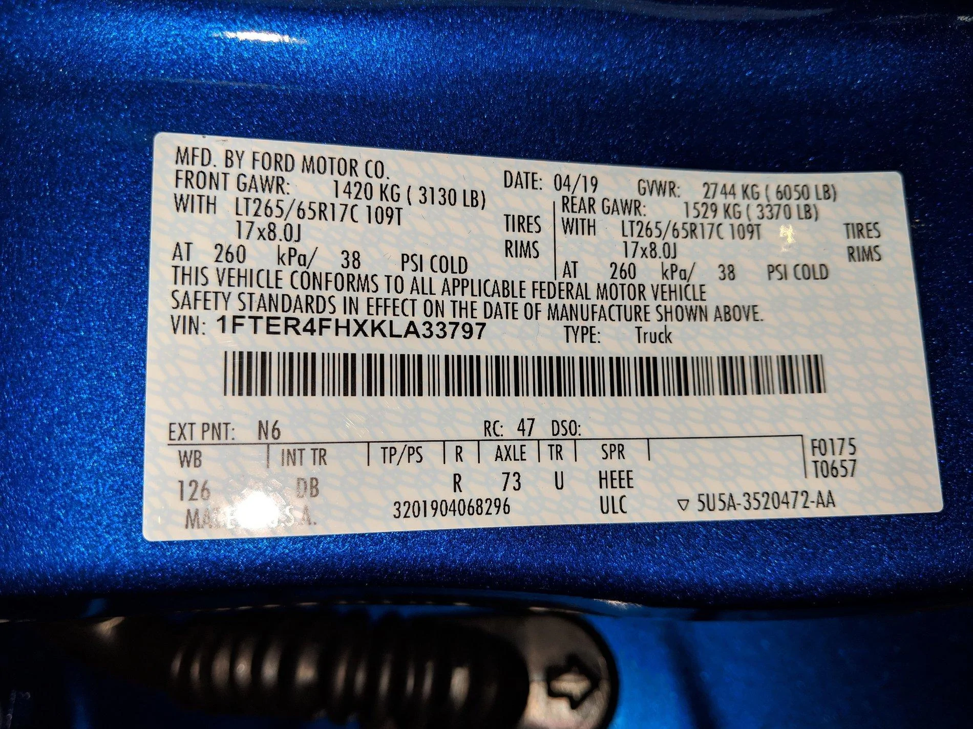

Can someone post a picture for the factory ordered door sticker (tire specs, GVWR, etc.) for LT265/65R17 A/T OWL tires?
gfitzge2
Gregg
Nov 7, 2018
1,235
7,011
Louisville, Kentucky
2016 Focus RS, 2019 Ranger, 2021 Mustang Mach 1
Retired Electrician

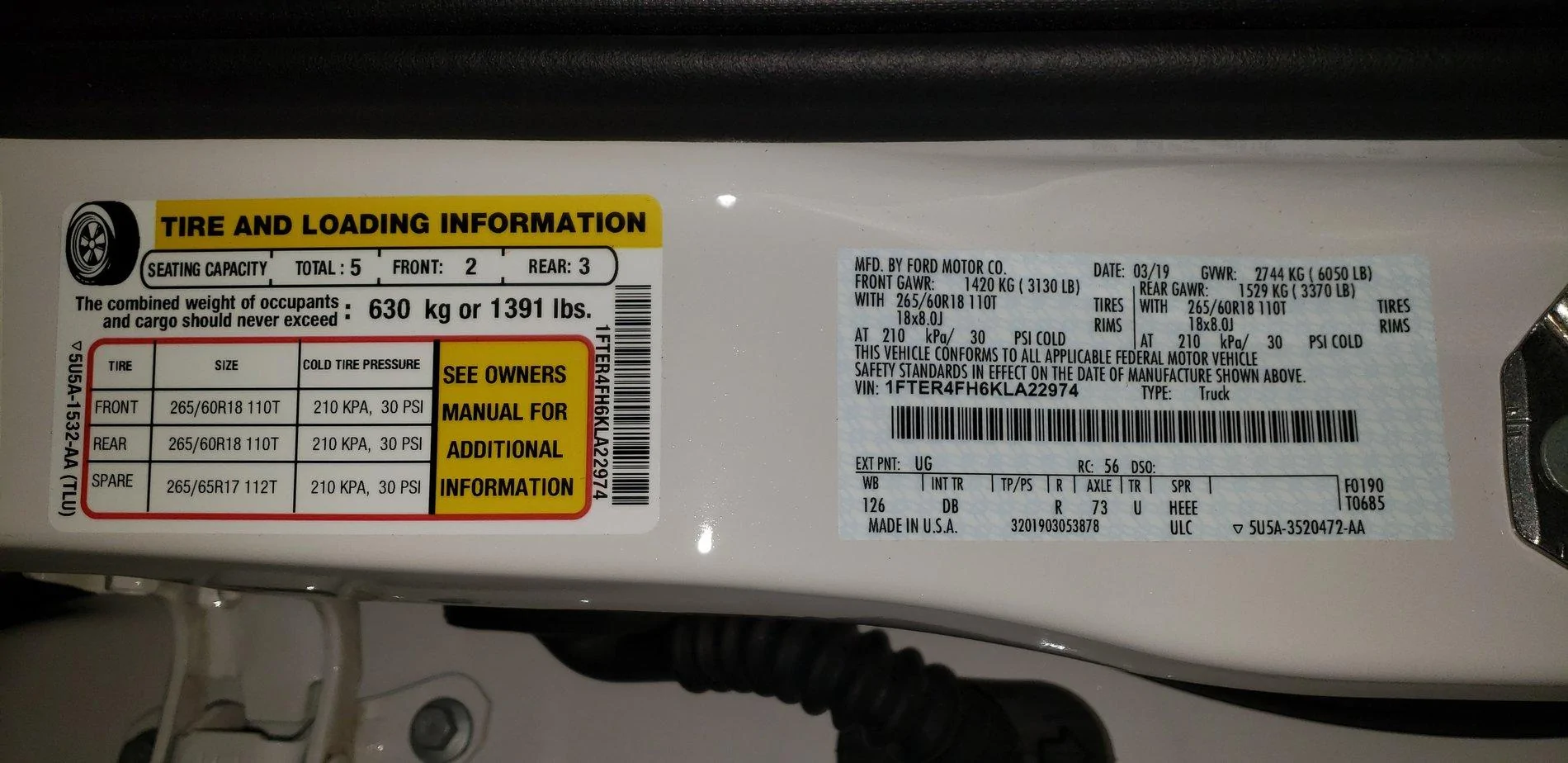

Thanks, here's this with P 18s for comparison

Nothing is different that I see besides 30 psi vs. 38 psi cold. No ratings change. For some reason this surprises me. Why run LTs, and why is it an option, then?
Some people would rather trade a more durable tire for a harsher ride. It probably only matters if the truck spends most of its time near max load.

Understand, I'm looking for ways to quantify it. It seems that payload and everything else is unchanged on paper.
LT tires aren't going to increase the load capacity of the ranger, it's not a heavy enough truck to require LT tires. Some people may prefer LT tires based on how they use the truck, but that's it--personal preference. You don't really need LT tires even on a full size pickup until you're into the 3/4 ton or 1 ton categories. So there really isn't anything to "quantify". If you want maybe longer tire life if you always have the truck loaded and you're running on crappy roads, and you're willing to sacrifice ride quality and possibly other attributes like handling in wet conditions, get the LT tires. If you want better ride quality and rarely or never carry a load or tow in rough terrain, get the P tires. The differences here are not going to be huge: at a GVWR of only 6k pounds it's not going to really stress any tires like a 10k or 14k pound truck would.
