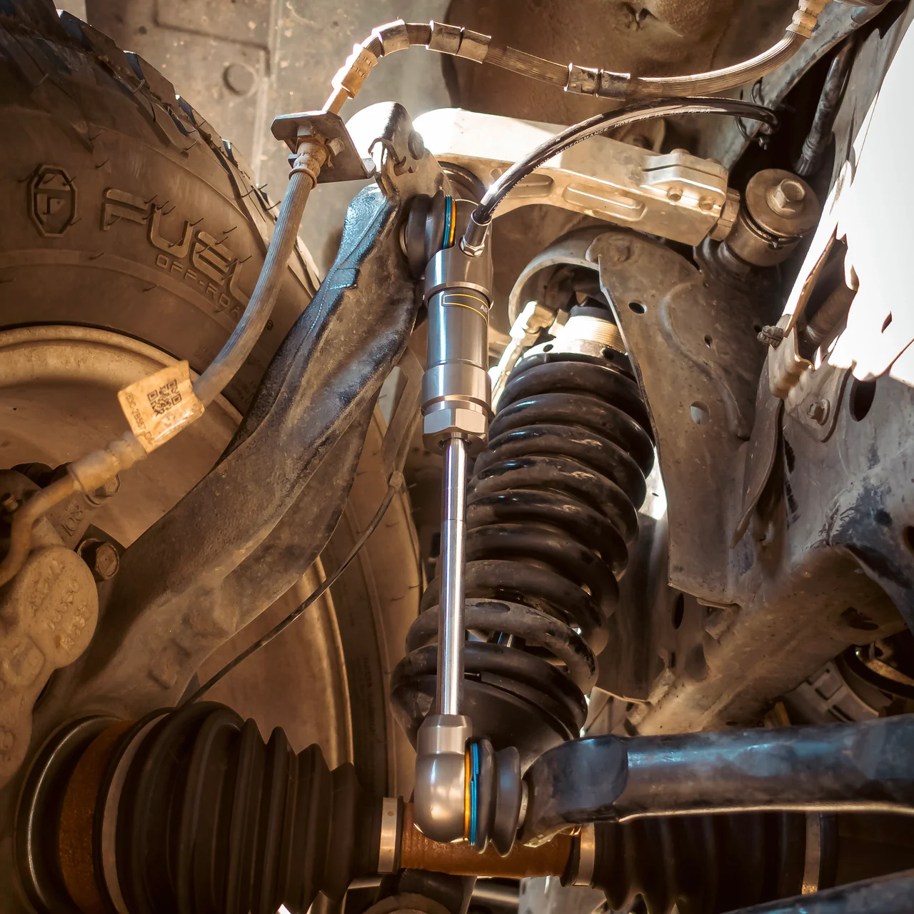

Anyone running airlynx? Looking for feedback

Didn’t even know those exist! I like the concept but would hate to have to inflate that at the end of a run when it’s 100 out. For me it would be a 0 PSI or 150 PSI so would rather just see a lockout like a mountain bike fork has. You could then run a remote lockout to the cab.

Looking at the videos and instructions, it is just a couple of pumps with a bicycle pump. With the remote fills, it should take about a minute.

More of an alternative to removing the sway bar completely or disconnects for off-road. Instructions say to check pressure every month. Wondering what real life pressure loss is like.

" I have them on my JKU. I started with the stock stock bar and they helped a ton to help dial out head-toss without giving up highway performance. While they won't have the travel of a traditional disconnect off-road, that isn't always a bad thing. I liked them so much I carried them over to my AntiRock setup, and that allowed me to use the next larger bar diameter to help with higher speed twisty highway here in the mountian west. The unique thing is that they are not only adjustable for rate, they are also progressive because of the small charge volume. "

Sounds like they work pretty well based on that Jeep guy's feedback, but checking pressure every month seems like a pain compared to just hitting a disconnect switch.

Thanks for the info. I'm getting ready to pull the trigger. I'm so tired of pulling in my driveway and having my head fly all over the place. I happen to have a drive entry with the roll curb and its aggressive. A C8 would never make it in.
