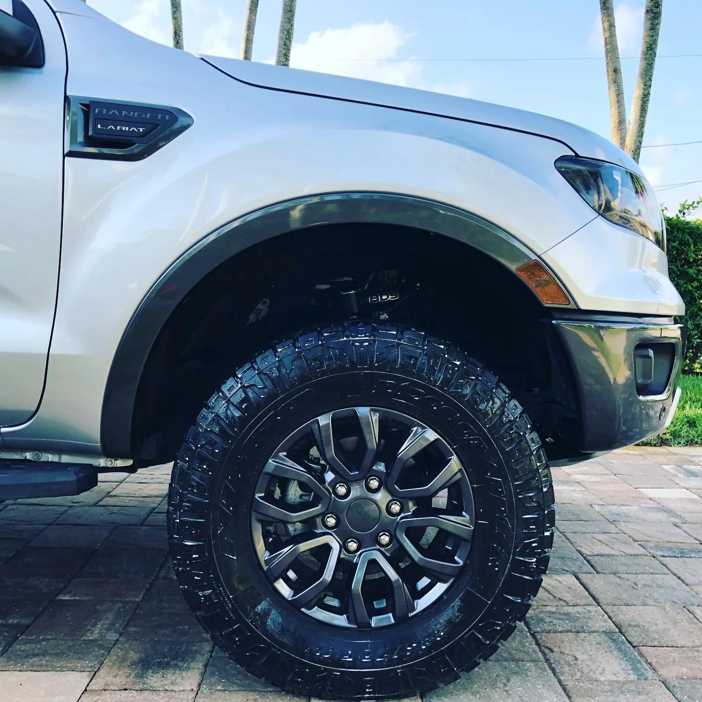

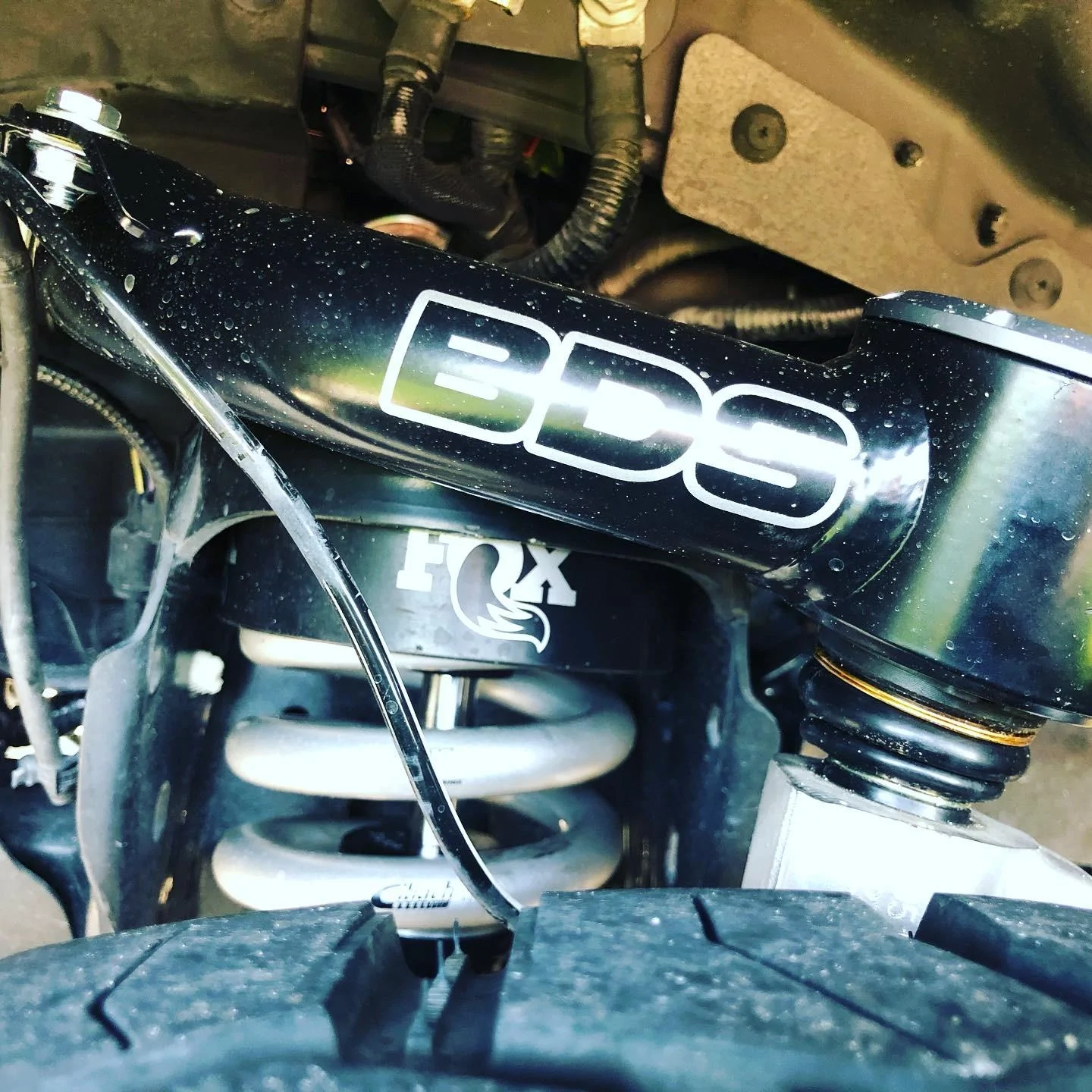

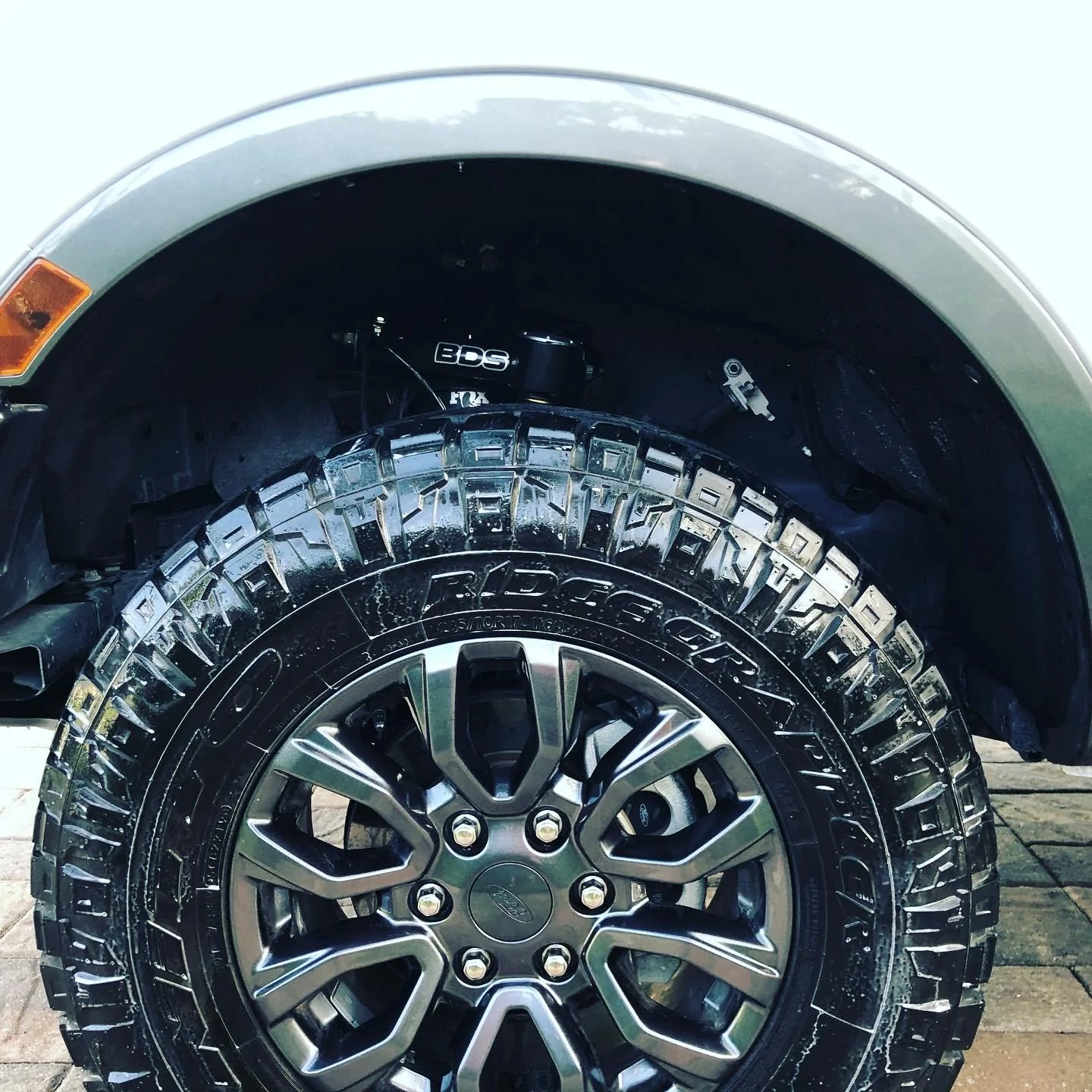

Being a fellow Michigander, I balked at the Machined UCAs that some offer. After speaking with BDS I ordered theirs. BDS is a Michigan based company that does really thorough development. The upper balls on their tubular arms are sealed and replaceable which makes them more tolerant of Michigan winter conditions (read: Salt!).
The other thing that attracted me to BDS was their view of the vehicle as a system. With their 3.5" lifts they also developed a small differential spacer that eases the angles on the drive shaft. That thorough level of development gave me the trust in them I needed to order.

Thanks for the Input Tom. I am really starting to lean toward these BDS UCA's. I really would like to drop the front diff as well. I was really hopping that someone would have come out with a stand alone kit to do so (to make my CV's a little happier). I like that they use an off the shelf Moog ball joint as well. It may not be a fancy as the other marketing terms I see thrown around though "wink wink....". I like that you could just get a Moog P/N and walk into a parts store or Summit Racing to have a ball joint next day (worst case scenario).

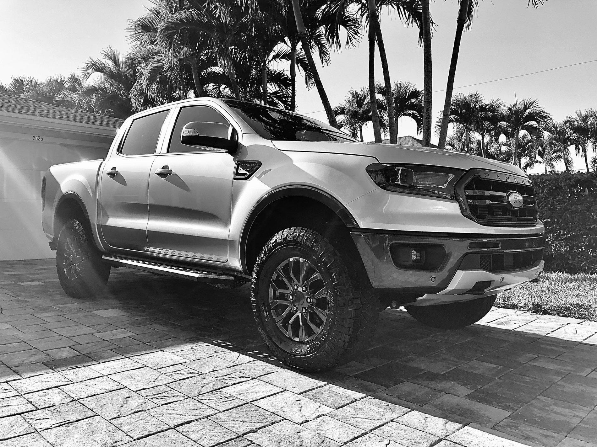

I agree on the 17s. I’m running 285/70/17

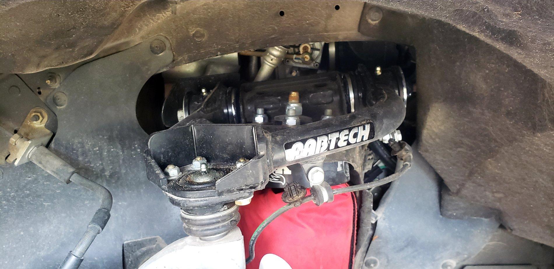

Update on the Fabtech UCA's.....
They've been working out well. The truck handles so much better at speed and through turns. Much less body roll compared to the stock UCA's and the lower control arms pushed way out (to attempt to get the camber in spec). The truck just feels planted and totally predictable now. No weird bump steer or squirm over bridge/highway thresholds. I'm running Fox 2.0's set at 2.75" of lift.
