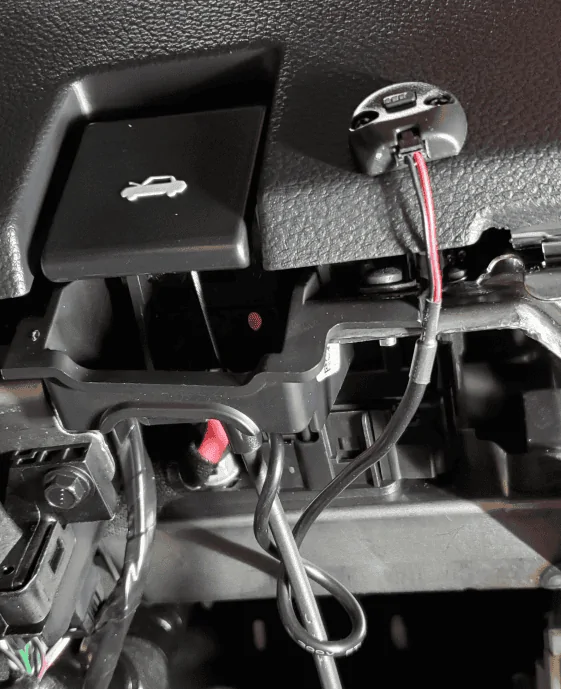

Anyone know what this button is for?

many dealers do this crap and pass on the fee to the customer. they are actually double dipping it. they get paid to put those in. if it is a berkshire hathaway dealership one way or other your car comes with one. a way of thinking of it = if you are a cash buy or finance outside of the dealership then NO tracking add on crap should be on the car. if it is the dealer sold you a damaged unit. holes put in dash factory wiring chopped spliced and wrapped around moving parts...

We special ordered with the very first specific instructions to not install any dealer added BS. They did it all... security, etched glass, nitrogen filled tires, etc.
Security device was the same as yours and drilled into the lower panel. Wires wrapped around the hood cable. Sales blamed service while service blamed sales.
We didn't pay for any of it and had them remove the security crap and replace the panel. We did get to keep the cute little green valve stem caps. :rolleyes: Nitrogen did not last through many airing downs.

Sadly that sort of added crap is pretty common.
Many Dealers pay some wrench potato piecework to install so obviously its not going to be nicely done.
At this point damage has been done and aside from quality repair job, pretty much nothing can be done to restore as oem wiring harness.
At least where the wiring is molested, Its dry and low vibration area.
Btw,
You might inspect a bit further for other molestations or add on's.
You may find a hidden GPS tracker/ disabler too.
Dealers are known to install those things to benefit to the Financing Agency.

If the vehicle wasn't financed, they just dont monitor it. But its still connected hidden in the car drawing power and its crappy wiring connections waiting for that fateful day.

You might want to check how they spliced into the factory wiring before you let them off the hook. Some people have posted pictures of hack jobs that look like I did it.
