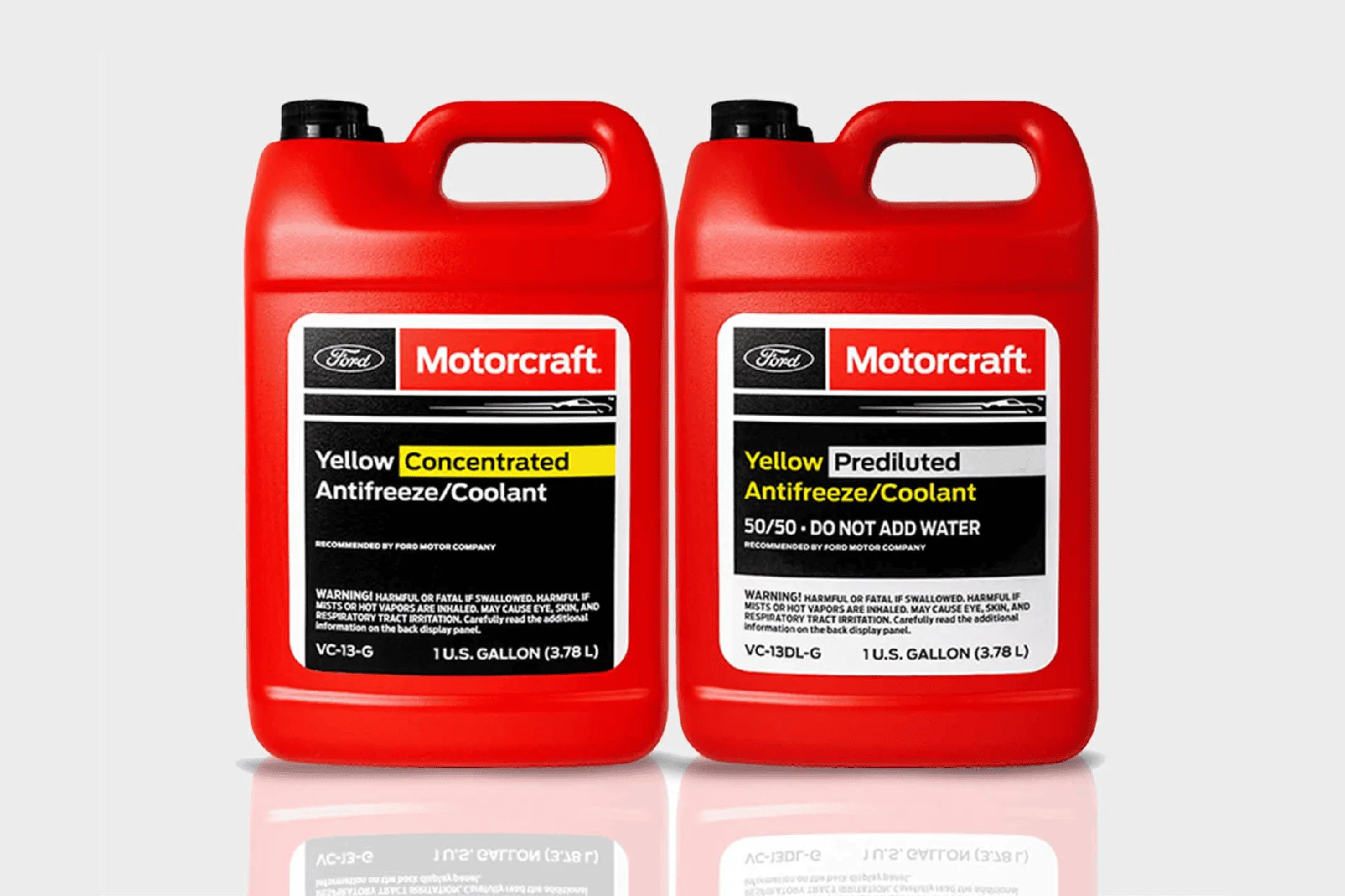

My dumb question (please be gentle), what type of coolant should I use for my early 22 Ranger? The coolant color in the reservoir looks light lime color. Bought the truck in Texas but where I live now temp often goes -10℉. Should I use full concentration or diluted? Thanks in advance.
Anyone feel free to correct me if I'm wrong but i believe the 22 Ranger uses Ford yellow coolant like my 19 does.
I would go to the dealership and buy the prediluted ( the one on the right)if you're not very confident in your mechanical abilities yet. No need to mix.
