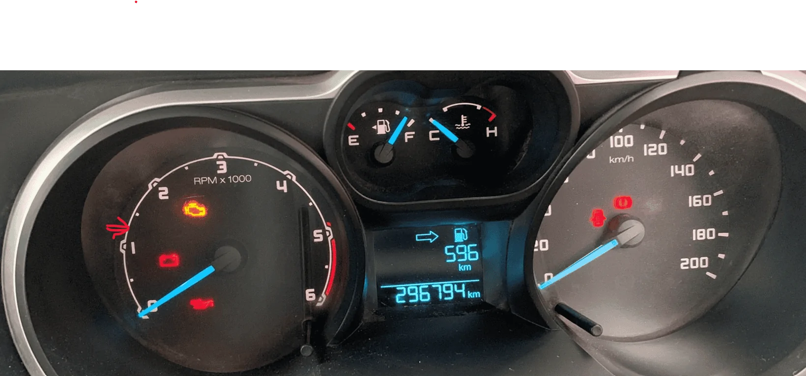

Hi all, Im in Australia and have a pk 2012 ranger 4x4 with the 3.2 turbo diesel, not sure if you have this engine in your rangers, I have a lugging issue with my 6 speed manual , the engine will vibrate /lug at 1200 rpm , typically when I shift to third gear, its not tail shaft or engine mounts, have removed the tail shaft and driven it in 4x4 so its engine gear box/clutch related I think .
Quite annoying as I don't always want to down shift to second at round abouts , big wide corners as this gear is too low.
it will also do it in fourth gear if i let the rpm decay to 12/1300 rpm and then accelerate, the issue disappears at 1500 rpm, is this normal? ,
I have replaced both engine mounts and the trans mount is good, changed the trans fluid .
Any ideas?
