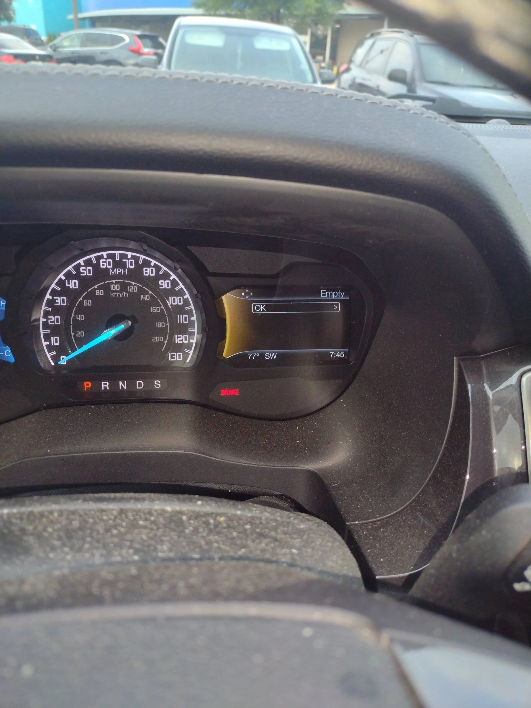

Is anyone having trouble with call history on the right-hand screen of the dash? I used to be able to see actual calls listed under the Phone menu. All Calls, Incoming Calls, Missed Calls, etc.
As of a couple months ago, whenever I try to go through my call history via the dash screen, I just get "OK" as the only option.

Can you get a picture of this right side of the screen call history? With my AA the recent calls works fine, but its more of a full screen interface. It sounds like you are expecting information in the Sync menus while using AA, that is not how it was intended to work. But, perhaps I'm misunderstanding and your photo will clarify that for me.

@ControlNode, this is what I see.
This if from using the right-side selector on the steering wheel, selecting Phone (not Entertainment or Nav).
Then All Calls, Missed Calls, Incoming Calls... All those selections show this same blank screen.

Ah, ok. Lariat only feature with that fancy gauge cluster. My XLT has the basic cluster. Just use the AA interface on the infotainment display. I think for that gauge cluster screen to work you need the phone connected as BT without the AA connection.
Got a screaming great deal on the Lariat. Honestly didn't even compare options with other trims.
Good to know this is a Lariat upgrade.
I'll try BT only and see if the cluster does anything different
