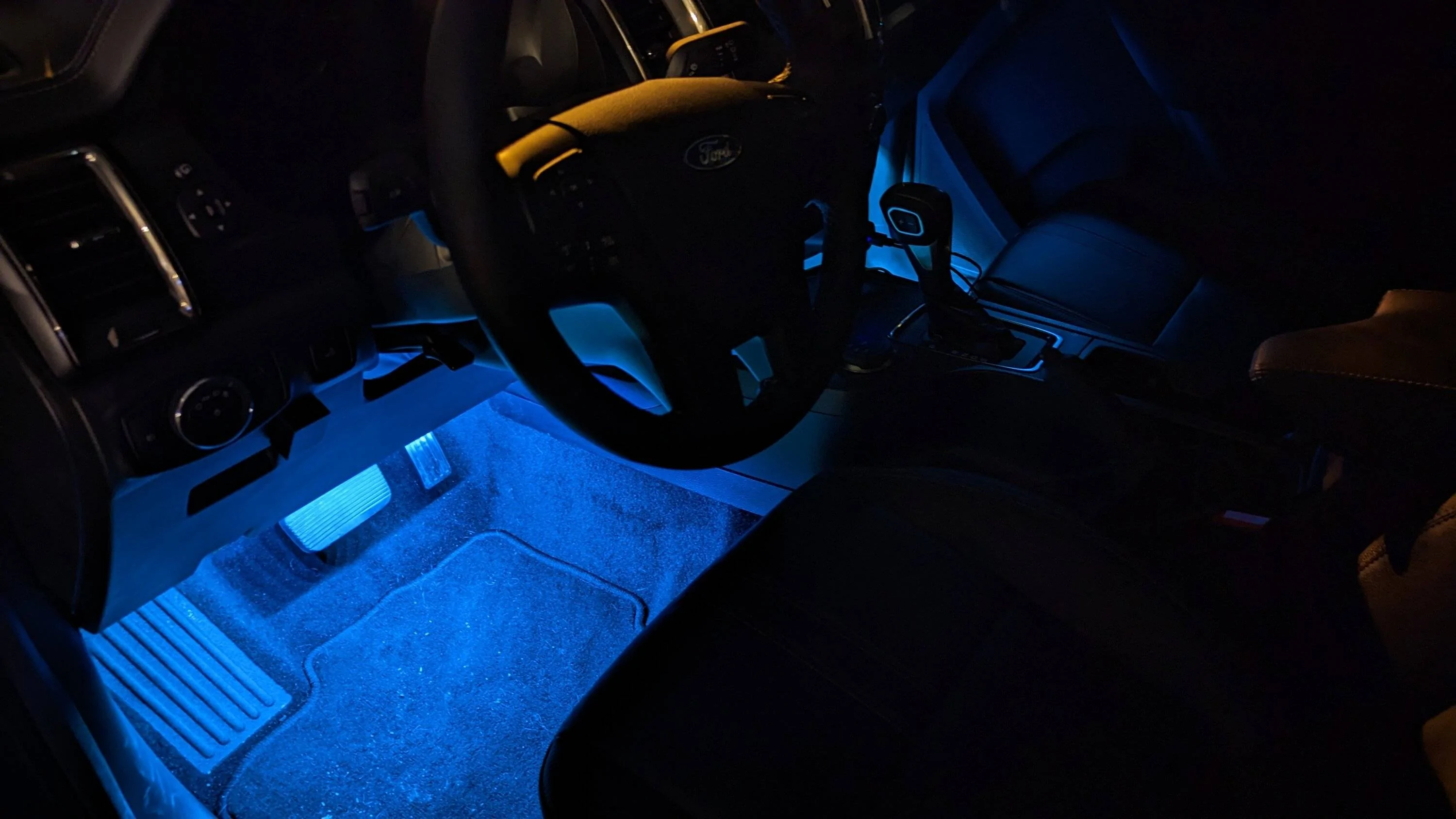

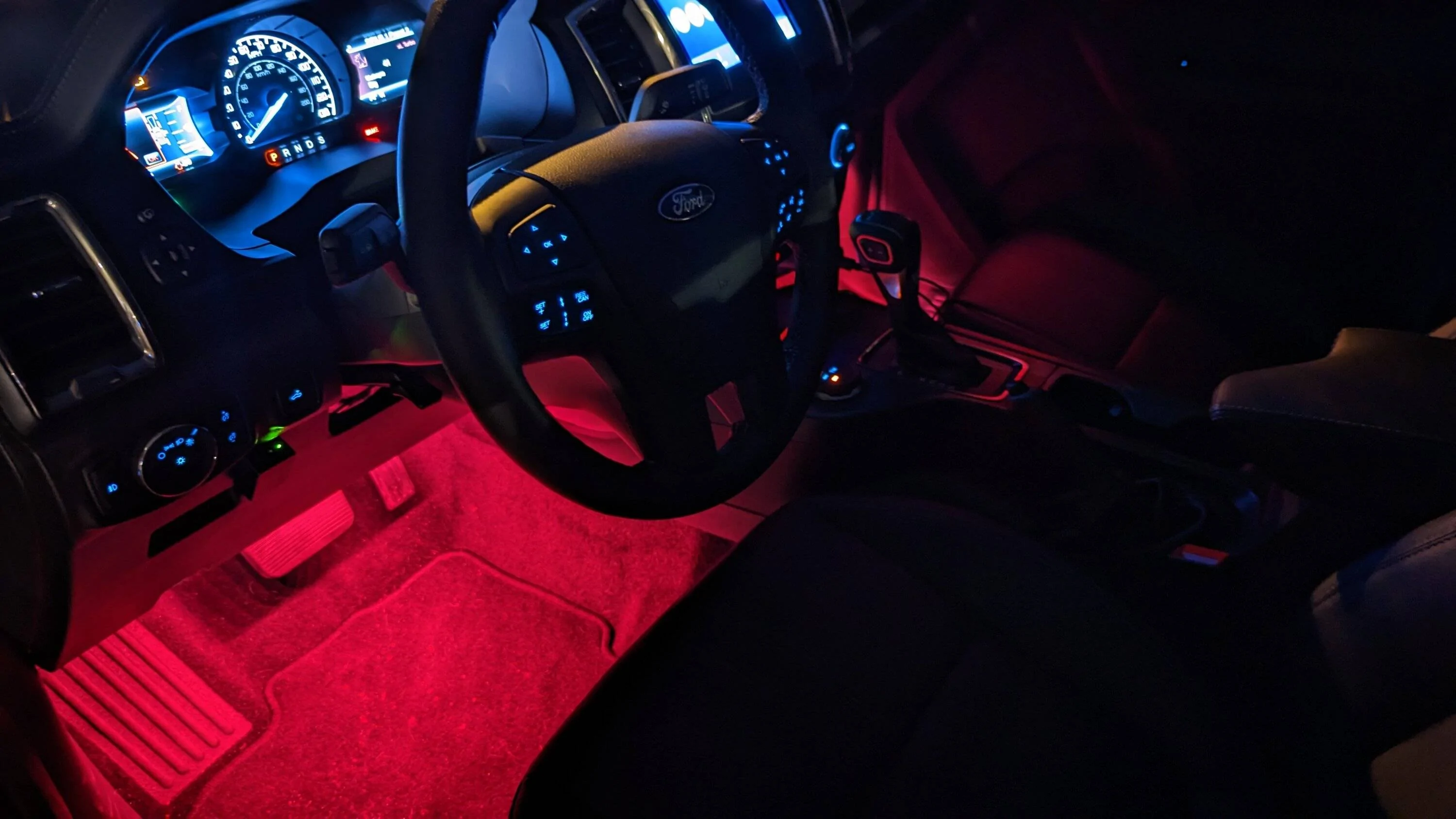

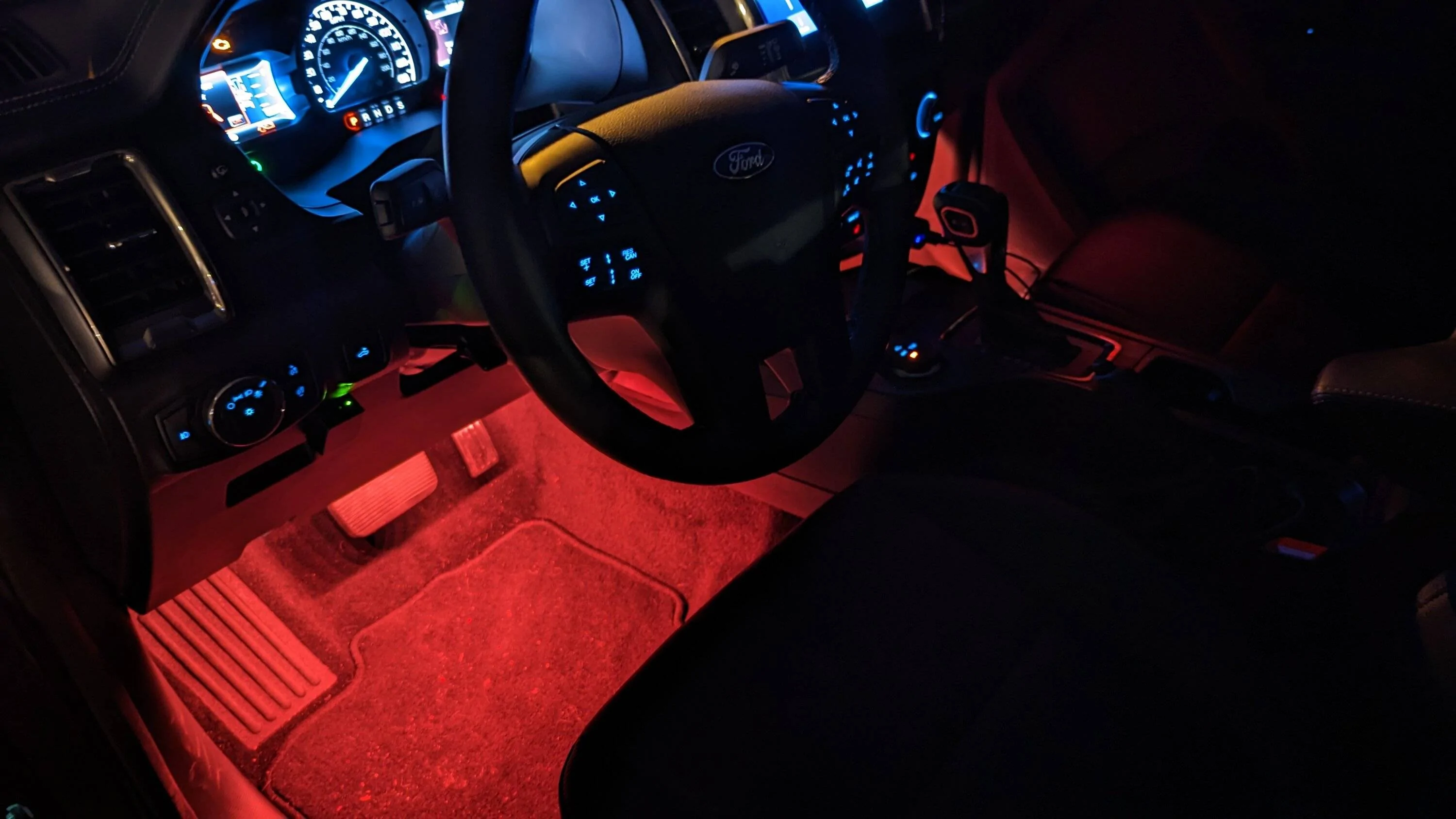

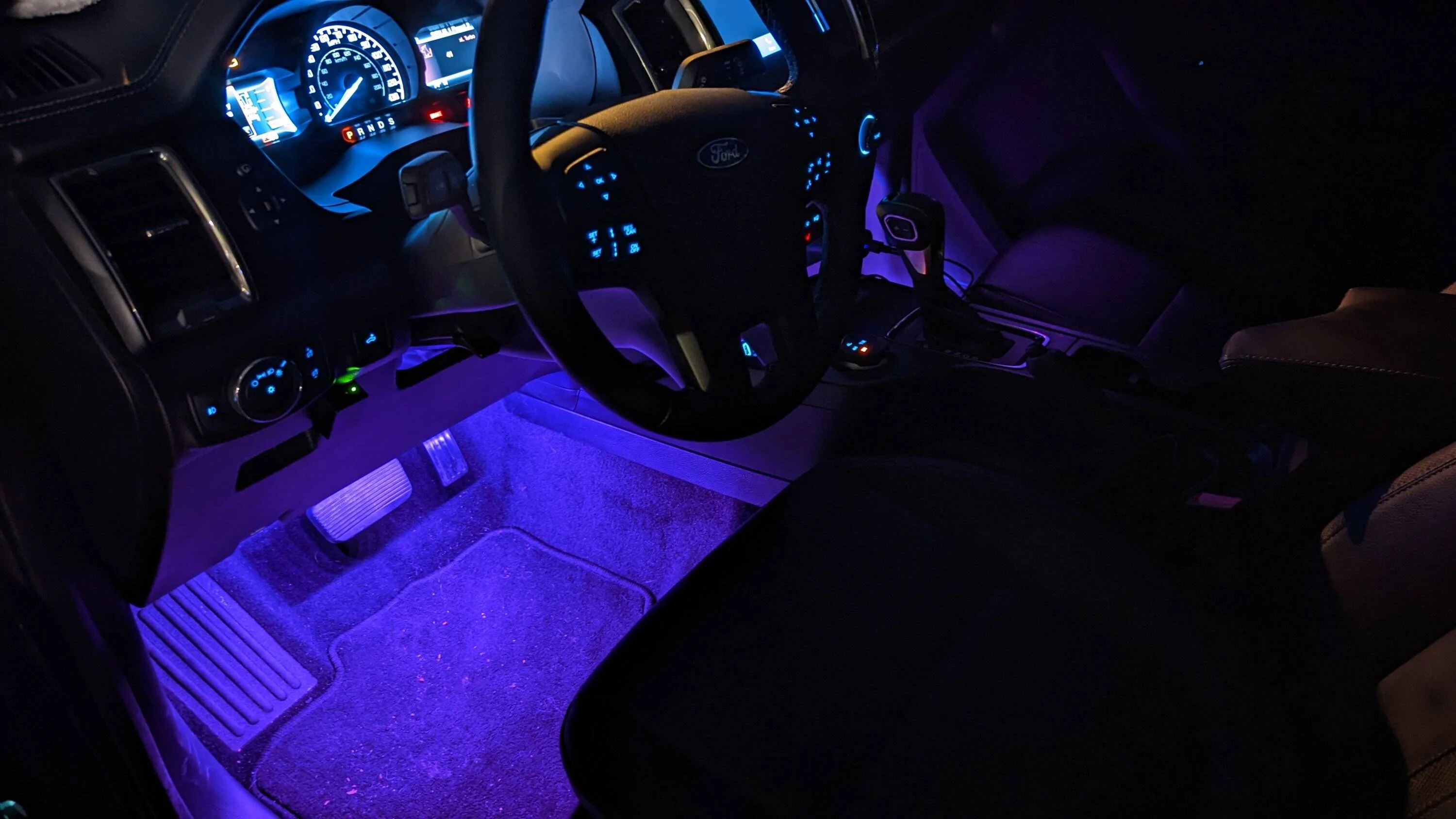

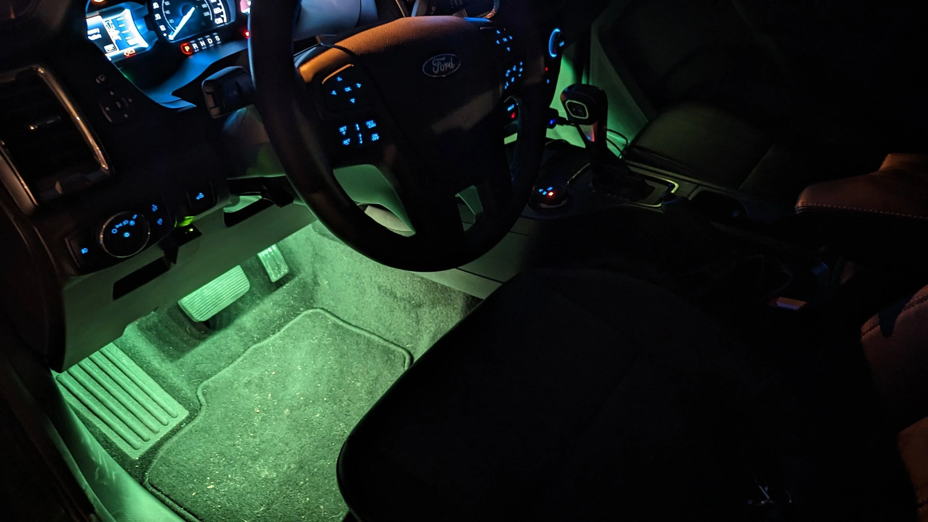

The requisite night shots
Looks great, not as distracting as it might seem. Plus I could lower the brightness if needed.
Wife is now asking for me to try and do that back seats ?
That will require running new lin bus wiring I think, unless Ford was nice and had the intention of having under seat lights and left the harness

Really like that blue in the first picture. I will be waiting for you to get here and do my truck. Front and rear seats, please.
