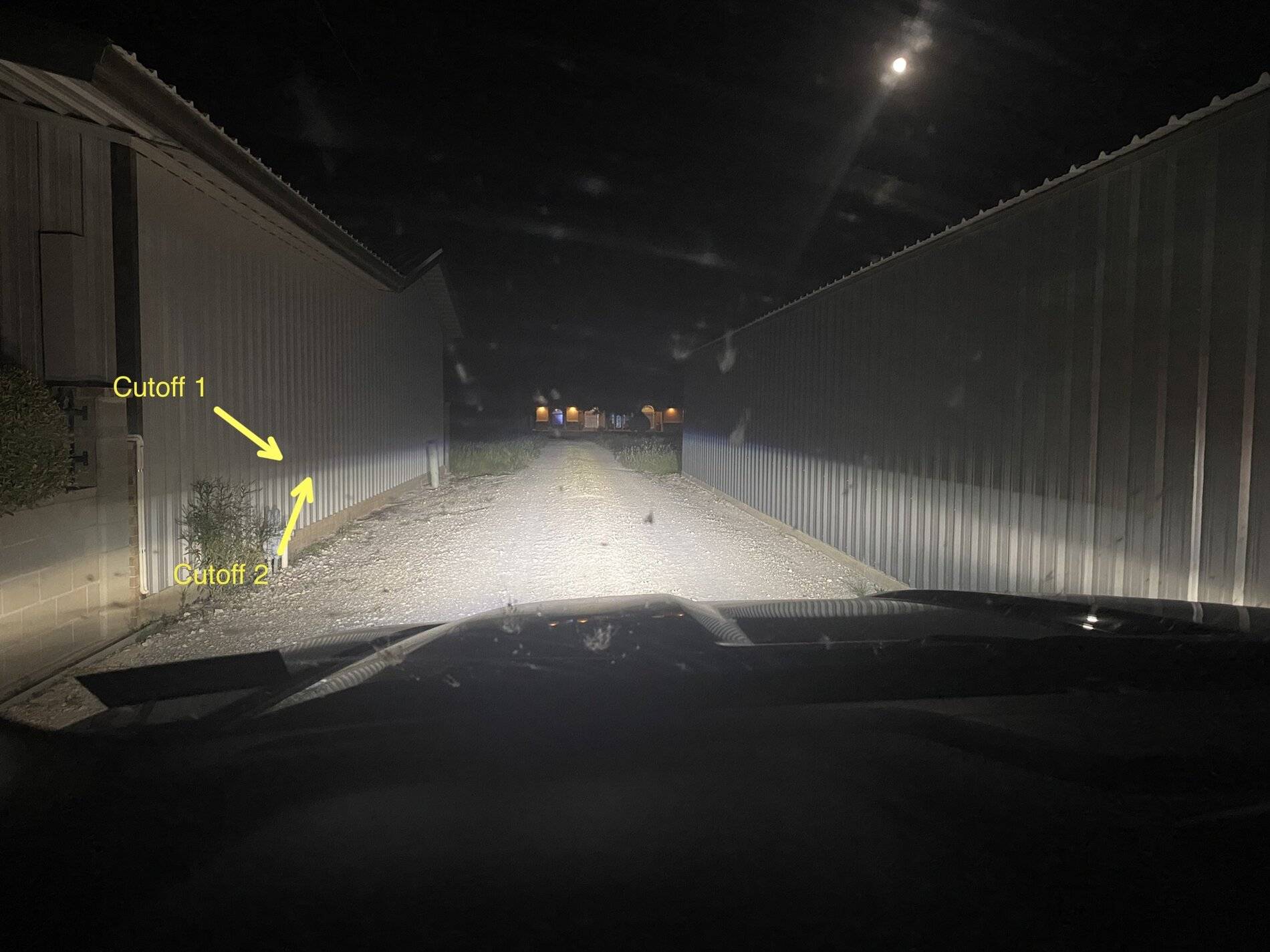

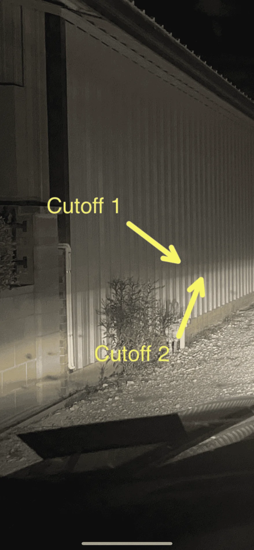

So I guess I had them aimed a bit high. On my 2.5 hour trip home the other night, I got flashed 3 times. So last night I re-aimed them and sure enough they were.
But I noticed last night that my cutoff is not as sharp as it should be. The two low-beam projectors don’t perfectly line up with each other, which makes for two separate cutoff lines from each headlight. Kind of annoying, and something that didn’t happen with my Morimotos back when I had my F150.
For the $1250 I paid, I’m not 100% satisfied because of this and I don’t see a way to adjust each projector independently.
I’d hate to return them because (imo) these are the best looking headlights available. But I’m considering it. With all this flipping headlights around, I’ve gotten pretty quick at getting them swapped out.

that's expected considering the wall's relation to the truck.
if you were facing a wall at 25' you wouldn't see that. you're lights are fine.
one tip is when aiming at 25'. measure the distance from the ground to the top of the bulb (not housing). take that number and subtract 2" and that's the height of the cut off at 25'. Tweak from there.

that’s what I did, and the lights do have the “double cutoff” at 25’. I just didn’t think to snap a picture until I had left my friend’s house where we adjusted them. I’ll try to post a better pic tonight.

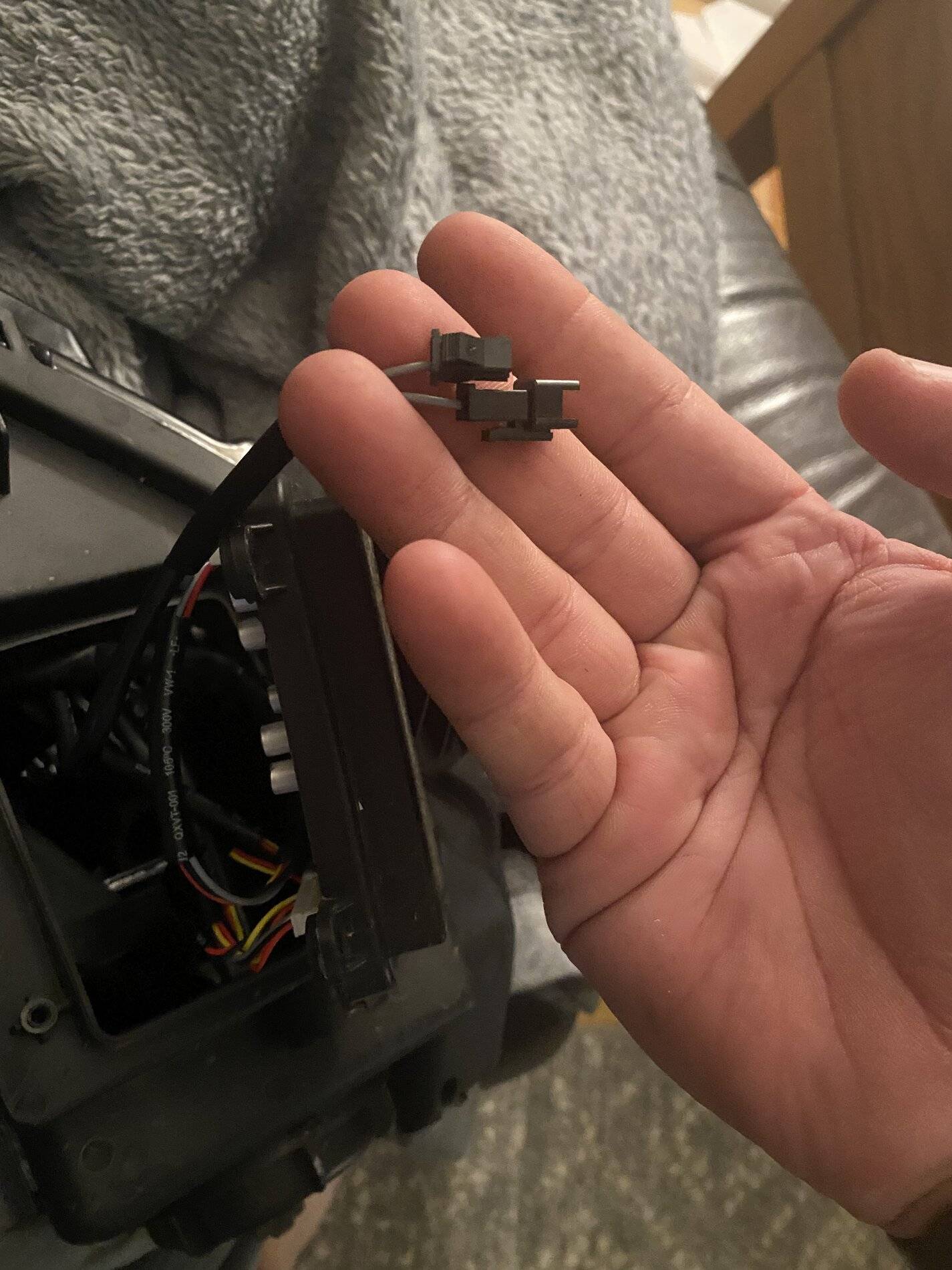

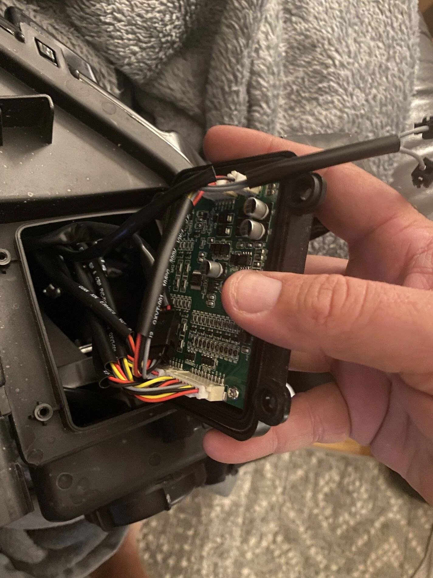

So I opened up my Pros tonight just out of curiosity, and found there’s a connection that’s unplugged. I wonder if it’s like the Morimotos and that simply controls the sequential turn signals, or if that single connection is all that activates the startup sequence. Gonna experiment some with it when I have time, which will probably end in me taking my front end apart again to try to figure it out. I’ll swap the entire board from the Pros to the Novas if I have to lol. Then I guess I’ll have to try to sell the Pros with the Nova startup show.
