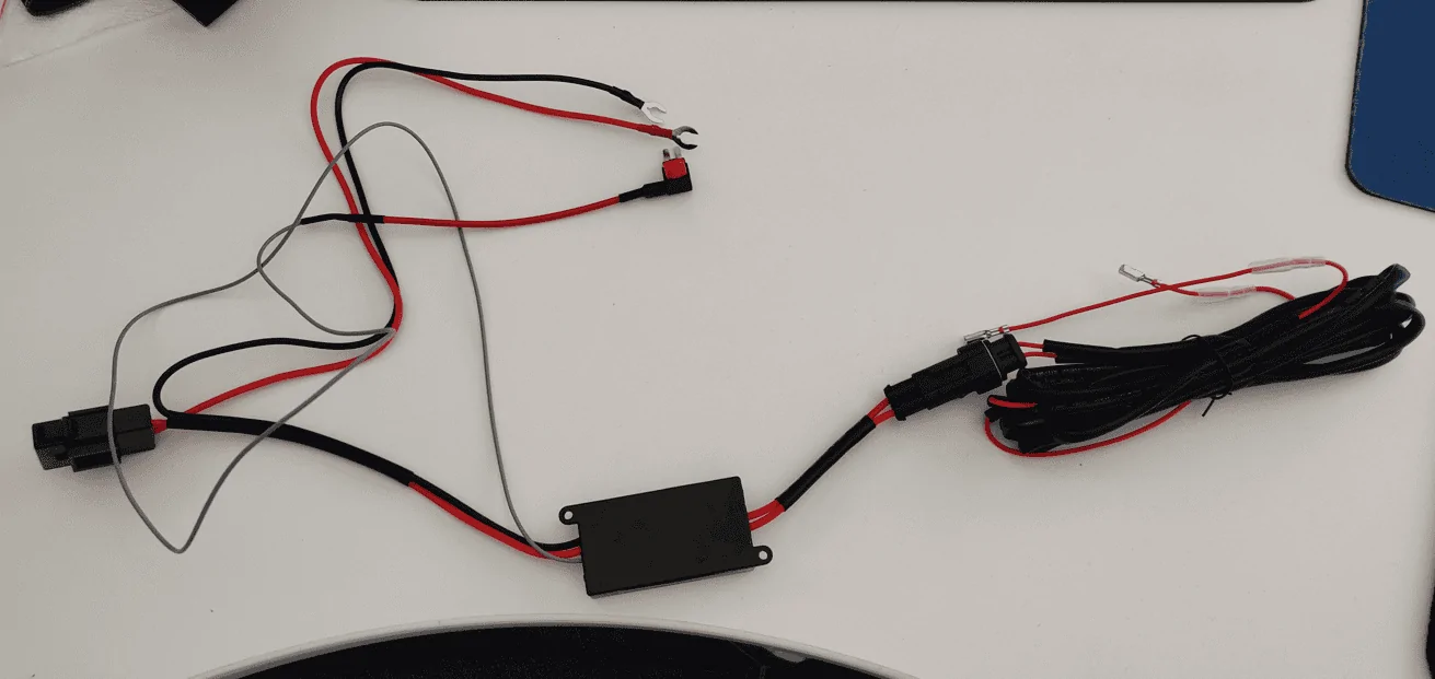

I have dont the install on my truck and i can say that this is the easy part!! All you have to do is use tue harness they give you and go to the power fuse in the fuse box under the hood. Easy to access and easy to do
It looks like from the harness diagram, the gray gets connected to the fuse which you call the power fuse. Which fuse is this? Also, where does the positive and negative wires hook up to?
Positive to battery negative to ground or negative side of battery. Fuse tap goes to fuse 24.
The top black & red are just straight power/ground, wire them to somehow that's appropriate. The fuse-tap will go into the engine-bay fuse compartment #24 (I'm the one who gave Alpharex that fuse number during the initial install wave), I wired mine to a different fuse tap because I didn't want to cut into that waterproof box. The two red wires on the right go to each headlight and plug into that pigtail to trigger the LED strips.
