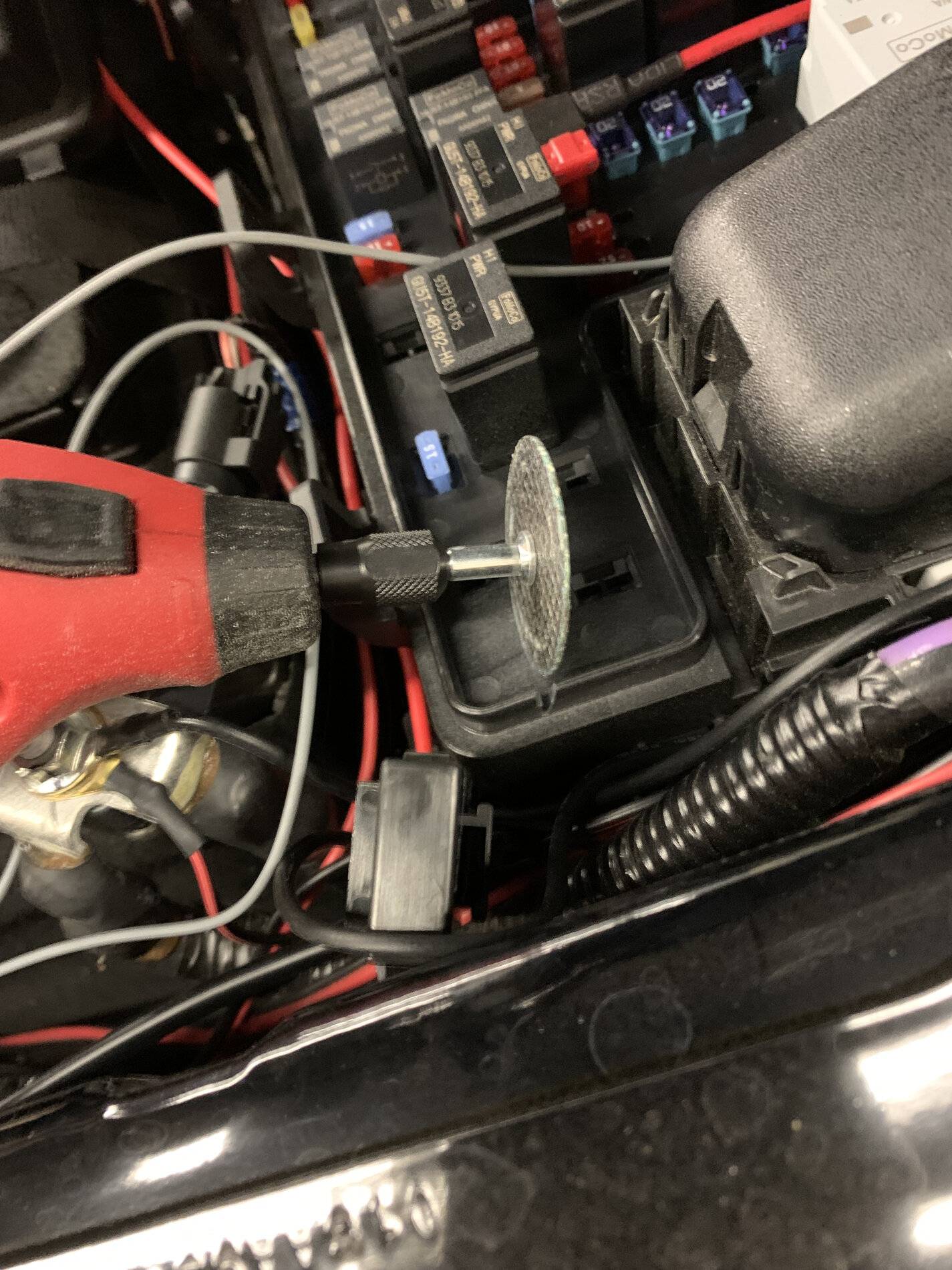

Just got mine installed today and man they are nice. AlphaRex Pro with the Amazon 110w 18.000 Aloux (or whatever) LED headlights. Someone might have mentioned this but when you install your wiring don’t cut the lid itself with the precious seal on it. Make a little slit in the box itself and slip the wire into it and use a little silicone to seal it up.

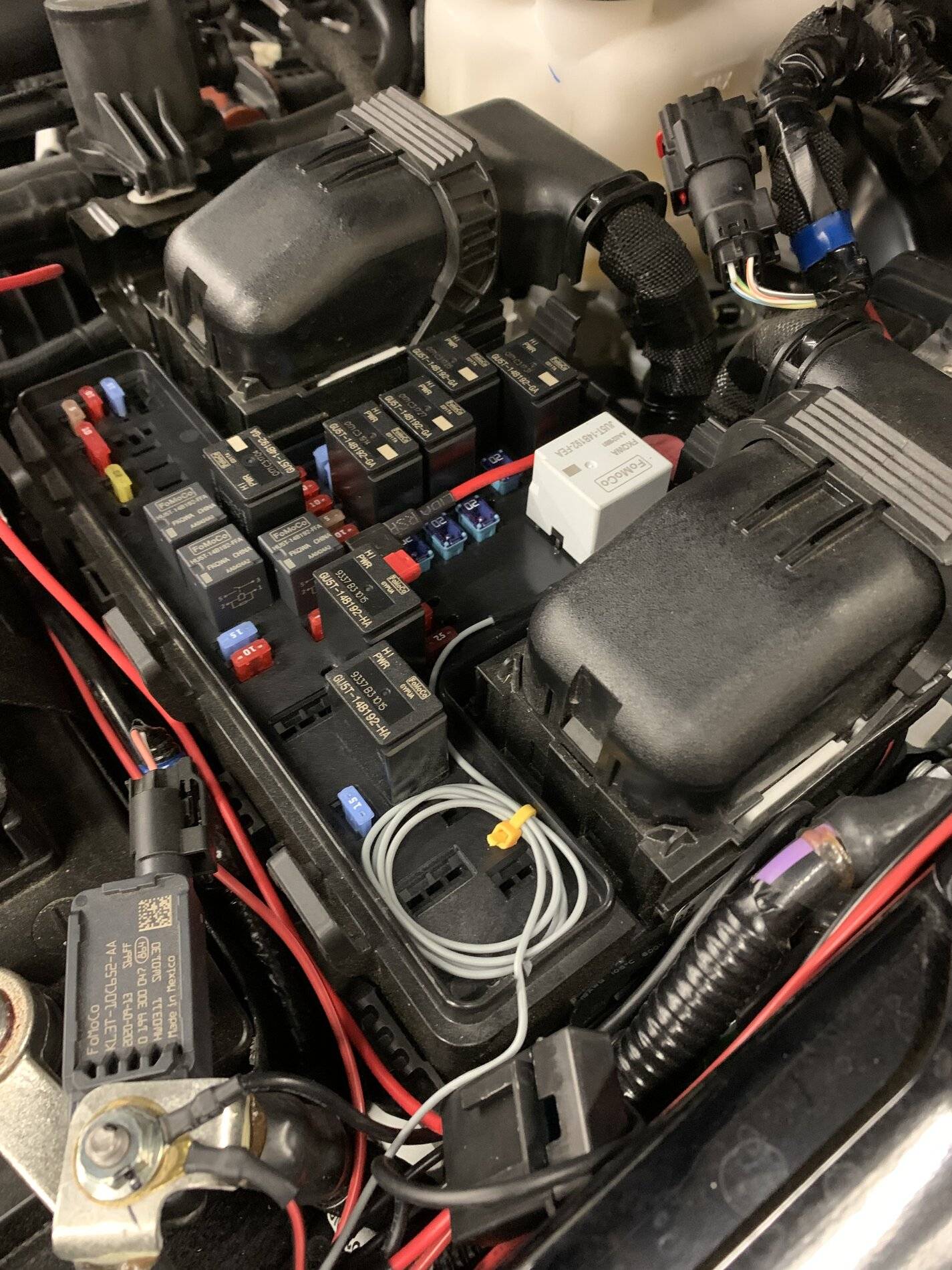

Thanks, this is a lot of help. Can you also take a photo of the fuse plugged in and where or how you attached the red and black wires?

Fuse goes in number 24, red goes to red of battery, black goes to black if battery or to chasis.

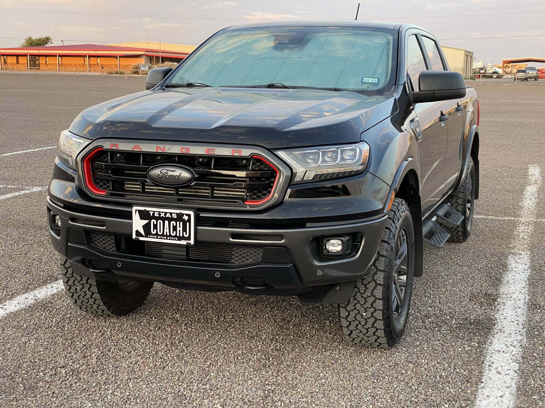

Upgraded from the Pro (had issues with drop in LED reliability) to the Nova last night. I wish I had taken output shots, as these Novas really aren’t much brighter than the Pro with drop in LEDs, which is to say they are plenty bright for sure. I’m just hoping they’re reliable as I had the drop in LEDs shut off after about 10 minutes, just on the driver low beam.
I also really like the “black” finish vs the “Alpha black.” The little bit of chrome shows them off a bit in my opinion, without blending in too much with the black. I like the contrast.
