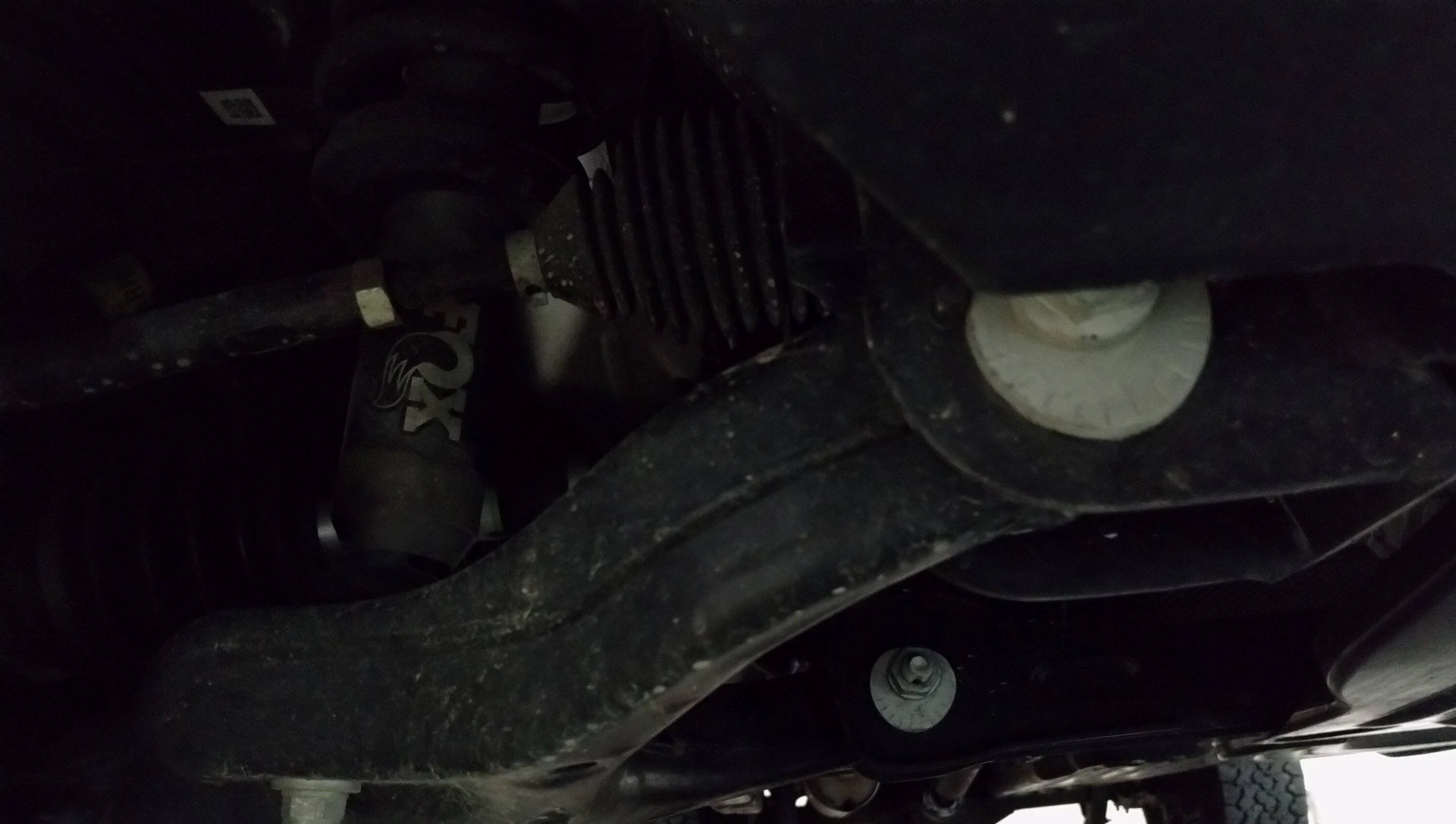

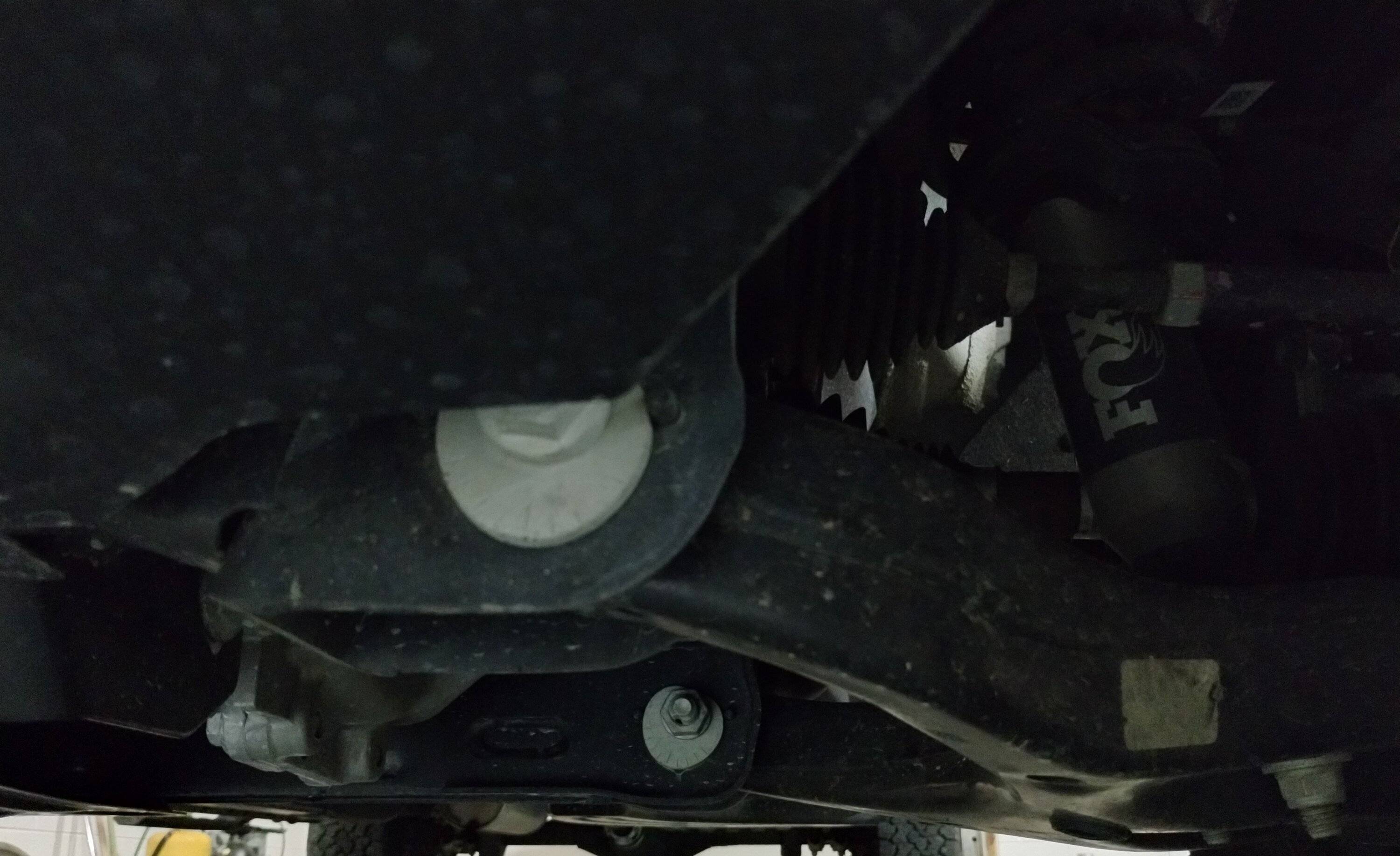

I wouldve expected to see some 'clean' black paint from the LCA if the bolts were moved... but dont see that and thats what caught my eye the first time it went to get aligned. I wish I had marked them with a paint pen before taking it to its first alignment.
Yep, you would have seen discoloration of the silver coating on the bolt heads too if they had put a wrench on it. Sad that out of two shops you have visited, neither treated you fairly.

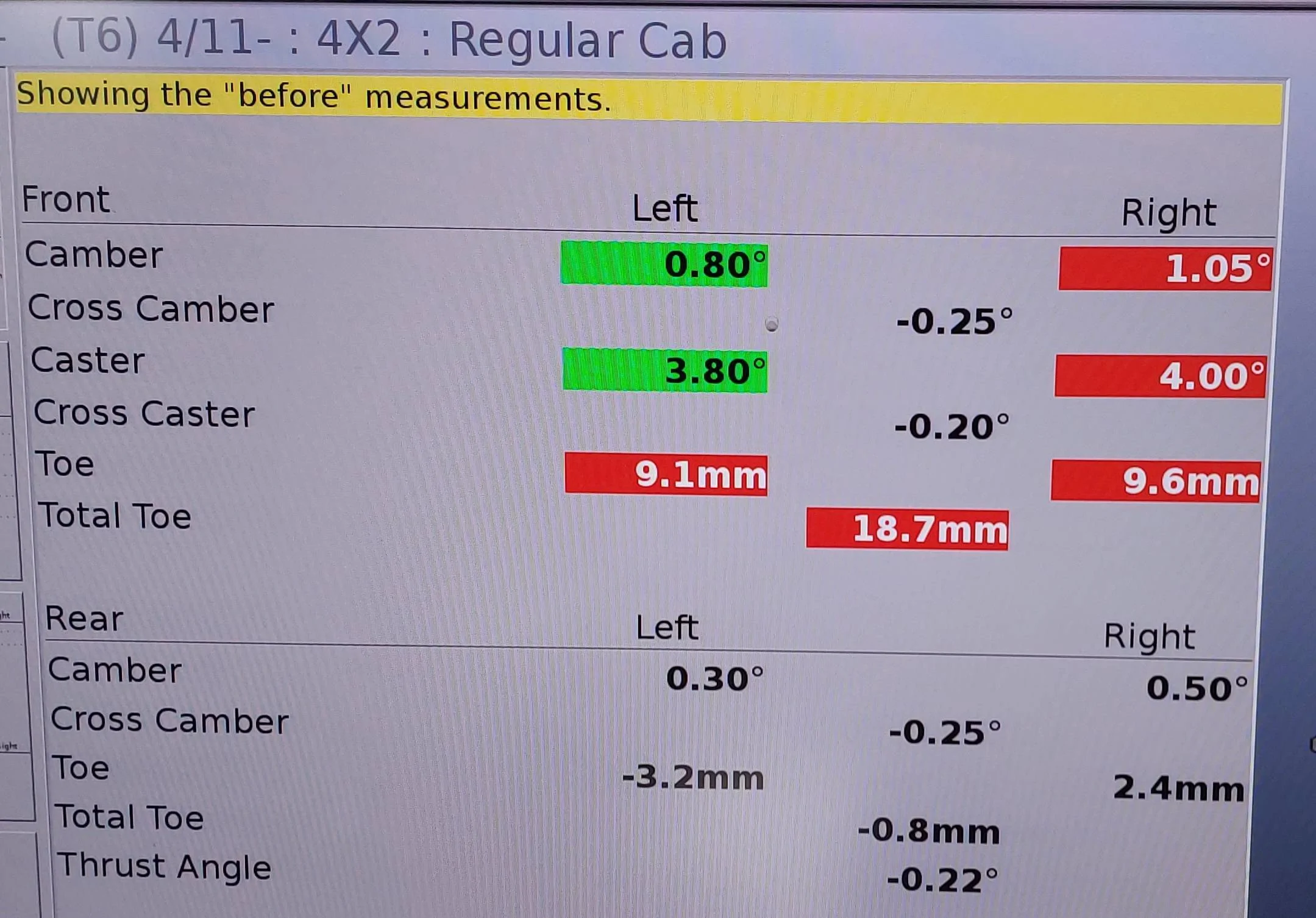

Here are pictures of my Tremor for reference. It's never been aligned since leaving the factory.

Did either shop provide you with a printout of the alignment settings? That would be helpful to share if you have it.
After my 2.5" lift install, I took my truck to an established alignment shop which did not provide a printout, but the truck drove straight with no issues so all seemed well. However, in the following weeks I noticed pretty severe tire wear on the outside of both front tires. I suspected the camber was off due to the lift, and after replacing all four tires I took it to another shop to check the alignment. Sure enough, it was off quite a bit but it was the toe-in not the camber. Since the correction, the truck drives great and the tires are wearing evenly. And I received before-and-after printouts confirming the data.

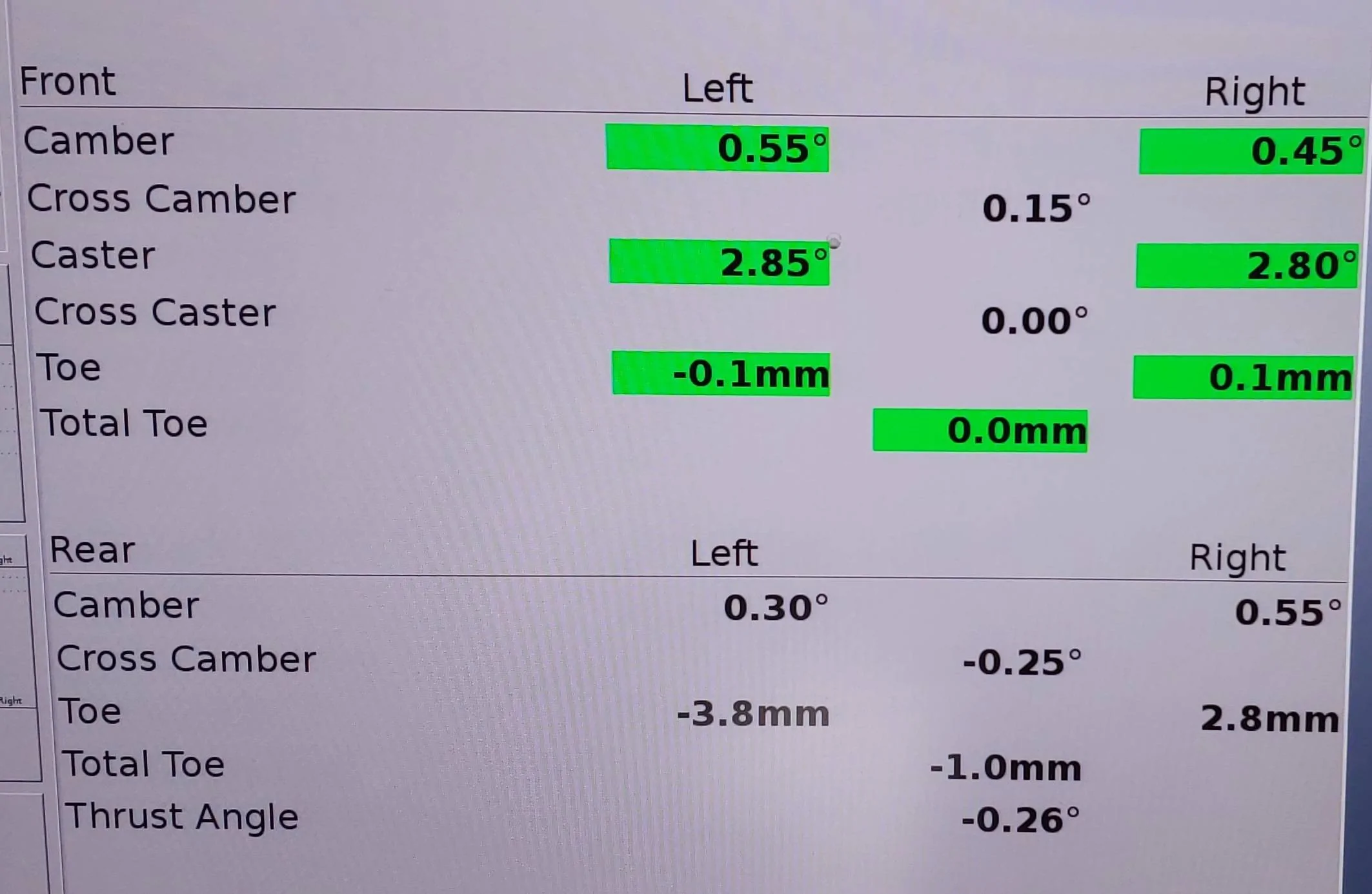

After installing of my leveling blocks attached before and after.

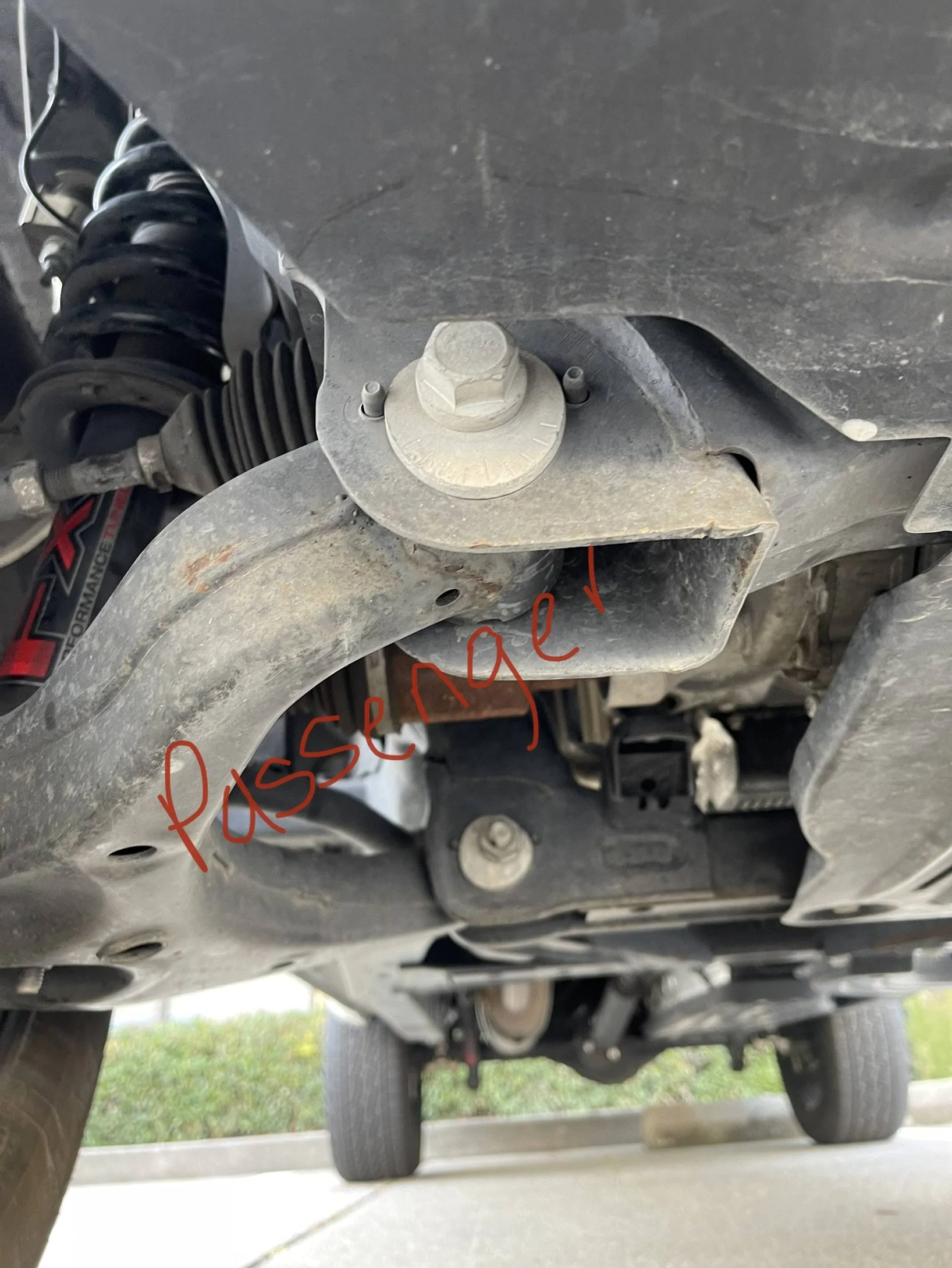

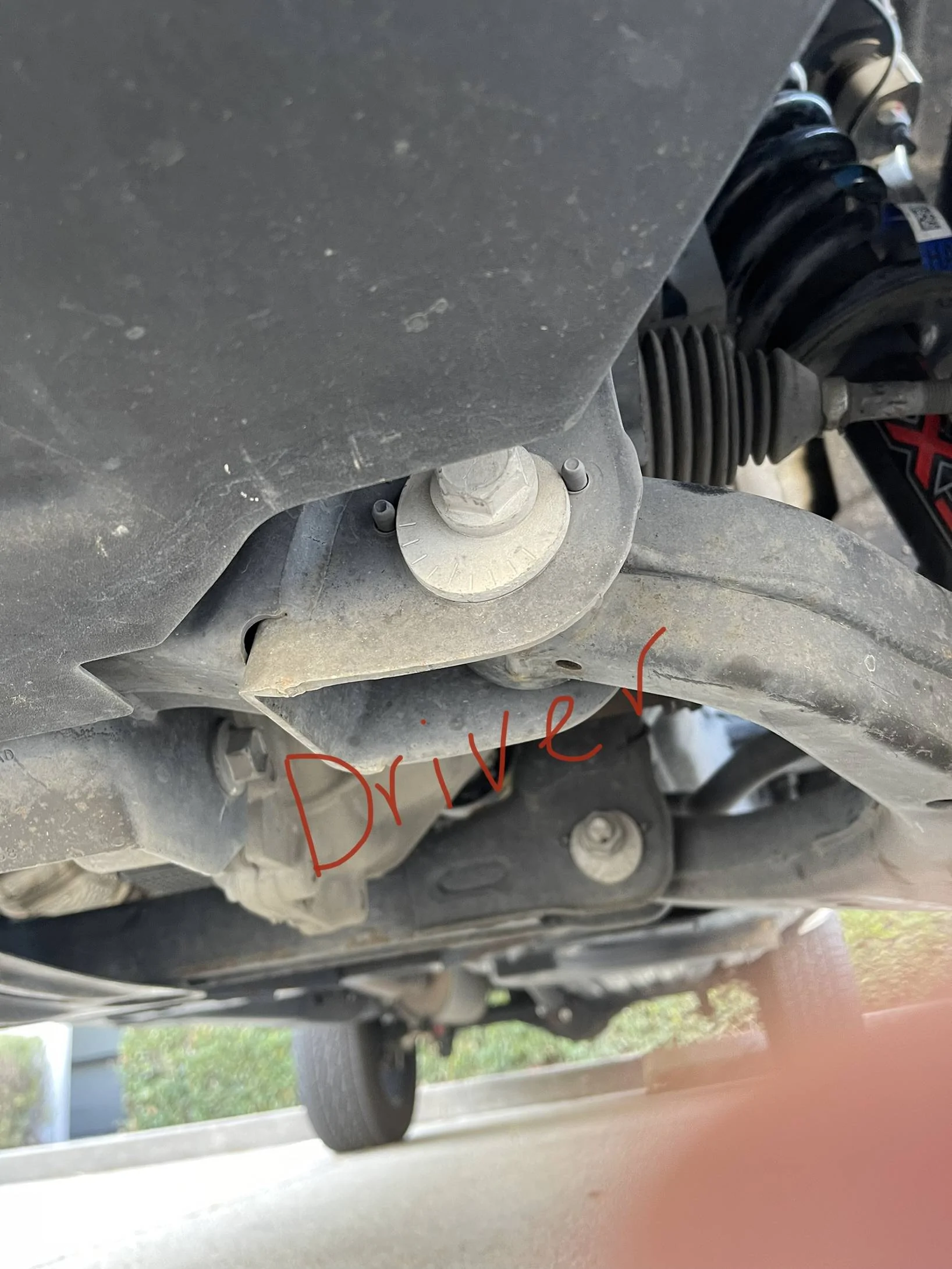

I ended up taking it to another shop. The tech there said that the bolts are maxed out and the only way to get the camber/caster back into spec is by buying a camber kit. Quoted me over 500$ for parts/labor. So now I have some questions:
1. Do the factory camber bolts not have much play to adjust alignment back to spec after a level/lift? Or even close to spec?
2. Is is difficult to change out the camber bolts myself?
Below are some pictures of the bolts if that helps.
Those bolts are nowhere near maxed out spec… I did my alignment in my driveway after doing a 2.5inch level and I had to max out the settings

On my first post I added a picture of the printout. The second shop didnt give me a printout because no work was done due to the camber bolts being "maxed out".
Im going to end up trying my luck with the dealership in hopes they get it right.
That looks better than my numbers on caster/camber. Did you get it aligned at a dealership or a specialty shop?
