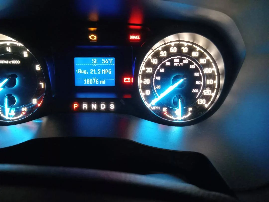

I drove the return trip to what i originally did as posted in my first post the only
difference i could say is there were no slow downs from traffic or construction,
( which i think ultimately led to that high for me MPG # i got ) and i was able to keep the 75+ most of the way, it was about 17* (54*) cooler then the day trip of 71*

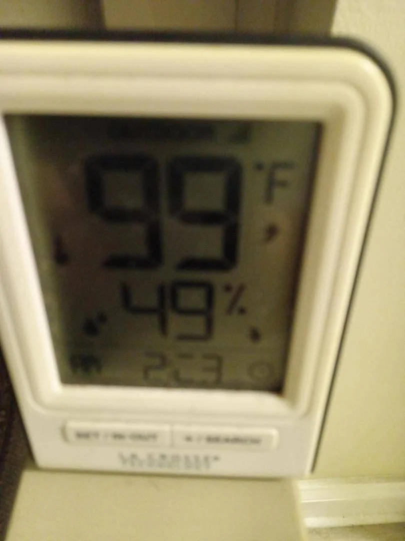

Out of curiosity i placed a temp sensor inside the airbox, and the receiver i had inside the cab sitting in the dash storage pocket, the temp while driving showed exactly what the outside ambient temp from the infotainment display was showing, after i parked at home i brought the receiver in the house and within a half hour the airbox sensor was showing 99*.
I was a believer that the stock plastic airbox would do a good job of resisting heat soak from the engine or even summer temps and stop n go traffic but i can see it doesn't.
So 22.9 VS 21.5 mpg. either one is acceptable considering my driving style., the motor is very negatively sensitive to higher mph's. :shock:
