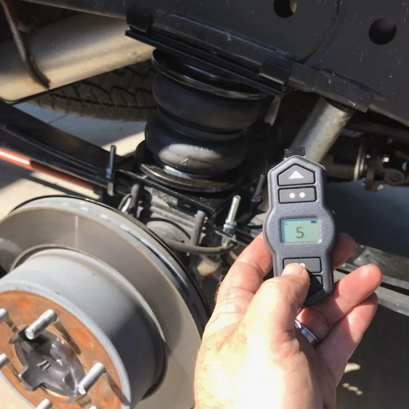

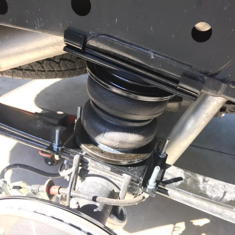

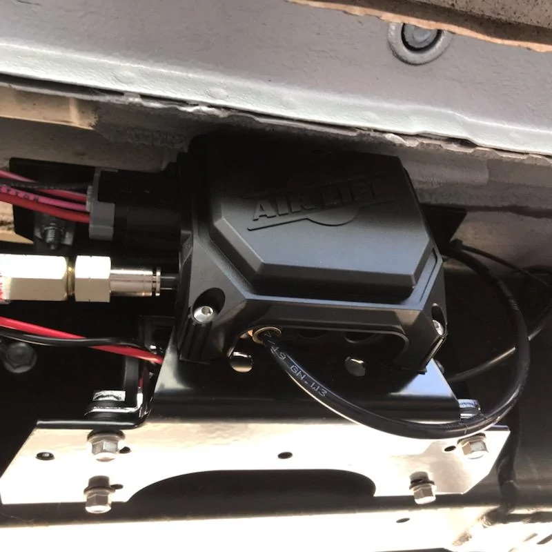

Installed an airlift airbag kit on the rear of the Ranger today... The back had saggy bottom blues with the Tent, Rack and dual swing out bumper... The truck now sits level at 18PSI and rides great!

How would you describe the ride quality of the rear of the truck before and after?
Out of the box the truck was pretty stiff... with the weight and the icon shocks in the stage 1 kit it rode soft but man did the big bumps hurt... This has really helped bridge that gap and changed the ride compression in the rear.. Not nearly as rough.. its a great solution.
