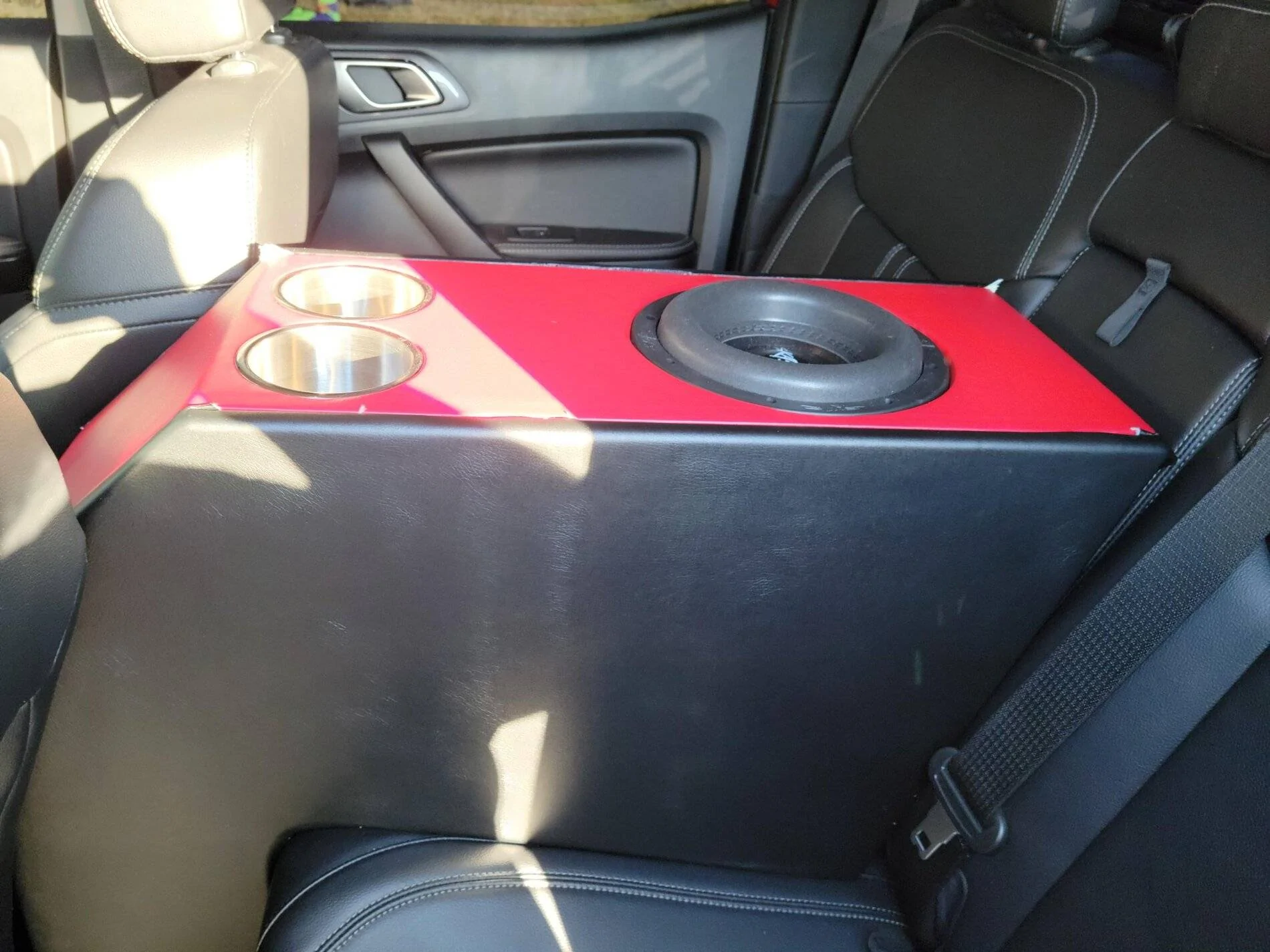

Id like a few more pics of your rear center console. I have been thinking about making something similar in my super cab.
This is the only other picture I have of it. This was before the trim came in so it's a little rough looking still here.
I've already taken the box out and am experimenting with different enclosures and port tuning.

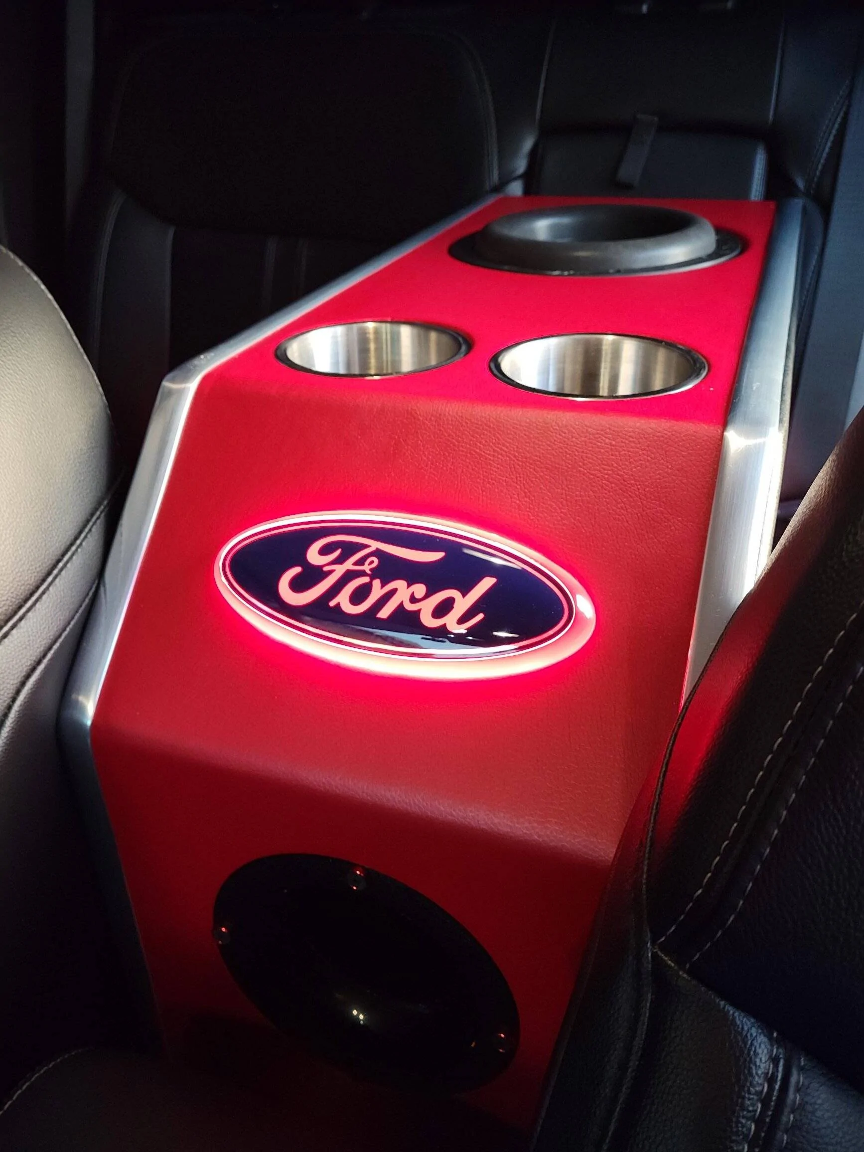

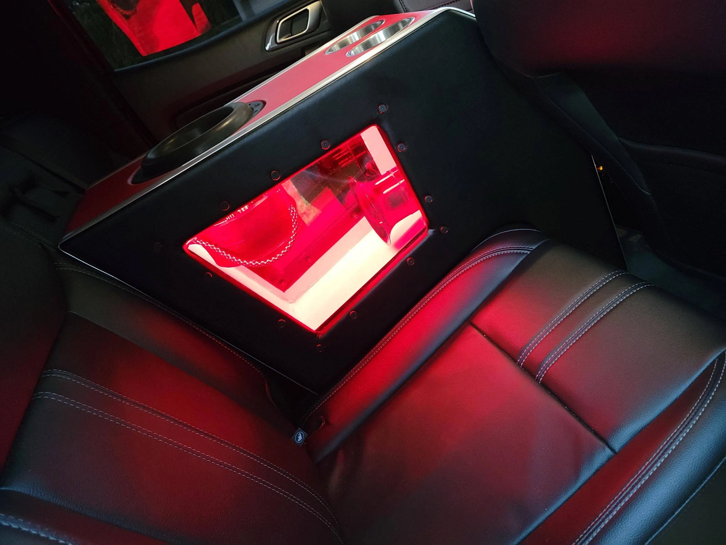

First I want to say thank you to everyone for input regarding hooking into the factory B&O system.
Secondly this build will not be everyone's taste, that's fine, but I built what I wanted and wanted to share, Im big into home audio and car audio.
I have a 2021 lariat. Im using the Zen Audio A2B processor connected to a prv DSP. Then I have 6 PRV 8" midrange on a prv 3500watt Amp. Then a skar skv2 200.4 running 4 titanium tweeters on channel 1&2 @ about 800rms, and a skar audio 8" ZVX8 on channels 3&4, also about 800rms. The center console is getting redone as im not happy with the output but for now this is what ive got
