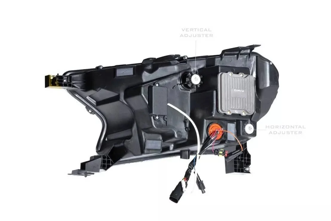

One other thing that is the Morimotos and the OLMs use the headlights for the startup sequence. Most other aftermarket lights, that I've seen, only use the DRL/turn for the sequence.

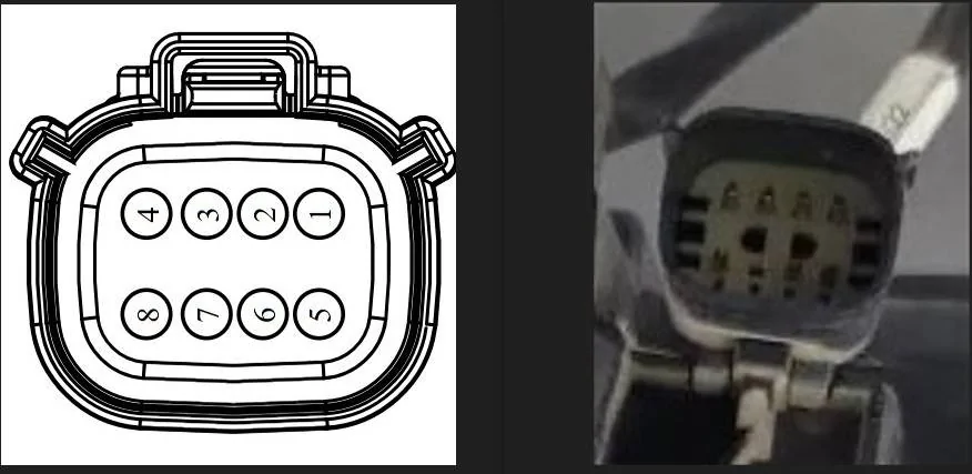

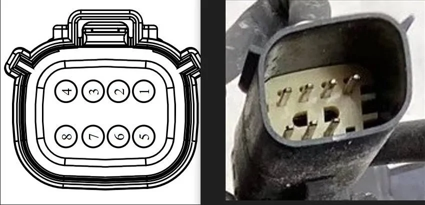

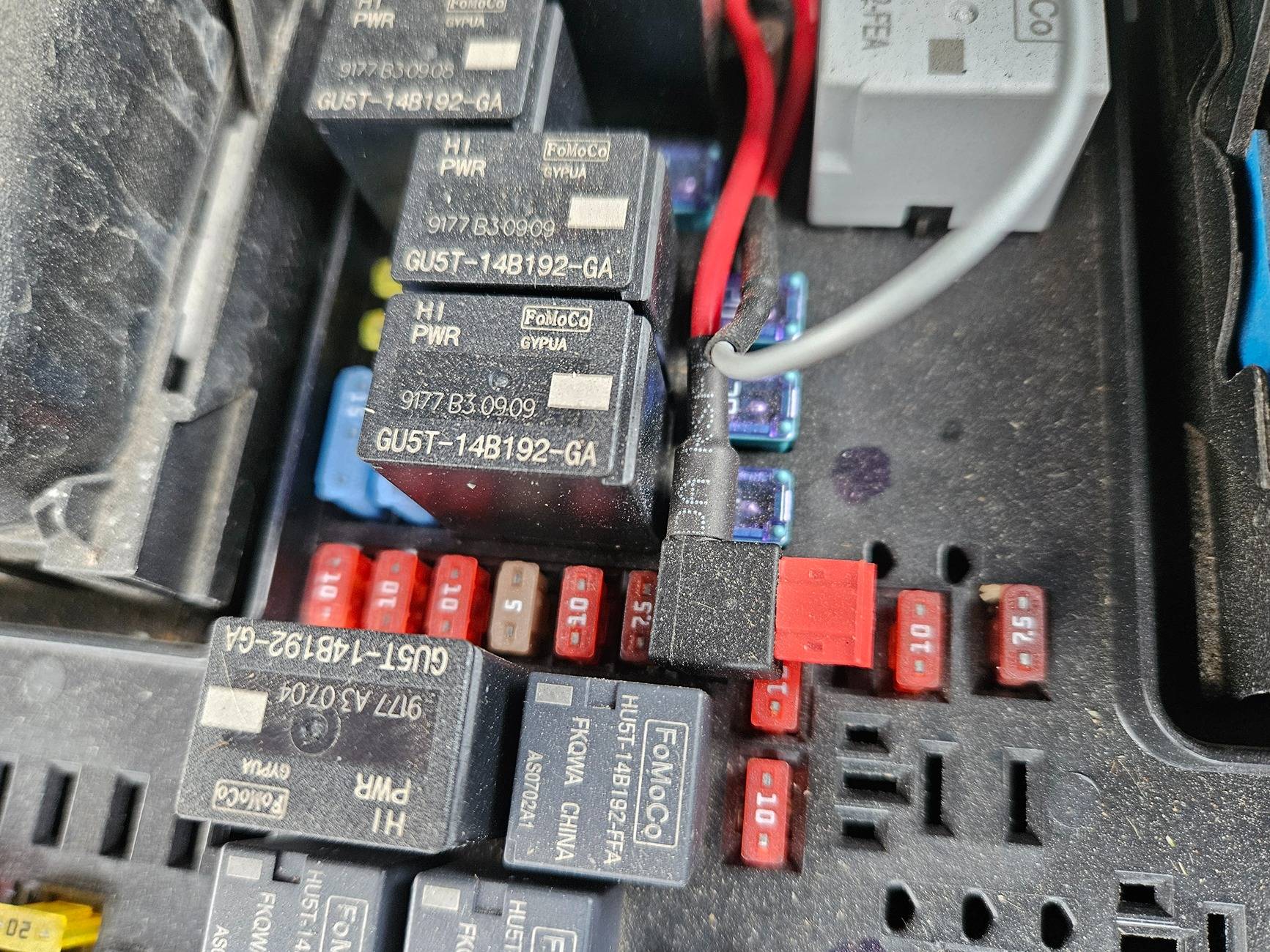

I know we had previously discussed moving the (tap) to the park light circuit and this being an issue. But I think that would (stop) the DRL's from being always on, if I am correct (the headlights) are actually using the (Trucks) Park Light Power (To Dim or Turn Off) the DRL Circuit, when the park lights are commanded (On) by the BCM, yes, they are internally bussed together, but if we look at this the same way the (Headlights - BCM) are dominate over the Start-Up sequence, the same applies to the (DRL & Park) lights - if the Park Lights are commanded (On) the DRL Power is dropped and that light (LED Bar) dims as now it's being powered by the BCM.
For the Factory LED assembly - This is the same for the (DRL & Park) Light Bar, when Park light is powered (Pin 5) and power is dropped on (Pin 6) and when DRL is Powered (Pin 6) and power is dropped on (Pin 5)

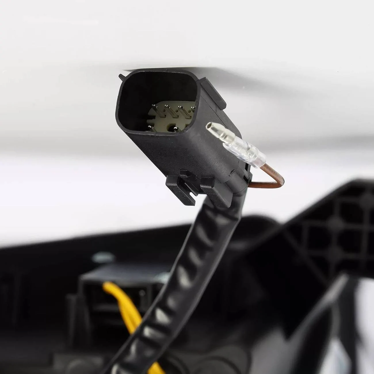

Reading the Morimoto site, they state it's the DRL signal that triggers their sequence, not parking lights. I don't see any valid reason, other than lazy development or rushed trying to be first on market, that you would use a switched power source for DRLs when the truck already signals that (non-LED uses low-voltage [maybe high beam] headlight without parking lights on as DRL signal) in a way that a very basic logic board could monitor for and react appropriately.

My OLM/Morimotos work perfectly with one minor exception. The startup sequence work as expected all the time, except when it is dark out and the switch is in auto. Then I only get the sequence on the driver side light and not on the passenger side light. It appears to be a timing issue between the way Ford powers the lights on 2 separate circuits, one for each side of the truck. Once the sequence starts it runs to completion. If the headlight is on the sequence is blocked. The wow factor of the sequence means little to this 73 YO, I'm much more interested in the better cutoff and better lighting. So, the missing sequence is other people's problem.
As far as using the factory DRL signal to trigger the startup sequence. There are two issues with that. First, between the LED and Halogen headlights there are two different DRL signals. The LED headlights use a wire in the factory plug. The Halogen headlights use a reduced voltage to the LOW beam bulbs. This would require use of Forscan to correct this. So much for plug and play. Second with the factory DRLs they only work with the switch on Auto. So for those that do not use Auto, they would never get the startup sequence or DRLs. So given the convoluted way Ford controlled it's DRLs and the differences between the US and Canada re the regulations, it was better to take control of the DRLs and use a switched power lead.

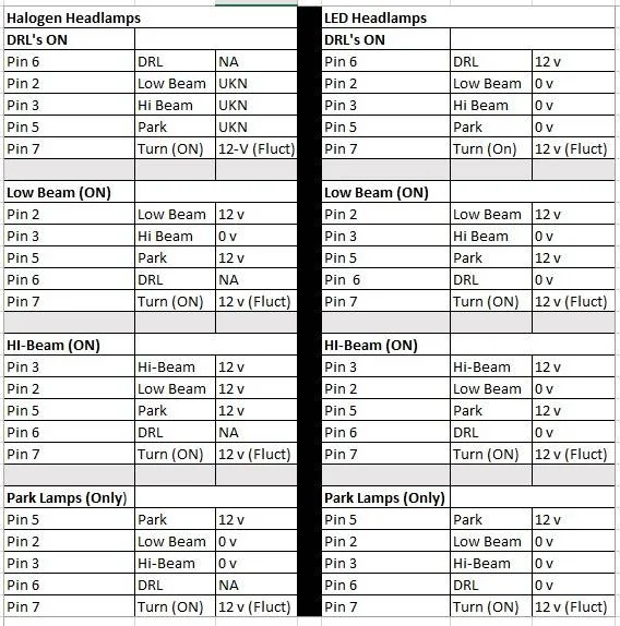

At one time before I fully understood the system and more so now that we have figured out the (Start-Up) sequence issue. I was under the impression that (ALL) LED headlamp assemblies required Forscan changes for them to function correctly, this (Impression) was I believe not entirely correct.
I based my findings on - Factory Halogen vs Factory LED (and the As-Built data) they are different due to power requirements and the (DRL = Pin #6) issue.
So, from I can tell as of now stating that (YES) if swapping in factory LED's - Forscan is required for proper operation.
Aftermarkets, where I was hung up in thinking they required the same was all the power issues that are reported - mostly the (Start-Up) sequence, which I was correct in my theory of it being a dual power issue, only instead of it being the BCM triggering the issue its the (After Market Headlight) itself that is triggering the issue, not by a fault but from a safety aspect.
With the Headlights given priority over an animated sequence
As Big Blue pointed out - the trucks lighting although powered via the BCM still has 2 separate fuses powering the Left and Right-hand lights then you have the tapped power source for the DRL's attempting to power-up and start the (Start-Up Animation) - bottom line is multiple avenues for some kind of a delay in power reaching the lights and then the lights reaction to abort or allow the start-up sequence
