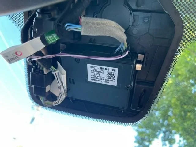

Lastly my missing wires. Temp solution, Canbus Low/High from the IMPA (at the mirror) to the connector which takes them to pins 2/3 @ C903 in the A pillar.

That's the number that was on the harness. I'm researching to see if Ford lists a different number.
I was unable to find a longer part number for the correct mirror/IPMA harness using the Ford parts online sites.
I reached out to Tasca, hopefully they will come through for me.

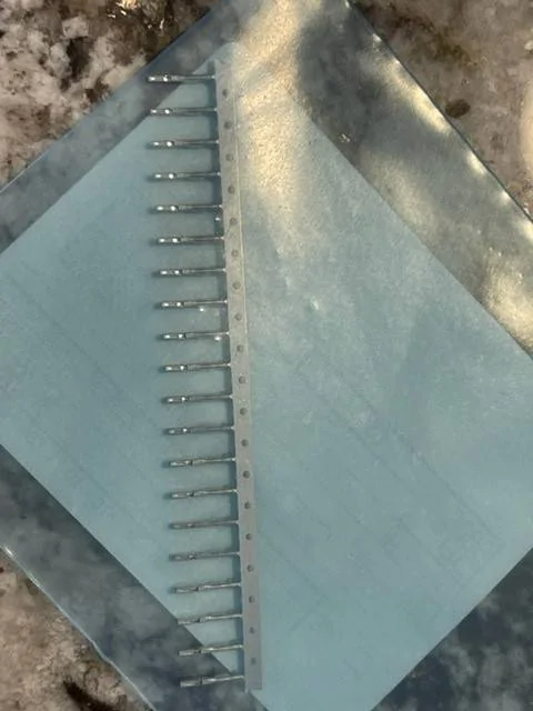

Got my pins today. Thank you micl9 for finding them. They certainly look the size. I will solder up a twisted jumper after work. This may be easier than ordering and replacing the cable.

I'm sure you could sell the rest 2 at a time to others that wanted them,
daczone
Dec 22, 2020
34
404
645
2020 Ranger
Could solder up some additional jumper wires, and grab some Radar unit plugs and have a kit. I certainly would have paid for one.
